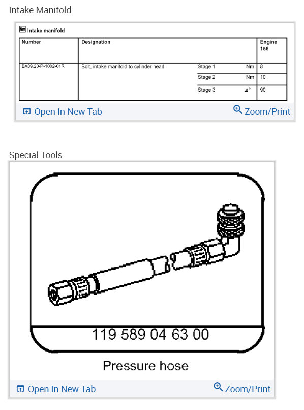

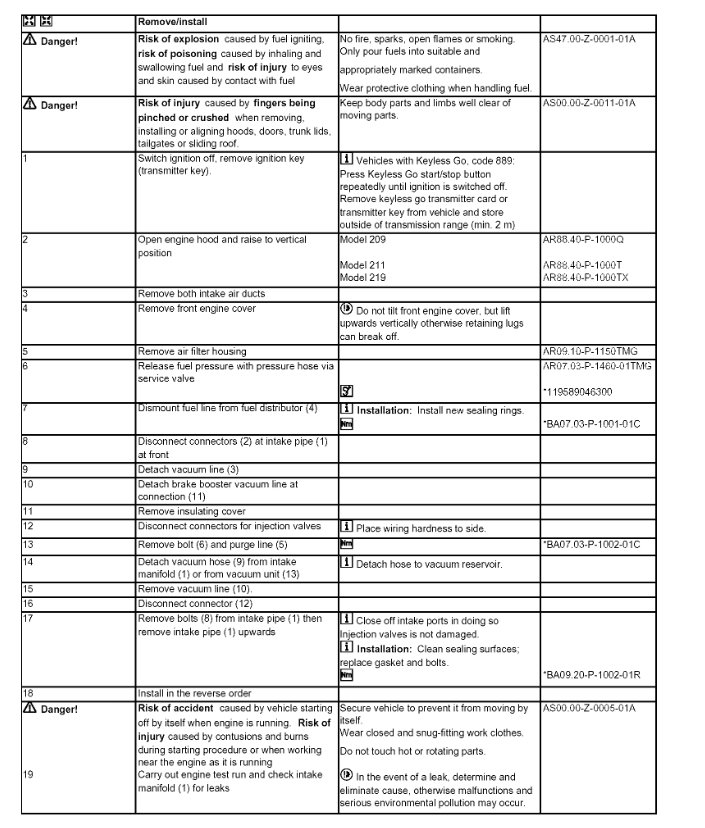

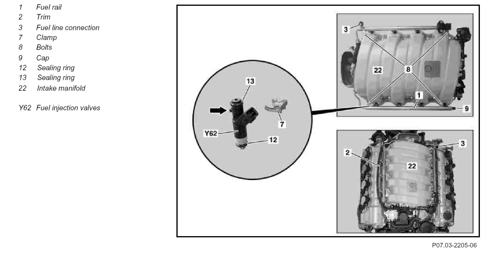

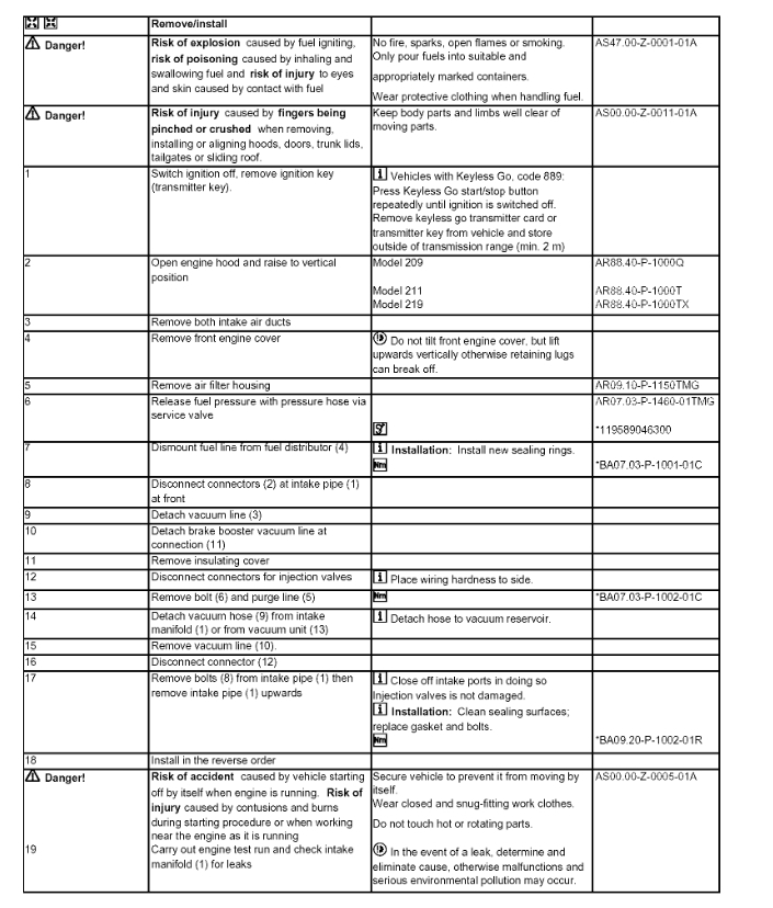

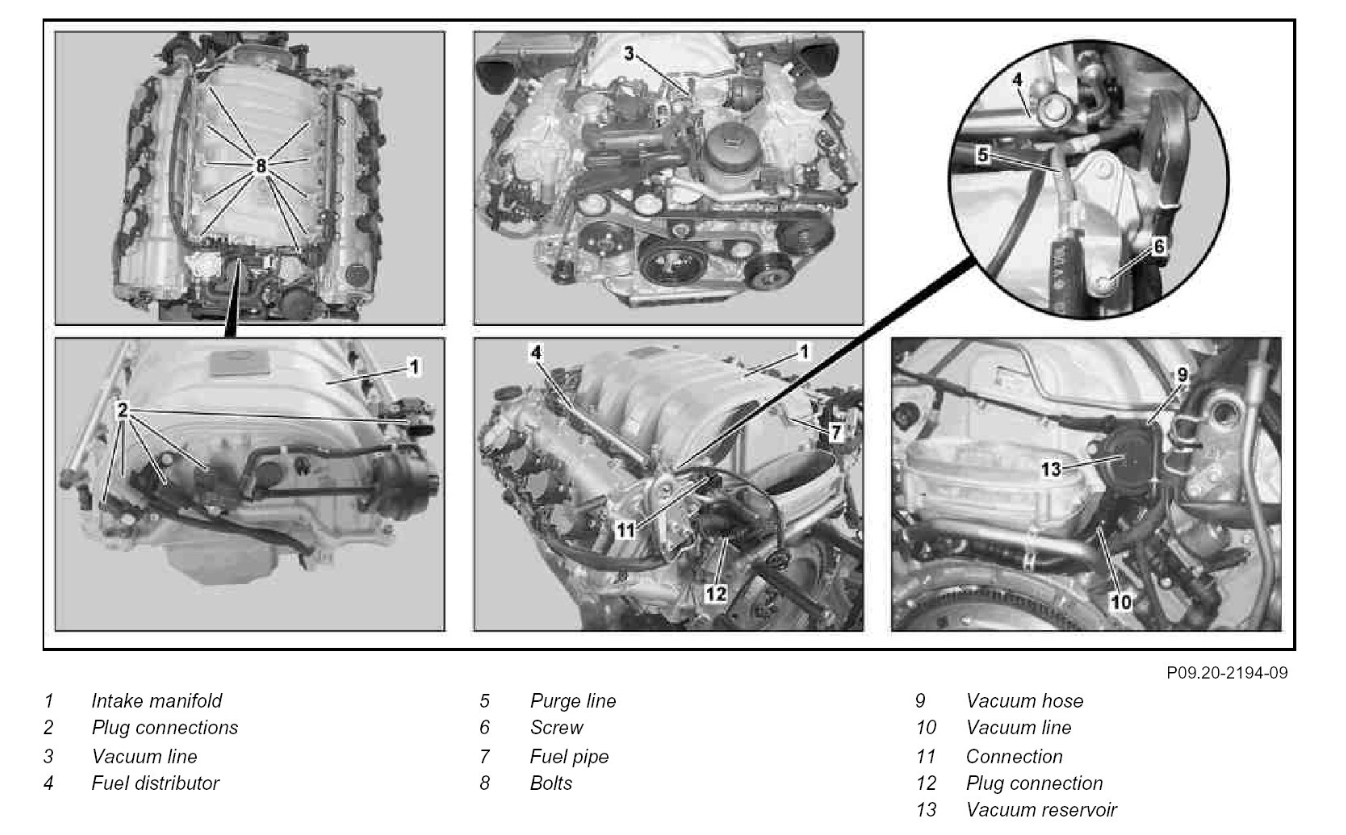

O man, that's a good one. Can you please shoot a quick video with your phone so we can see what's going on? that would be great. You can upload it here with your response. It sounds like an injector shorted open and filled the engine with fuel. You will need to change the oil and remove all injectors to find out which one is bad. Here is a guide to help with diagrams below to help you change out the intake and injectors:
https://www.2carpros.com/articles/how-to-test-a-fuel-injector
