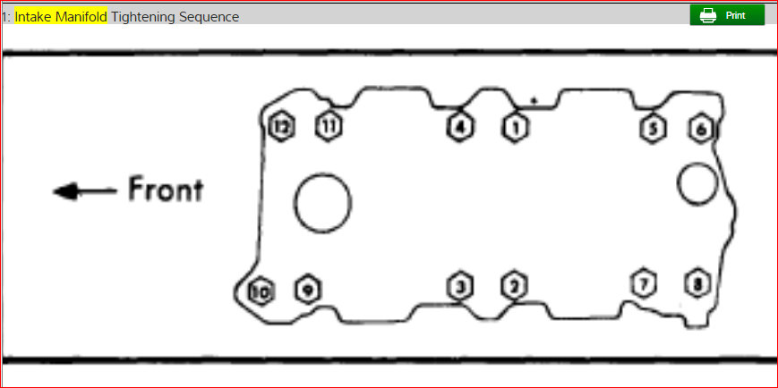

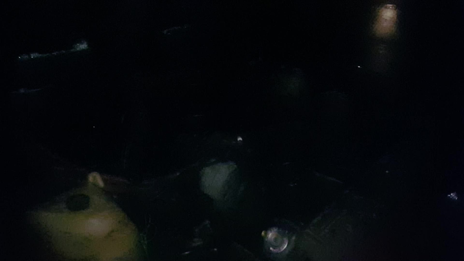

So not too long ago my dad got this car it was the turbo 3.8 whoever had it swapped it with either a 305 or a 350 but I have no idea which one it is. But the problem is that the intake is leaking coolant and the gasket obviously needs to be replaced. The only things I could find on the intake were 373598 GM 2E and the firing order is 18436572 I look it up and get many different types of gaskets and I also do not know the procedure in loosening and tightening the bolts since I know there are intakes that require to be loosened or tightened in a specific order.
Thanks any help is appreciated.

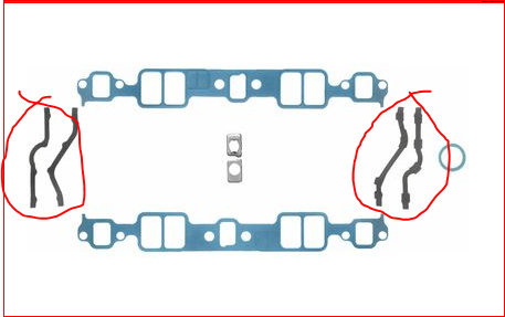

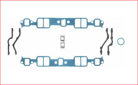

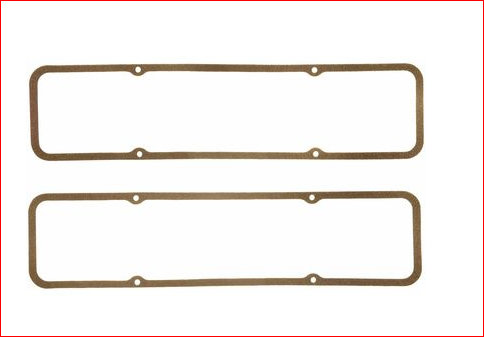

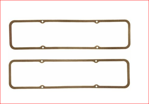

The small block Chevrolet v-8 in your car can interchange most the gaskets and accessories because of being produced for so many years without change. I believe the gaskets can be used from 1964-1987 when GM switched to center bolt valve covers. The 283,305,327,350, and 400 cubic inch v-8's are all the same. I've attached a few pictures of what they look like. I've also attached a picture of the tightening sequence you wanted.All intake manifold bolts are to be torqued to 30 ft lbs. I've attached a tutorial showing what is involved.
https://www.2carpros.com/articles/replace-intake-manifold-gasket
As far as using oven cleaner I think that might work. I would use gasoline and a wire brush or a heavy duty cleaner.Just be sure that all surfaces are clean and old gasket free to helps prevent leaks when installing.As a side note, On the picture of the intake manifold gaskets I circled the end seals in red.I never use those.I personally use RTV instead.Those rubber ones tend to leak so I just use Permatex brand Ultra Copper silicone RTV. Hope this helps and feel free to ask any questions.Thanks again for using 2CarPros.
