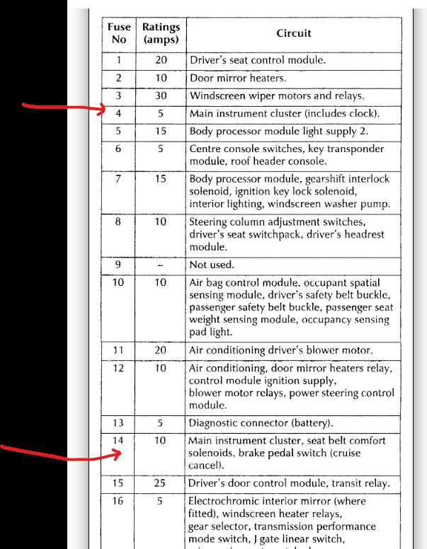

After changing lighting in instrument panel to LED the gauges are not working. Which is the fuse for the instrument panel and if okay what do I need to do?
Mar 14, 2023 at 7:46 PM
  • 55,433 POSTS

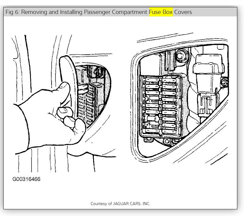

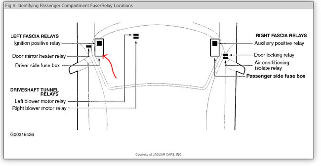

You might have to change the bulbs back due to the amperage difference between the LED and the normal filament bulbs. But first let's check the fuse #14 and #4 in the fuse panel on the driver's side. Here is a guide to help you test the fuse and see if they have power, I would also recheck the electrical connector at the rear of the panel.
Here are the fuse locations in the images below. Please let us know what happens.
