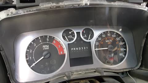

When starting, the instrument cluster goes blank while cranking and goes through the startup sequence again after the engine has started. Along with the associated chimes during its start sequence.
Please point me towards troubleshooting this.

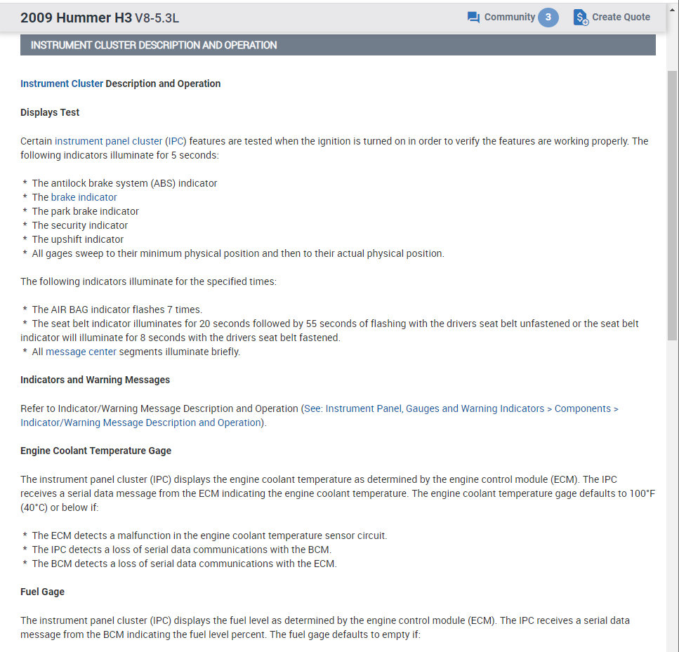

Basically we are needing find out if this is different and what happened to cause the change? The cluster is responsible for running its own diag tests and initialization processes so if this is a new cluster and it was not doing it before then I suspect the cluster is the issue.
If this is a new cluster and it was doing this before then the only thing that would make sense is there is an issue with the BCM or one of the inputs from the BCM to the cluster.
The cluster does this sweep and chimes as a normal process to make sure it can communicate with everything it needs too.

This is the original cluster that came with the vehicle.
Honestly I don't remember if it did this before. Got this H3 as a project vehicle. The shroud covering the cluster was out to disconnect wires I had running out of it to power the Side Mirror turn signals. That didn't help. They were initially connected to the harness going to the cluster per the instructions that came with this product:
https://www.hummerpartsclub.com/p/HPC_2200249H.html
Did have starting issues initially, after replacing the battery which didn't help, replacing the battery terminals solved that issue.
The next that might interfere is the aftermarket Android stereo I've fitted along with a module to reproduce the warning sounds/chimes. Have yet to disconnect the stereo.
As of this video, all the 'mods' I've done electrically were disconnected.

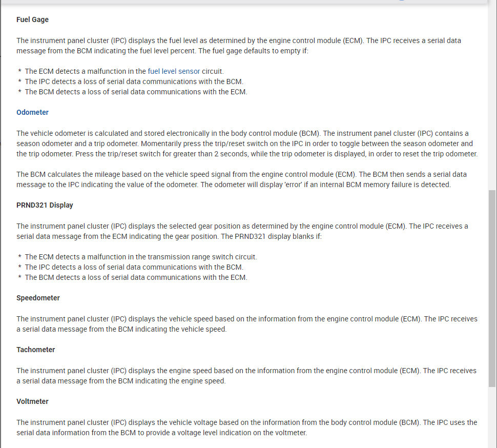

Sorry. I should have asked if there were aftermarket parts as that will cause this type of issue. GM used their own form of a CAN bus and this is like an electrical highway where the modules all communicated with each other.
Here is a guide that will help with this:
The reason these initialization processes repeat or fail is due to a module that it doesn't recognize or get a bad message from one.
You can try unplugging all the aftermarket components to see if this will correct it but even if it doesn't I suspect it is still an issue along these lines.
