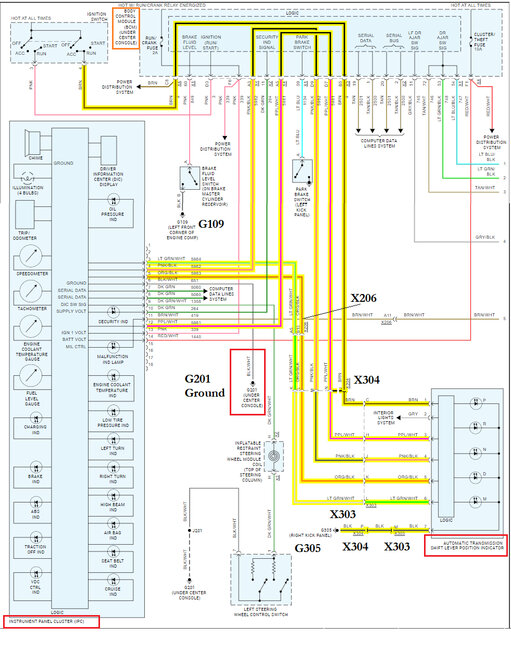

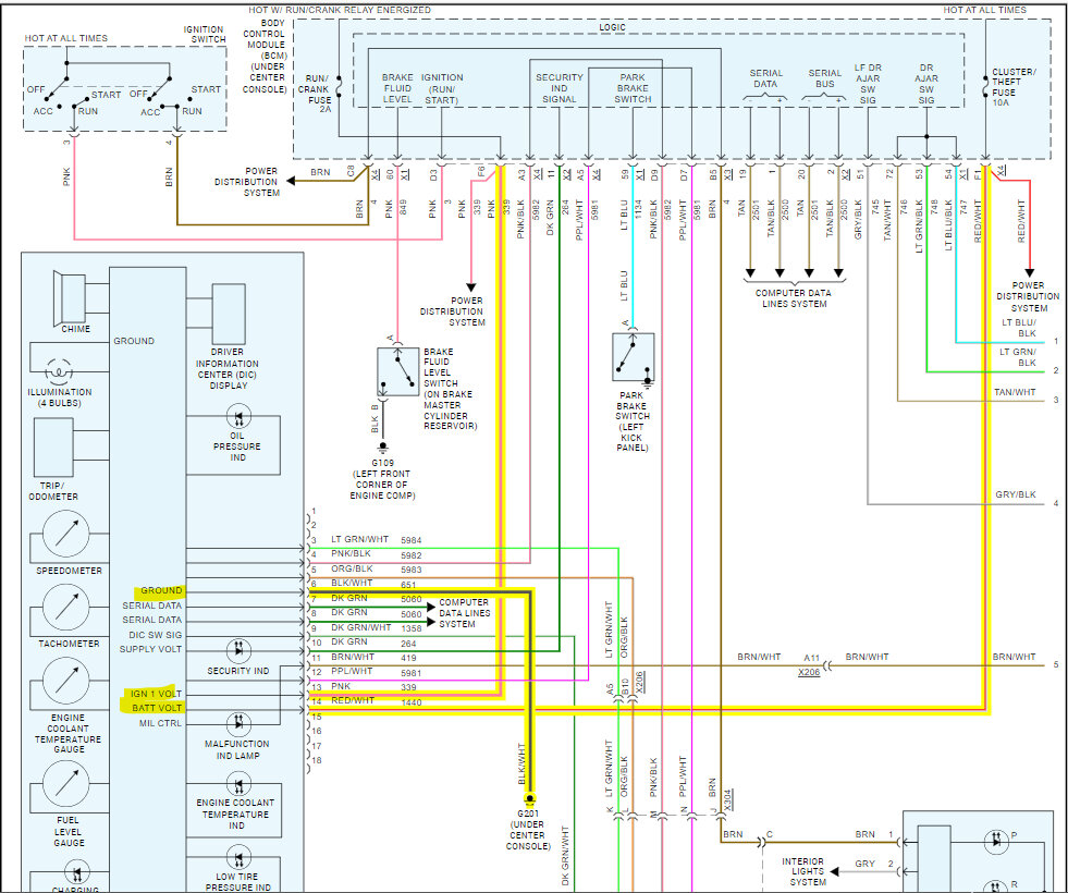

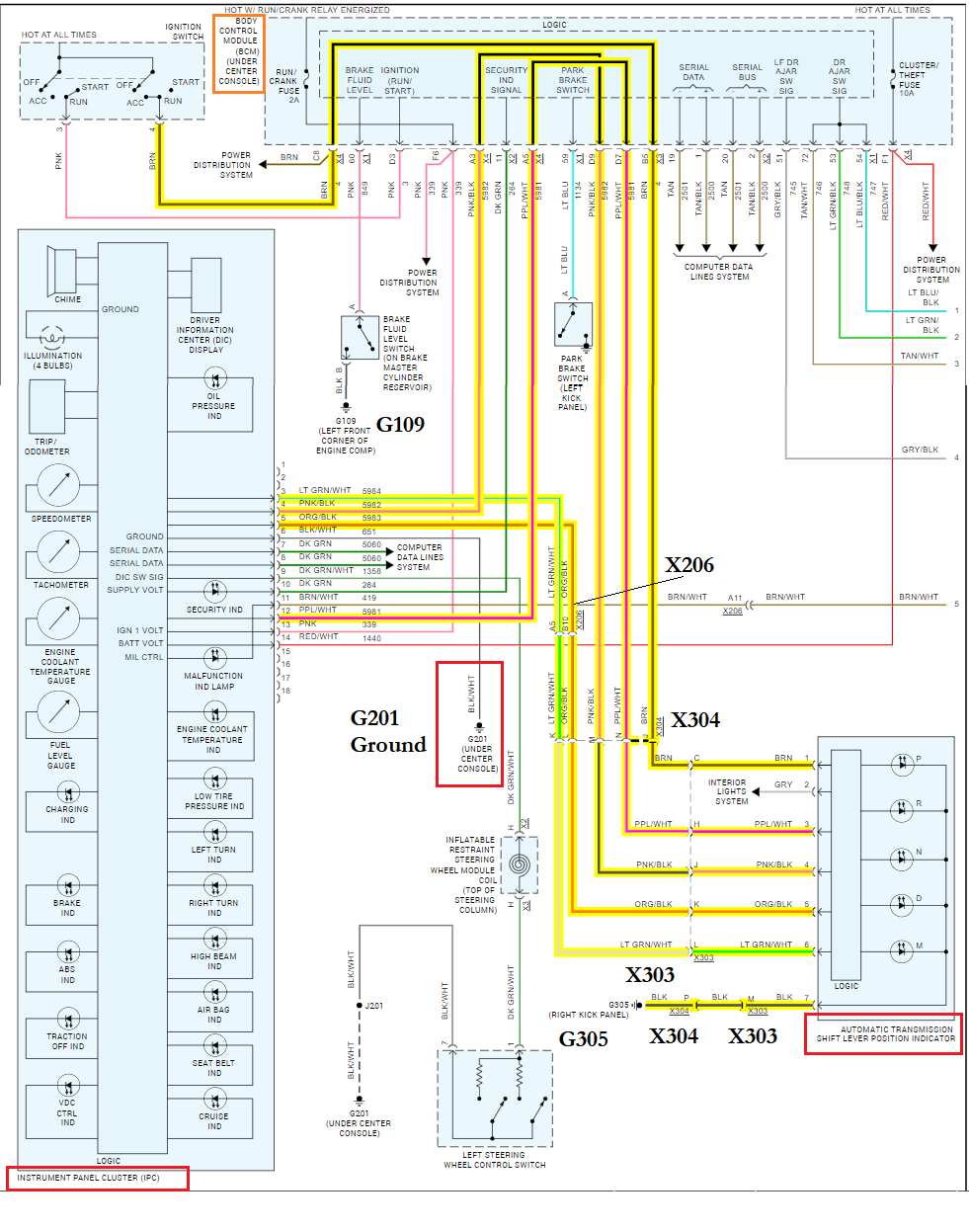

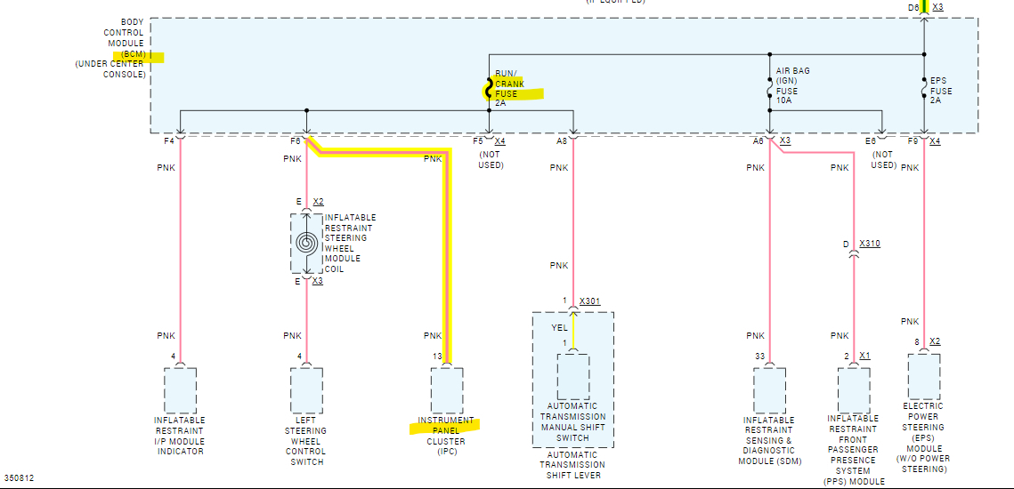

This is the diagram of the Cluster, BCM, and Shift Lever indicator all on one page, A full system scan after the fault occurs should reveal some type of code, but scan with just a basic OBD2 scanner will only give you powertrain codes stored in the ECM. We need to see if there are any codes stored in the BCM and Cluster as well. The Air bag light might be another issue with the Cluster as well. Or a corroded connector going to the Cluster, I've marked out the connector numbers because they were a bit difficult to see.
I think what's happening is the Cluster is losing power or Ground and if you look at the Shift Lever Indicator, pin 1 (Brown wire) is a power feed coming through the BCM from the ignition switch, so it might be that the Shift Lever is not receiving any inputs from the Cluster or BCM and that's why it's just staying at "N".
If these diagrams are correct, those shift indicators pass through the BCM to the Cluster.
When a solder joint cracks, it will be ok one minute and then it will open slightly and cause all kinds of strange issues, The same can be said of connector pins,
When there is current flowing on a circuit, solder joints and connector pins are a slight amount of resistance in that circuit, not a lot, but they create some resistance, and after so many years of heating up and cooling down under normal operations, they can crack, or pin fitment can loosen up.
So, get a full system scan, and we will go from there, I'll see if I can find the locations of these connectors so you can check them as well,
The BCM fail in Chevy/GM vehicles constantly, and the Cluster gets power from the BCM,
If you have a multimeter and want to check for a power loss at the BCM connectors, I can pull up the BCM connector diagrams for you. There's usually 6-8 connectors on these BCMs, they are located up under the dash.

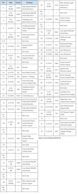

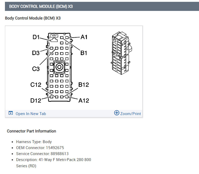

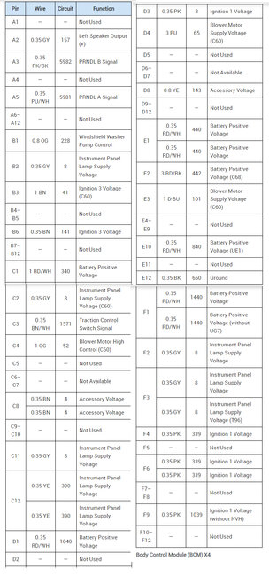

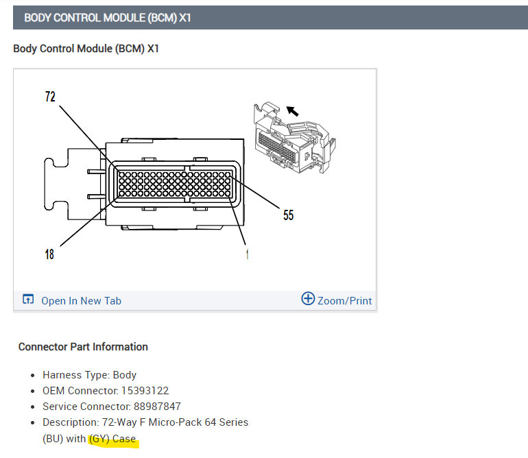

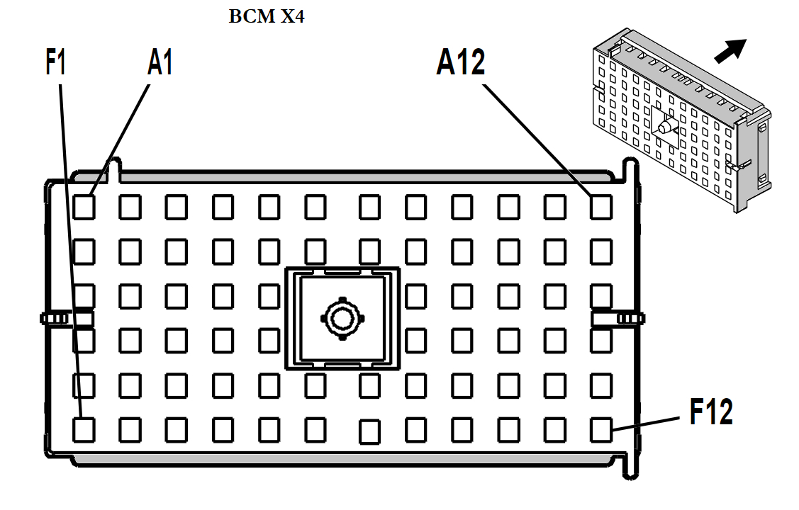

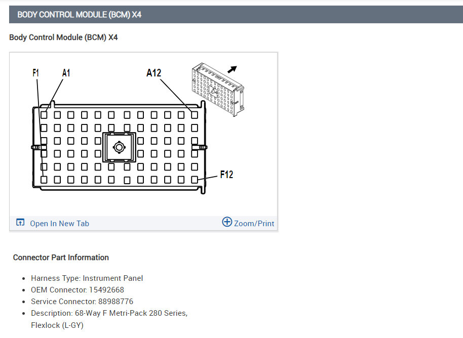

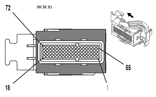

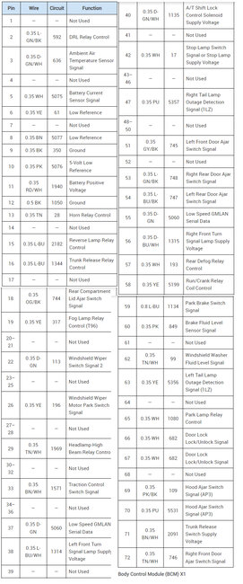

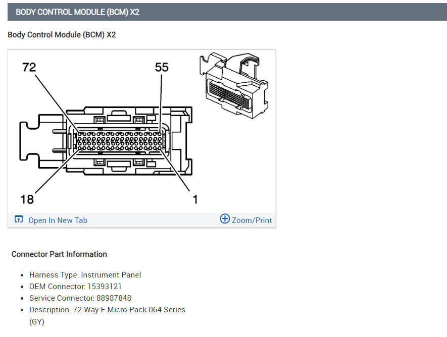

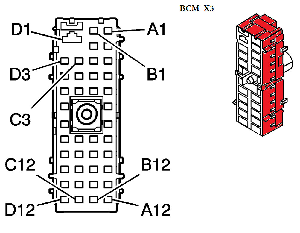

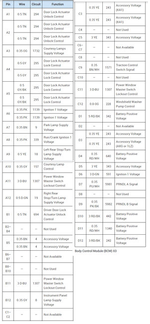

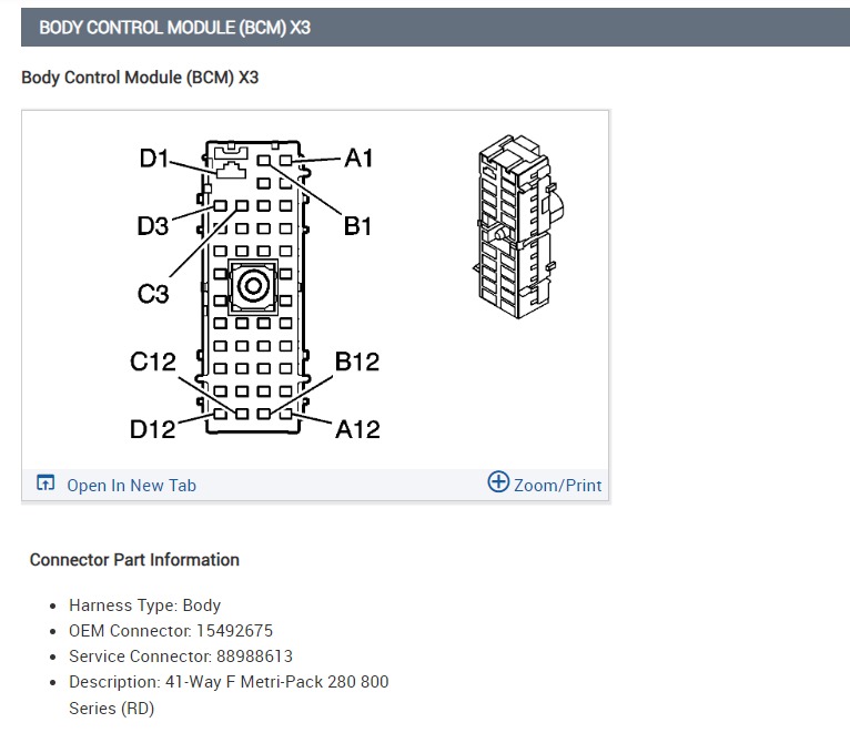

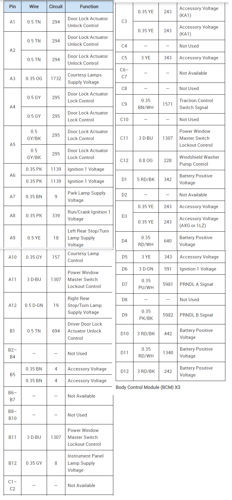

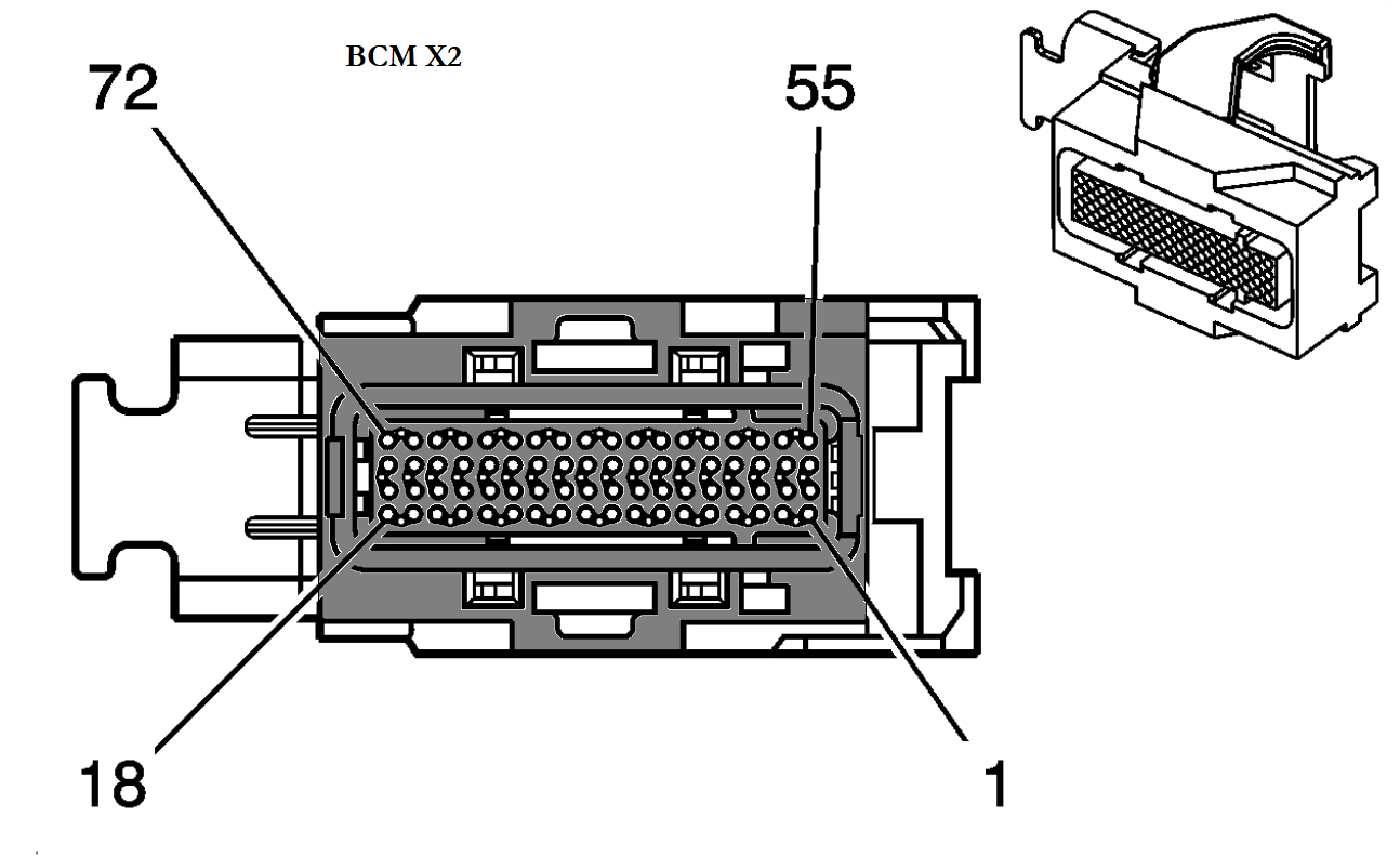

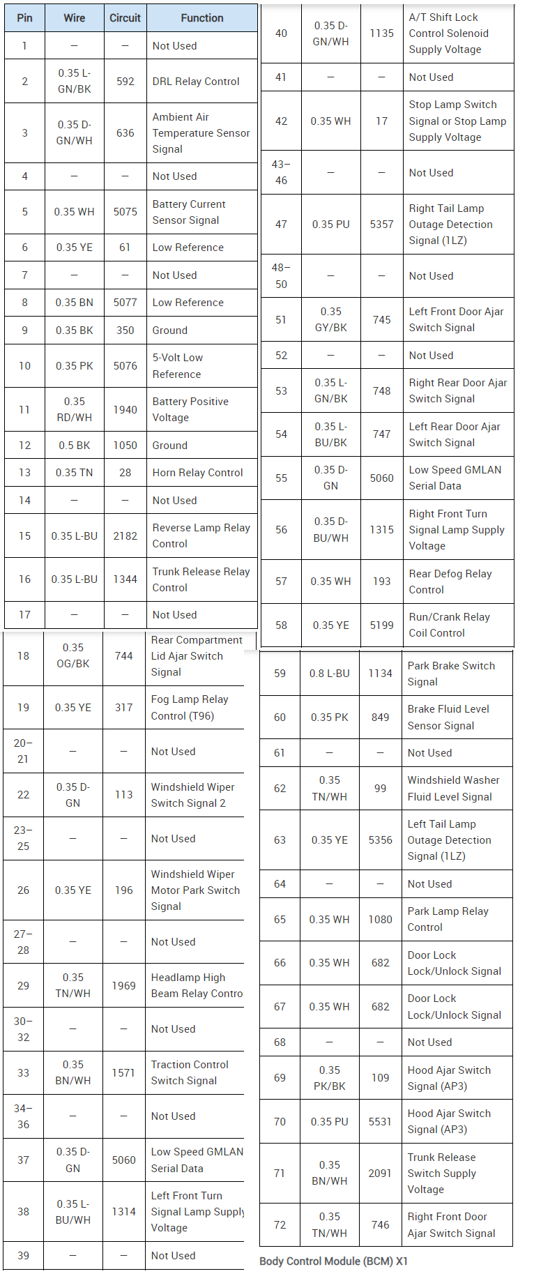

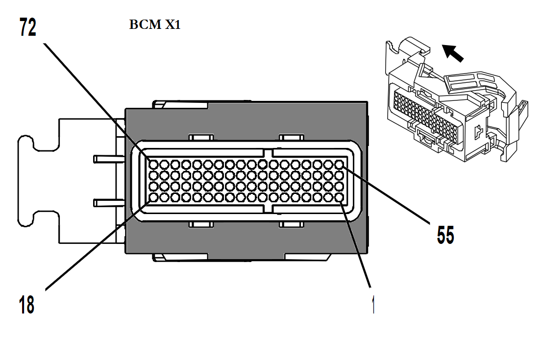

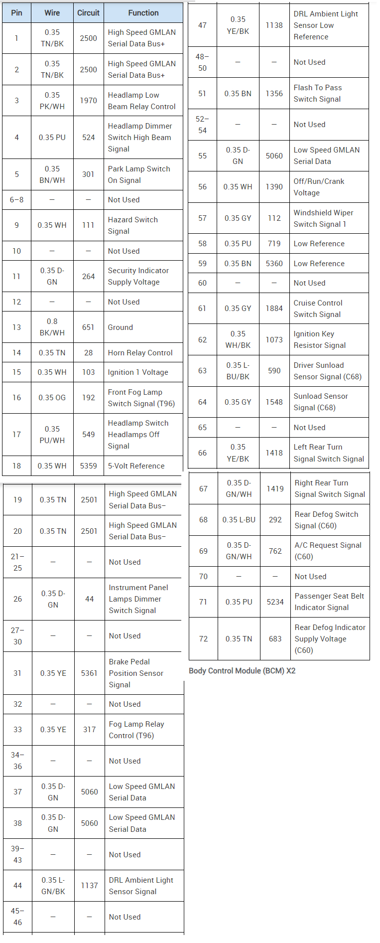

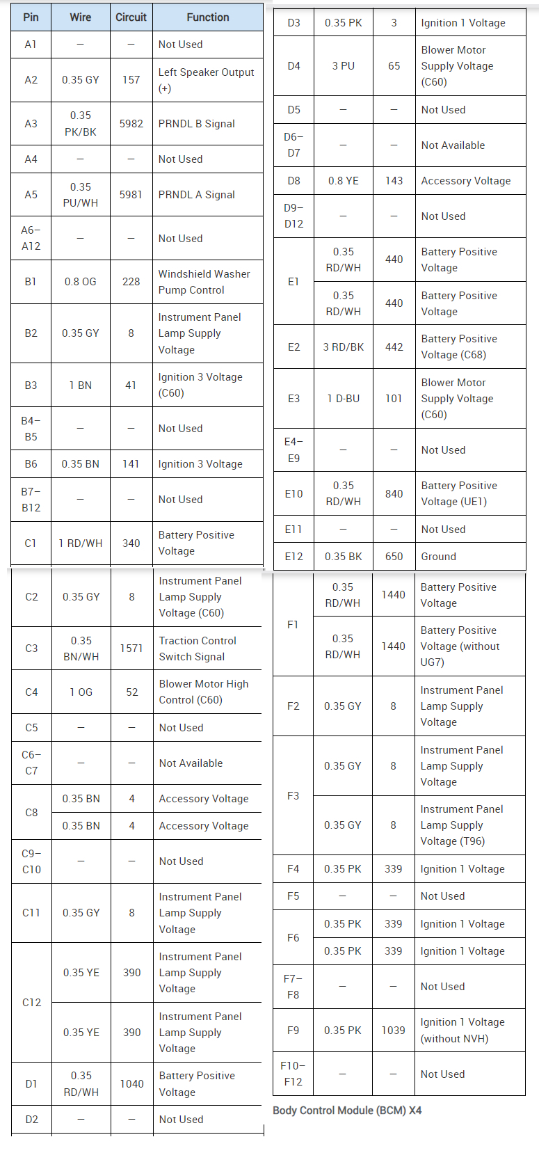

This BCM looks to have 4 connectors, and is also the gateway for the vehicles data network, I will post all 4 of the connectors for you.
Jan 29, 2024 at 1:54 AM
AL514
  • 5,667 POSTS
Here are the BCM connectors X1, X2, X3, and X4, with all their pinouts.

Okay. Once I have access to the vehicle, I will pull the BCM and see if I can notice anything loose or cracked. If I were to pin it, what are the readings that I should be expected to see on the multimeter? If it turns out to be the BCM as a whole, is it possible for me to replace it by myself? In the little research that I’ve done following your input I’ve seen handfuls of people saying that it needs to be programmed by a shop, and others saying that it would be a plug and play, programmed by the first key. Any insight? I greatly appreciate the help so far!

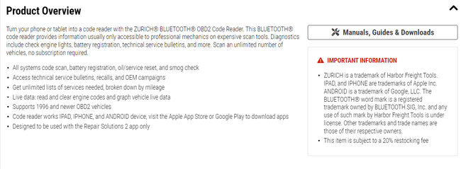

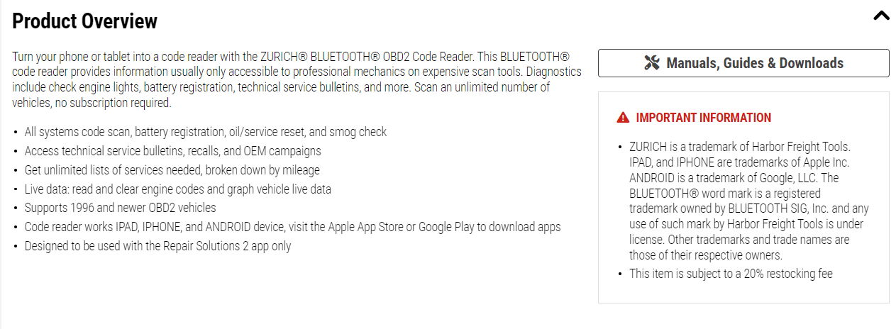

You can try Advanced auto or O'Reilly's, they might use different scan tools, surprisingly Harbor Freight has this little scan tool. It uses an app on your phone, but all the reviews say it can do a full system scan. You can go on their website and read through the reviews.

Sorry for the delayed response as I am currently out of town and trying to do all the trouble shooting on a vehicle that my wife is driving. She was finally able to purchase the scan tool mentioned from HF, ran the test and here’s what we have:
B2705-05: gearshift unlock circuit (high voltage)
U2116-00: lost com with cluster
B1325-03: control mod power circuit (low volt)
U0155-00: lost com with cluster
B0039-0D: R rear seatbelt pretensioner deployment loop (high resist)
Feb 2, 2024 at 5:19 AM

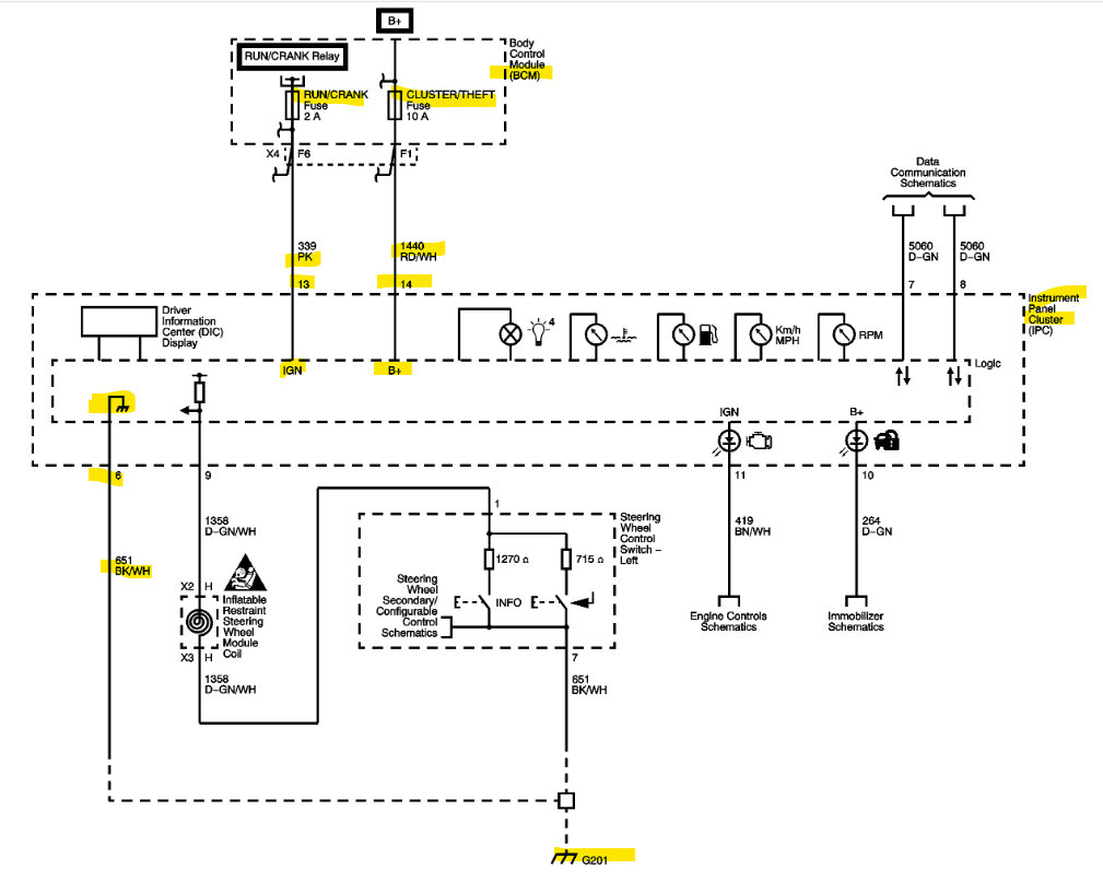

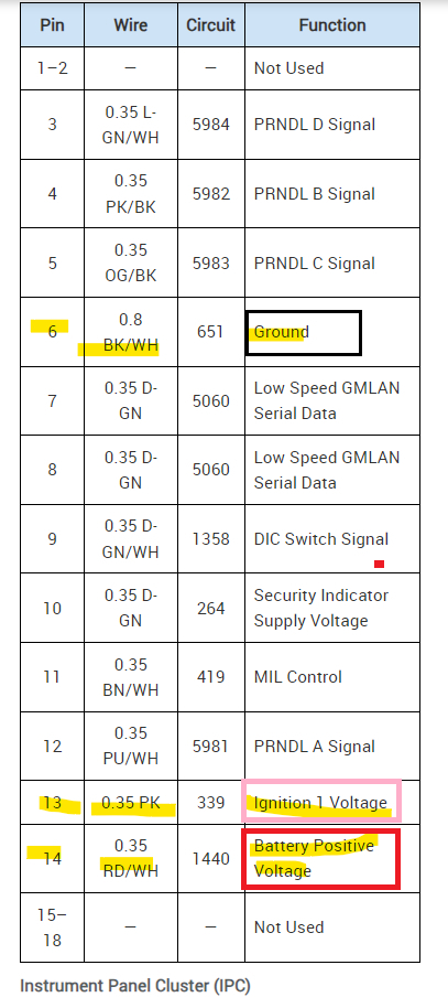

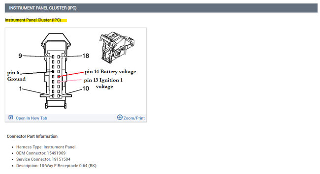

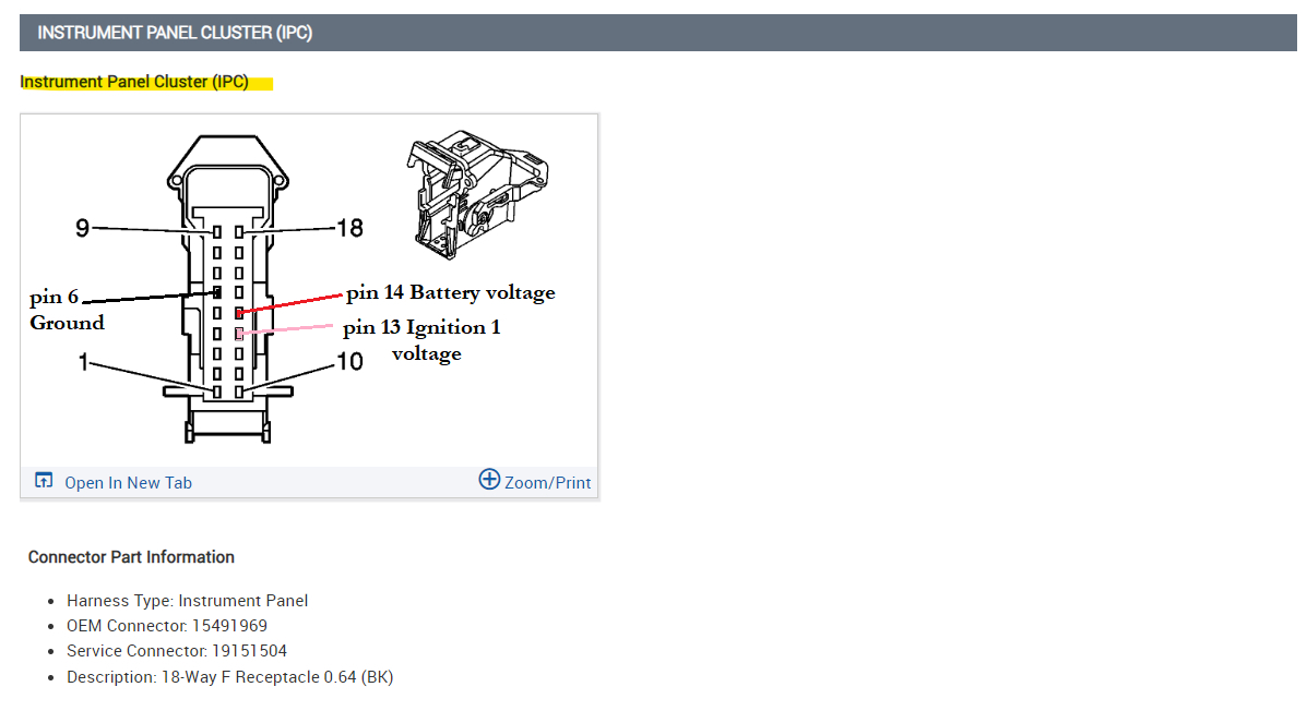

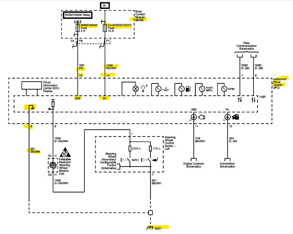

The Cluster has 2 powers, 1 Ground, and 2 communications wires. In a situation like this the first thing I would check is the Clusters powers and ground feeds. I would also use an oscilloscope to monitor the data wires to check if there were any communications signals coming out of the Cluster while its not connected to the network. But I dont think you would see any considering there are two communications codes.
Since power comes from the BCM to power the Cluster, if either power feed is missing 12volts, then you go to the BCM and see if the power is missing there as well. But this is after checking the 12volts and ground at the Cluster.

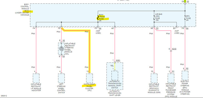

The 1st diagram below is the oem diagram for the Cluster, the 2nd is the aftermarket diagram.

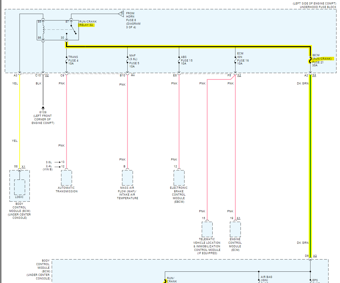

Something to take note of, if power is missing on the Pink wire to the Cluster, which comes from the Run/Crank Fuse 2AMP, which in turn comes from the IBCM (RUN/CRANK) Fuse 21 30AMP. This circuit also feeds the airbag module as well as the Automatic Transmission Shift Lever. This may account for the other codes if powers missing.
The best way to check for power at the back of the Cluster connector is with a test light, it wont put much of a load on the circuit but it will give a clearer indication if the test light is bright.
I would actually use the Clusters Ground for the test lights ground, taking care of 2 tests at once. So the Pink wire and the Red wire with a White stripe on it are the 2 power feeds at the back of the Cluster, and the Ground is Black with a White stripe, Ive high lighted them on the oem wiring diagram.
Once you determine the power situation with the Cluster, that will give you further direction,
if the power feeds are missing and they are missing at the BCM as well, thats where thinks get tricky. Because the BCM controls so much, it needs to have all of its inputs and outputs, as well as powers and grounds checked, and they need to be load tested with a higher amperage test bulb, so youre sure the BCM feeds can handle a few amps. It can be difficult, although these BCMs fail alot, all the tests need to be done.

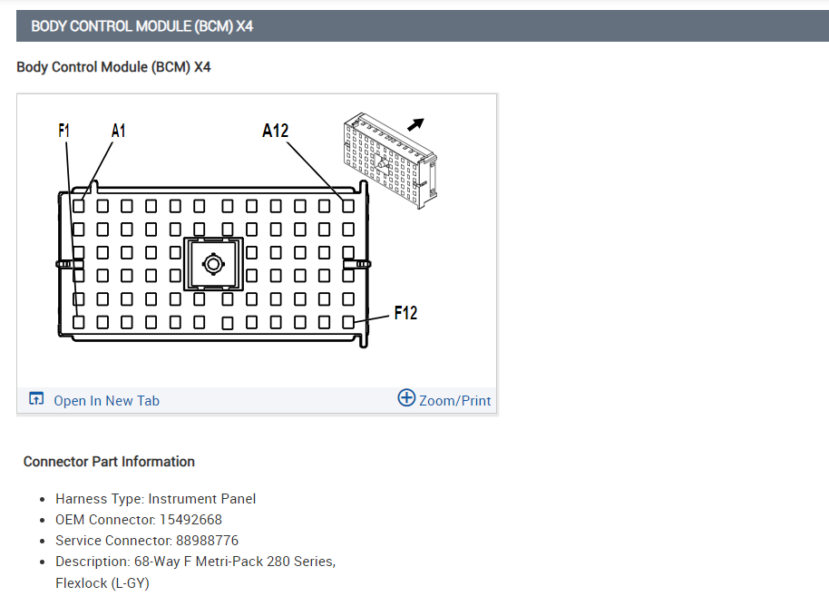

I've added the Cluster connector pinout (diagrams 5,6).
