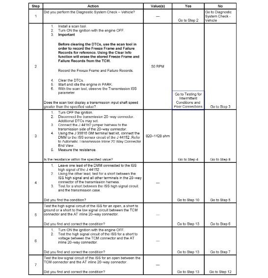

I opened the transmission case cover, replaced the sensor with brand new sensor from the dealer. I Replaced fluid and flushed the transmission. The car is driving normal. the engine check light came back on registering the same code. What do I do?
Jan 24, 2020 at 2:47 PM
Good morning,

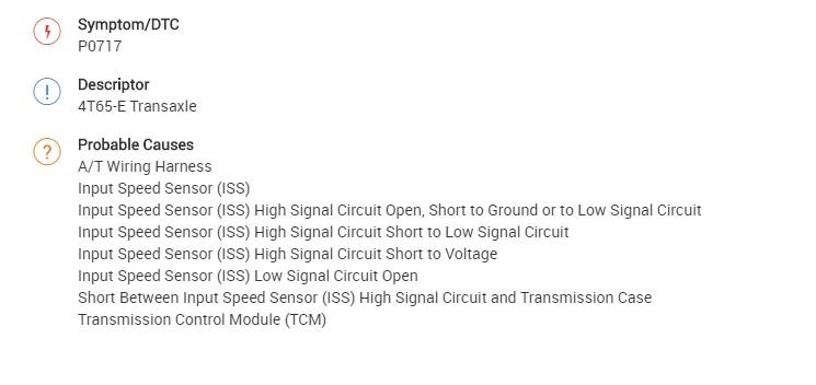

Codes rarely identify failed parts. They identify failed systems.

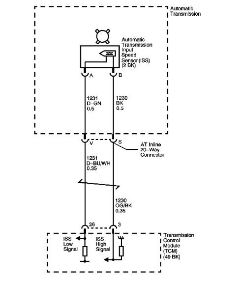

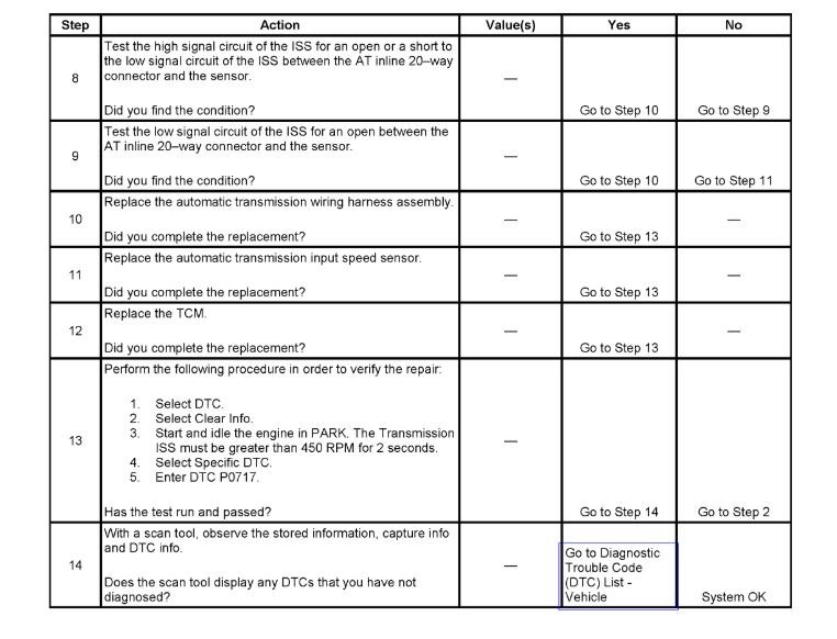

This code is electrical. I attached the possible issues as well as the description and flow chart. The chart needs to be followed. Check the connector at the transmission for fluid in the connector. Common for it to have fluid. If it does, you need the internal harness as there should be no fluid in the connector.
Circuit Description
The automatic transmission input speed sensor (ISS) is a permanent magnet with a coil of wire wound around it. The ISS mounts in the case cover facing the reluctor wheel of the input shaft. As the reluctor wheel is driven by the turbine shaft, an AC signal is induced in the input speed sensor. Higher vehicle speeds induce a higher frequency and voltage at the sensor.
There is a fixed air gap between the sensor and the teeth on the sensor reluctor wheel. The ISS input is used by the transmission control module (TCM) in order to control line pressure, TCC apply and release and transmission shift patterns. This sensor is also used to calculate the gear ratios and TCC slippage.
If the TCM detects a low input speed while the vehicle and engine speeds are high, then DTC P0717 sets. DTC P0717 is a type B DTC.

Ensure the wiring harness is not stretched too tightly or other components are pressing on the A/T inline 20-way connector body. Also inspect for proper clearance to any other components and wiring. Refer to Testing for Intermittent Conditions and Poor Connections. See: Vehicle > Component Tests and General Diagnostics
Test Description
The numbers below refer to the step numbers on the diagnostic table.
3. A Yes answer indicates that the transmission side of the circuit is functioning properly.
4. Although the resistance is within specification in Step 3, there may be a short to ground or a short to voltage condition.
8. This step begins the transmission harness diagnosis.
