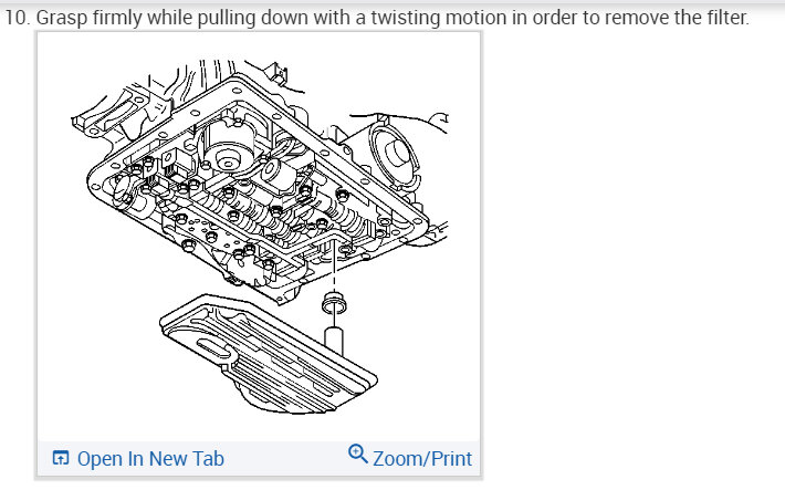

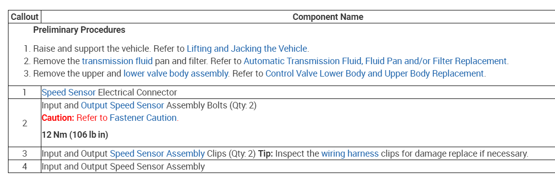

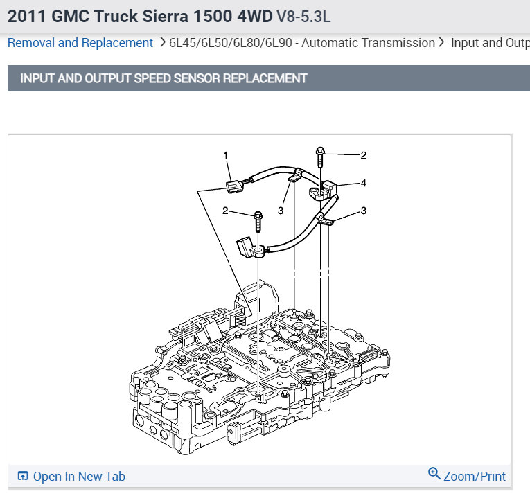

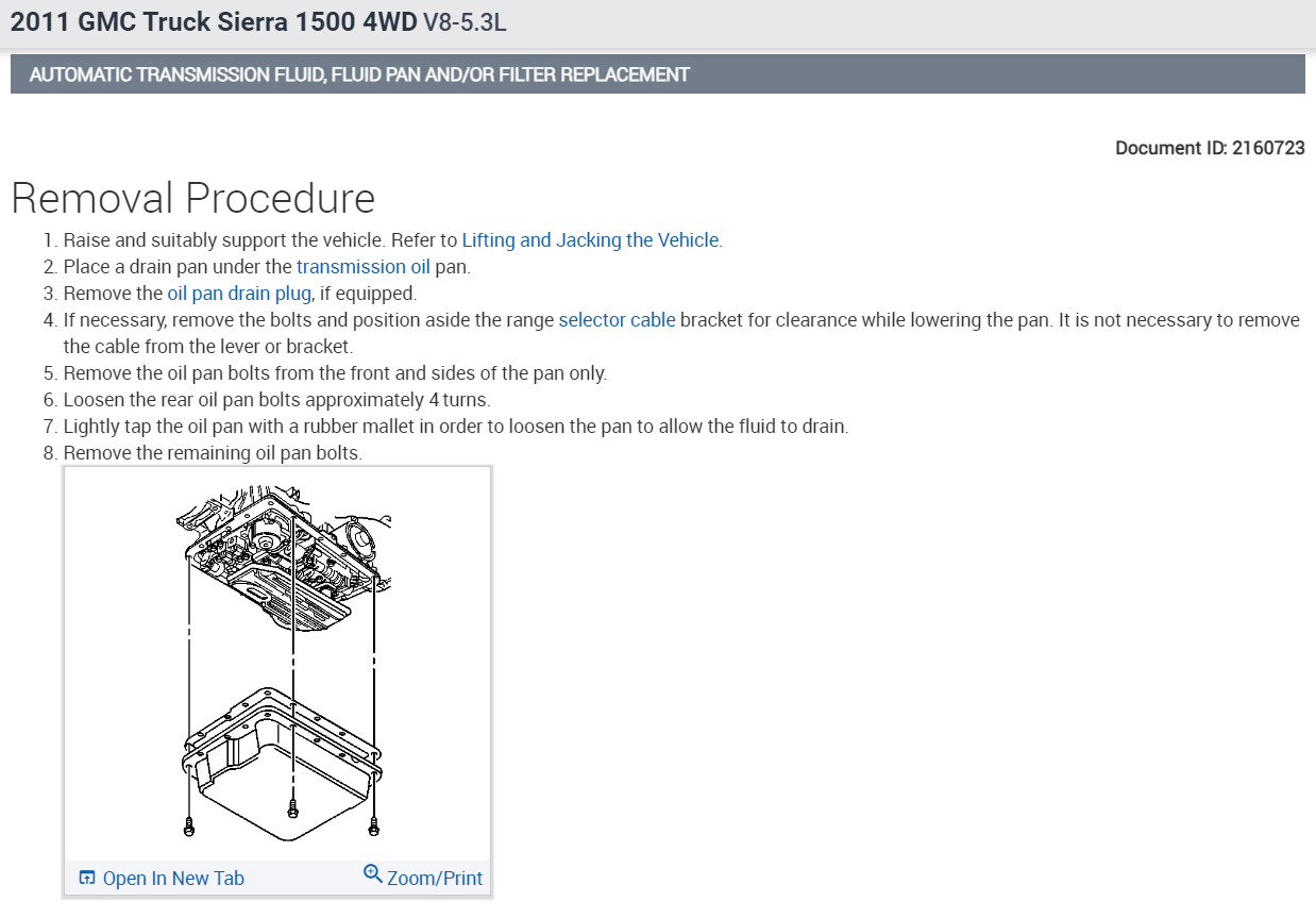

I’ve been dealing with some irregular rough shifting with my truck. Code reader says transmission input sensor, cruise control also does not work. Any help on locating this would be greatly appreciated. I was told it is in the pan behind the manifold.
Aug 28, 2023 at 12:33 PM
  • 55,433 POSTS

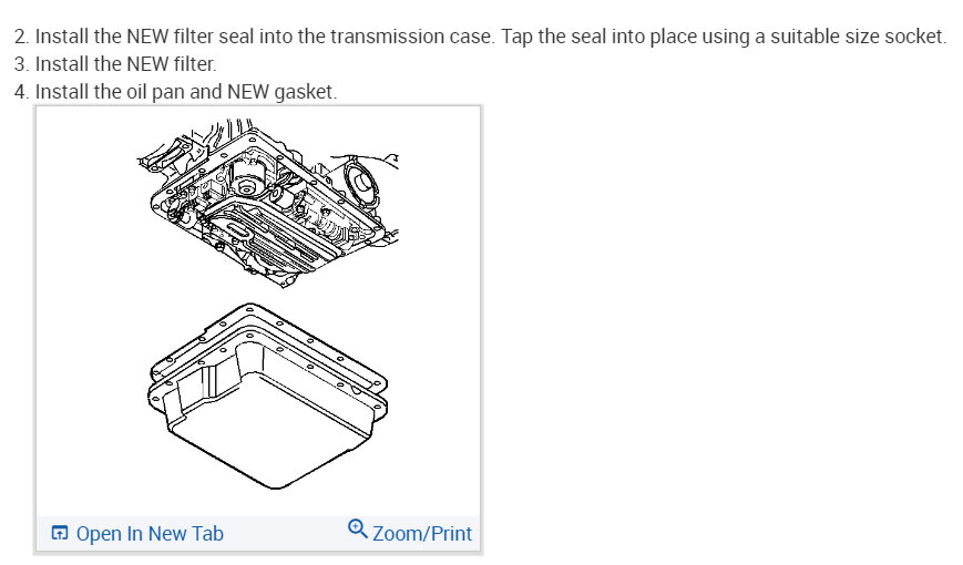

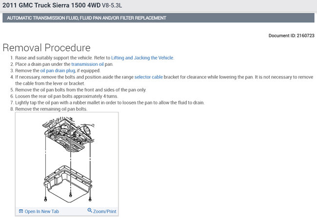

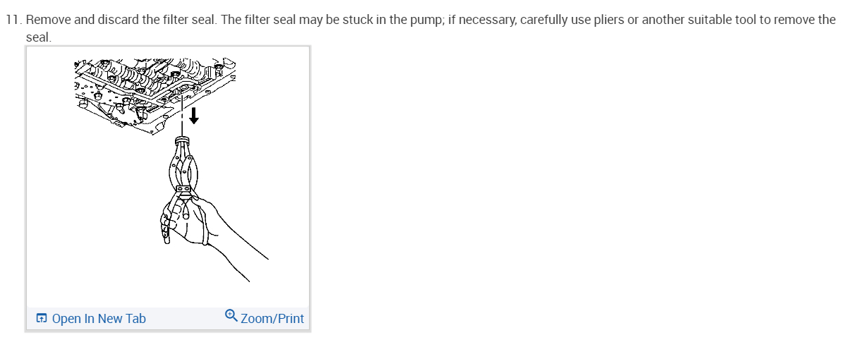

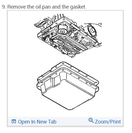

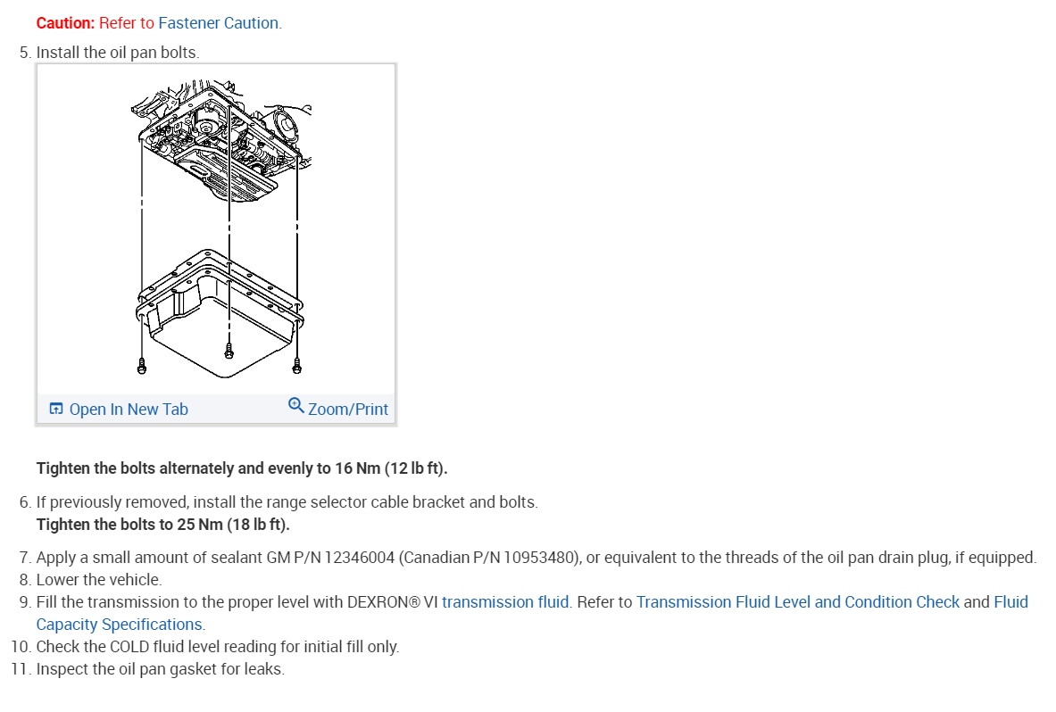

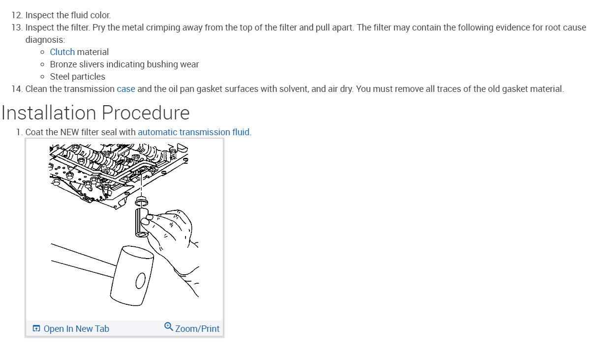

It looks like the input and output sensors are serviced together and they are located inside the valve body. So, you will need to remove the transmission pan so you might as well change the filter. Here is how to change the sensors and filter out:
Automatic Transmission Fluid DEXRON VI
Check out the images (below). Please let us know if you need anything else to get the problem fixed.
