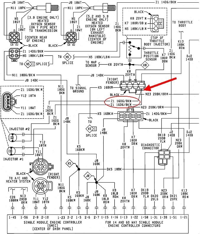

Look for the 8-terminal connector between the engine and the body, then find the double dark green / black wires. Check for 12 volts on both sides of that connector. This has to be done while a helper is cranking the engine so the ASD relay is turned on. If you have to do this by yourself, I can describe how to bypass that relay, then you can do any testing without even having to turn on the ignition switch.

Injector wires can't be used for ground. Both will read full battery voltage, which could be drawn down by the starter motor during cranking. The control wires get grounded by the computer when it pulses them open, then they go back to full battery voltage. When both are at battery voltage, the difference is 0 volts. During the brief few milliseconds the injectors are pulsed open, the control wires will only be drawn down to about 2 volts. Digital voltmeters take a reading, analyze it, then display it while taking the next reading. Some of those readings will be 0 volts, and others could be from 7 - 10 volts. Digital meters do not average their readings, so you'd see the display bouncing around wildly, showing random, meaningless numbers.
Since we know you have spark and fuel pressure, we have to look at why the computer is not pulsing the injectors. You're going to need a scanner for the next tests. The first is to call up the crankshaft position sensor and the camshaft position sensor, then watch the state displayed that they show. Chrysler's DRB2 scanner lists them as "No" with the ignition switch on, they they will switch to "Present" during cranking. If one stays on "No" during cranking, that is the circuit that needs to be diagnosed further.
The scanner will also let you perform a test on the injector circuit. When you press that selection from the drop-down menu, the computer will pulse the selected injector once per second. You should be able to hear and feel the one that's being energized. At the same time, you should see a nice cone-shaped spray of fuel into the throttle body, and if you have the fuel pressure gauge attached, fuel pressure will bleed down to near 0 psi within about 15 - 20 seconds.
If the injectors do not pulse while the scanner displays "Activating test", or something similar, the driver circuits in the computer are defective, or there could be a 12-volt supply to the computer missing. There are typically four different 12-volt feeds to the computer, but if you lose one of them, you would usually have different symptoms than just dead injectors. For that reason, we'll put that on the back burner for now.
If you observe the injectors are pulsing during the scanner's test, but you don't see the cone-shaped spray of fuel under them, it would appear the injectors are plugged. That is extremely uncommon unless someone dumped sugar in the gas tank. To be able to perform this procedure, the injectors have to be fed with their normal 12 volts, and that comes through the ASD relay. That means the scanner will command the computer to turn the ASD relay on too during this test. On most models the ASD relay also powers up the fuel pump or pump relay, so fuel will remain up to its normal pressure.
If you suspect the injectors are plugged, you'll need to manually pulse the injectors with the ignition switch off so the computer doesn't turn on the ASD relay and / or fuel pump relay. Unplug an injector, then connect a pair of small jumper wires to its terminals. Connect the other end of one jumper wire to the battery's positive post. Momentarily touch the other end of the second jumper wire to a paint-free point on the engine. You should see fuel pressure drop a little each time you do that. We rarely have to get this far into testing, but the Chrysler instructors always mentioned to not hold power on an injector for more than a few seconds to prevent overheating and warping the internal electromagnetic coils.
The last thing to look at is the connectors themselves. They look like 3/4" x 1" rounded black ovals. I've seen two GM minivans that used this same style of plug, develop stretched connector terminals. One injector on one of those vans didn't pulse at all. One on the other van caused an intermittent miserable misfire on humid days. Both were solved by using a small pick to bend the terminals so they made stronger contact.

I applied 12 directly on injector pins,both injectors made a clicking sound.
I looked at the pins in the injector caps,they looked like they should be squeezed together so I did.
Install the caps and turned the engine over, I was shocked to see the engine start and run.
Thank you for your great troubleshooting.
