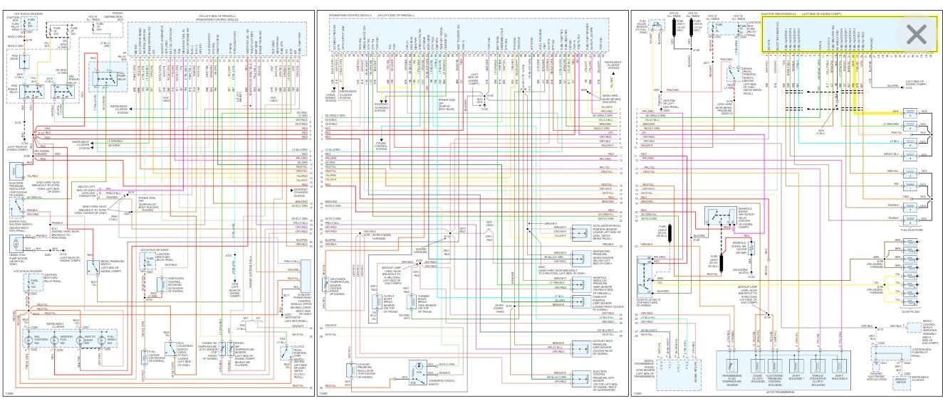

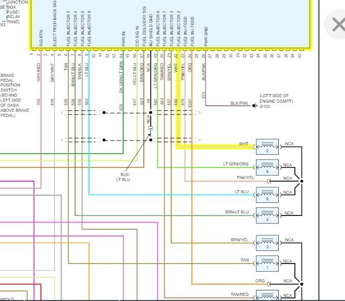

  • CERTIFIED EXPERT
You need to check the harness as I suggested. Check the highlighted wire to the injector that is effected.
Start there.
Can you upload a video of the truck running?
Sep 4, 2019 at 3:39 AM

  • CERTIFIED EXPERT
That cannot be correct. 2 or 3 volts will not work an injector. You need to retest that voltage.
I want the voltage for the one with the miss as in the diagram I sent you.
Sep 4, 2019 at 9:39 AM
