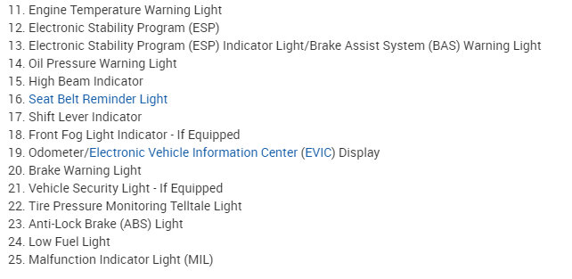

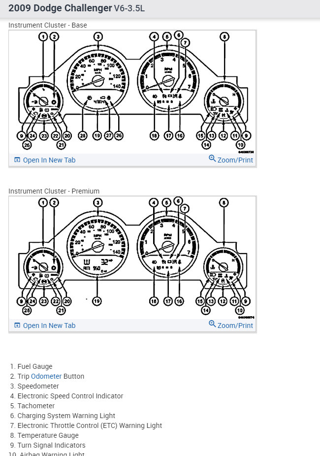

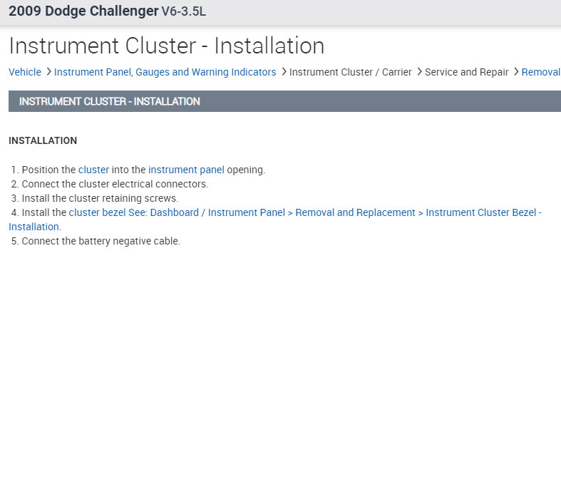

Information display on the dash doesn't work. I can see my milage but nothing else. is there a fuse or part that needs to be replaced?
Dec 22, 2021 at 4:27 PM
SQM
  • 6,383 POSTS

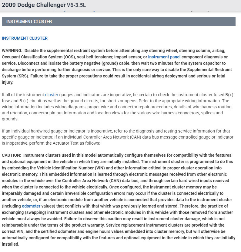

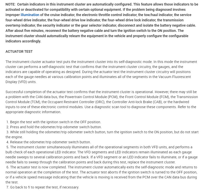

So, are all the gauges functional and the only issue is the display?

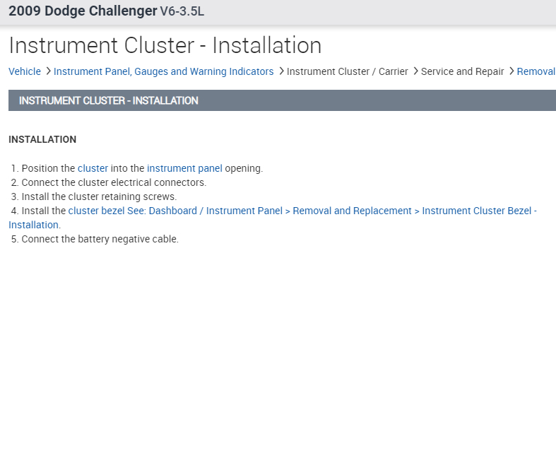

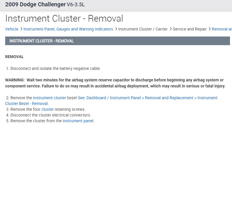

This is likely due to an issue with the gauge cluster and not a fuse. Those display panels can go bad over time. It could also be due to a loose connection or faulty circuit board for the panel.
To figure it out you will have to remove the gauge cluster and inspect the wiring as well as the circuit board.
