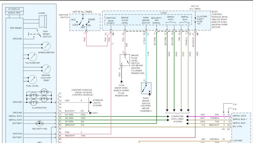

Information center wiring diagram
2005 CHEVROLET MALIBU
200,000 MILES • 6 CYL • 2WD • AUTOMATIC
CHAD CARTER DAVID
It’s burnt out need a wiring diagram.
Feb 10, 2019 at 2:42 PM
  • 110,194 POSTS

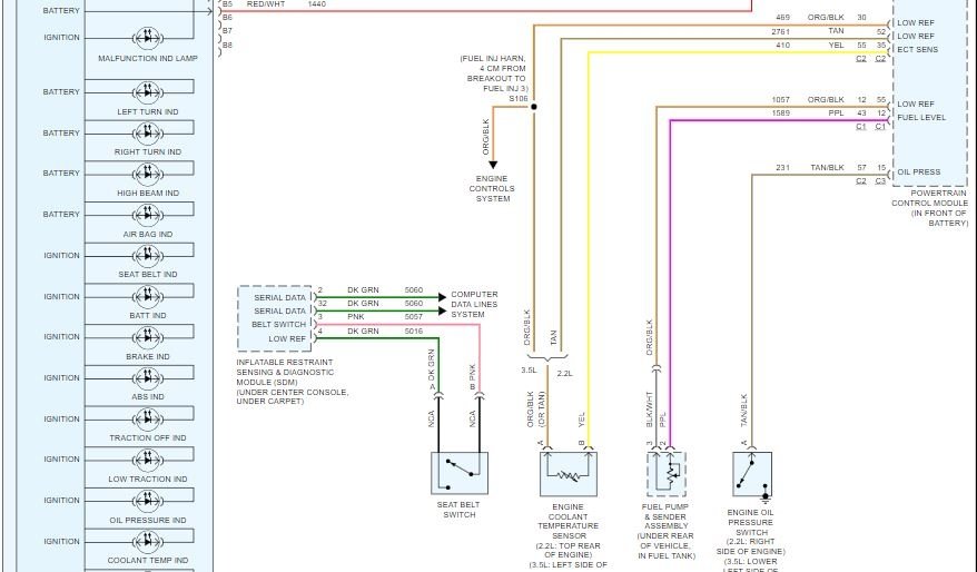

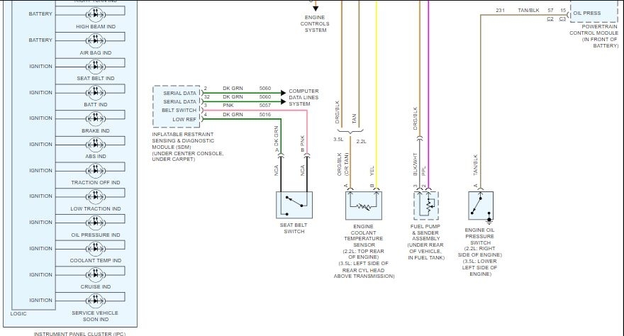

I have attached the entire wiring schematic for the instrument cluster. I had to break it into three parts because of its size. However, I overlapped each picture so you can follow it.
Let me know if this is what you needed or have other questions.
