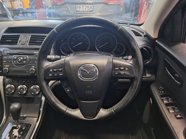

It all started when i purchased the vehicle.
1. I can't adjust the time settings. (This model has no H or M button and also no set button)
2. I can't access the trip computer to see fuel consumption.
I have replaced the clock spring.
I have also replaced the circuit board on the steering wheel for the buttons.
I have connected to a launch diagnostic tool and have found nothing to point me in the right direction.
Please see image of radio and steering.

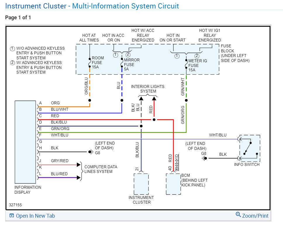

Is your launch diagnostic tool a CAN scanner? If not, you can get a CAN scanner (Controller Area Network) which will work on most cars from Amazon.
https://youtu.be/u-4syLc-ifQ
This will scan the body portion of the car not just the drivetrain. I would first check the ROOM fuse inside the car under the dash. Then let's use a voltmeter to test the connection of the WHITE/BLUE wire from the info switch to the info display, here is a guide to help and the wiring diagrams to help, if the connection is good, you may have a BCM going out.
