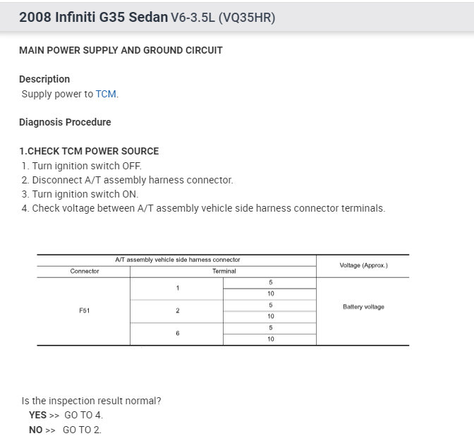

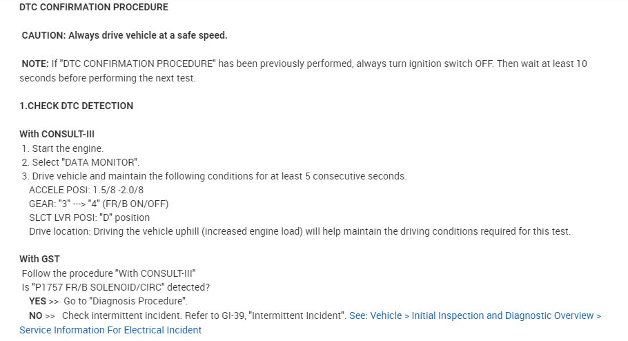

Good afternoon, first of all I want to thank you for your time.
The first symptoms I have experienced were when hitting speed over 60 MPH it wouldn’t shift gears to speed up, but RPM would keep climbing. Another symptom is when coming to a sudden stop, if I accelerate suddenly the car shakes before speeding up.

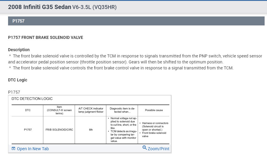

I have a P1757 code saying Front Brake solenoid. My question to you would be, what is the best approach to this repair? I have been searching for a donor transmission from the same vehicle but no clue if it will work as simple as a swap. My other option would be opening the valve body and soldering on the connections then put it all back together.
Thank you

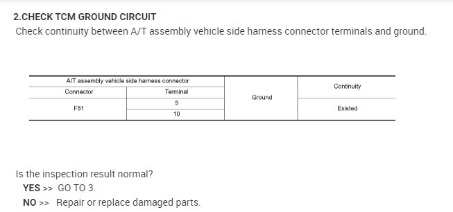

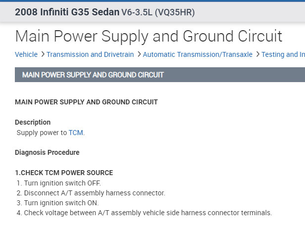

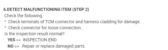

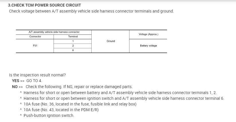

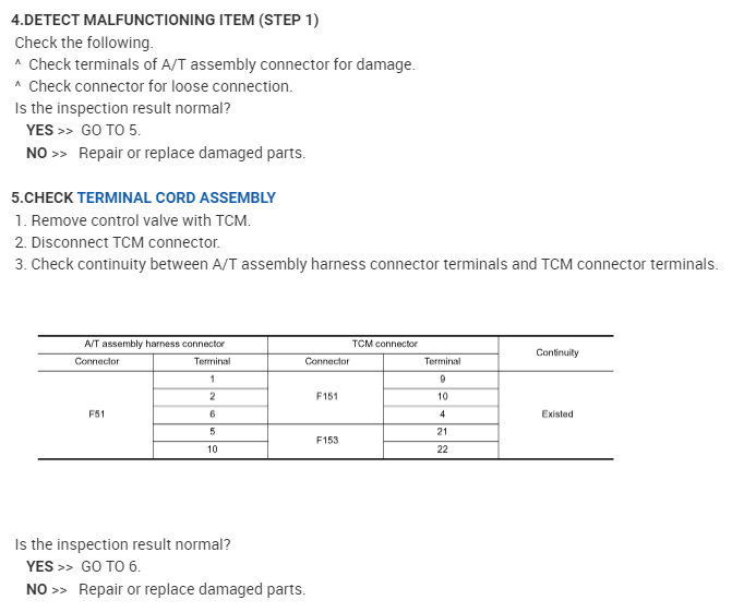

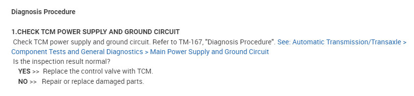

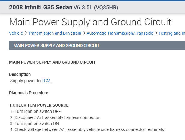

The code indicates there is an electrical issue. It could be something as simple as a connector, so that is where I would recommend starting rather than replacing it.
As far as the code, I attached the diagnostics below. Take a look through them and let me know if you are comfortable performing them
