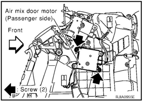

hi there i have a 2003 g35 coupe with 51k and its a 6spd, i am having issues with my air conditioning, my AC was working fine few days ago but past two days when i turn on my ac its not blowing cold air any more it blows hot air just fine but not cold air,so my question what can be causing this problem, thank you for your help in advance. :D
Nov 18, 2007 at 6:29 AM
  • 55,423 POSTS

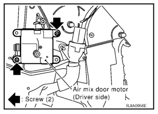

It sounds like a blend door actuator haws gone out, Here is a guide that will give you an idea of what you are in for when doing the job.
And here is what it will be like on your car.
I would check the freon level as well, here is a guide for that.
