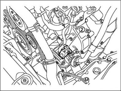

Hello. Can someone tell me where to locate the Camshaft Position Sensor on a 2006 Infinity M45? Service Engine light came on after the car stalled out. AutoZone pulled a code PO340 for the Camshaft Position Sensor. I've purchased the replacement part but need to know where it is located on the engine. Thank you very much!

Camshaft Position Sensor-located on left front of engine @ #2-see picture below:
https://images.2carpros.com/forum/automotive_pictures/12900_cmps_2.jpg
