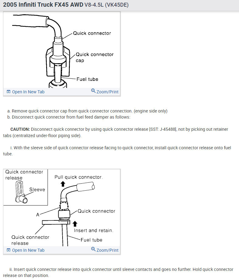

When I turn on my heater in car after it gets hot there is a rotten smell that comes thru the vents. I also believe I smelled it outside of the car when I parked. What could it be from? And how do I fix it? heater core?
Dec 7, 2009 at 3:01 PM
SQM
  • 6,383 POSTS

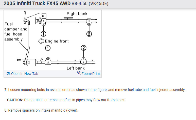

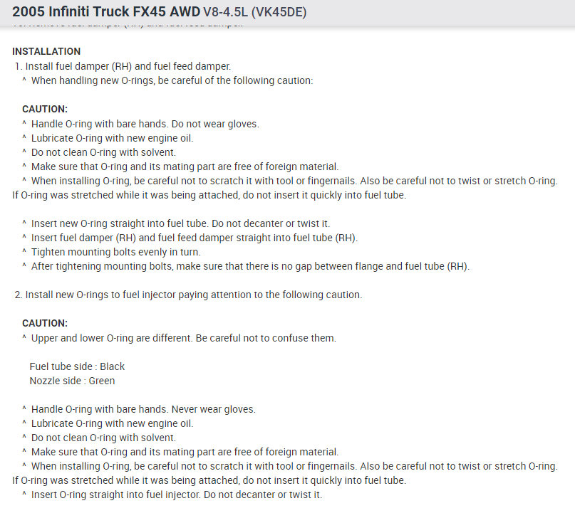

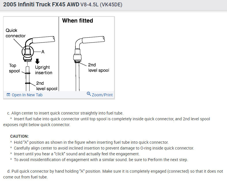

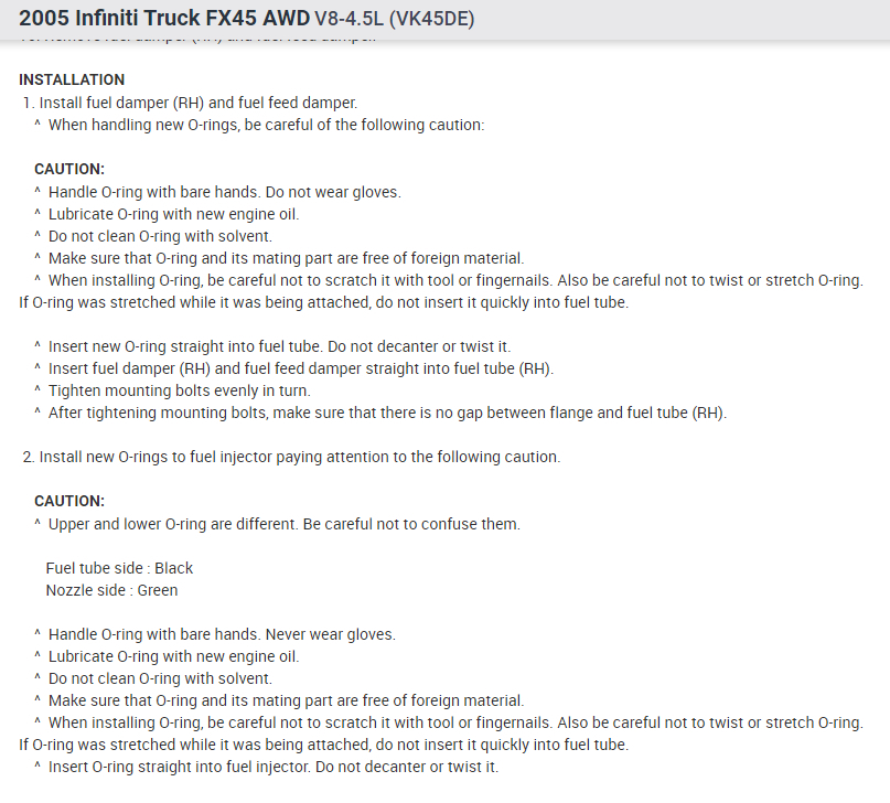

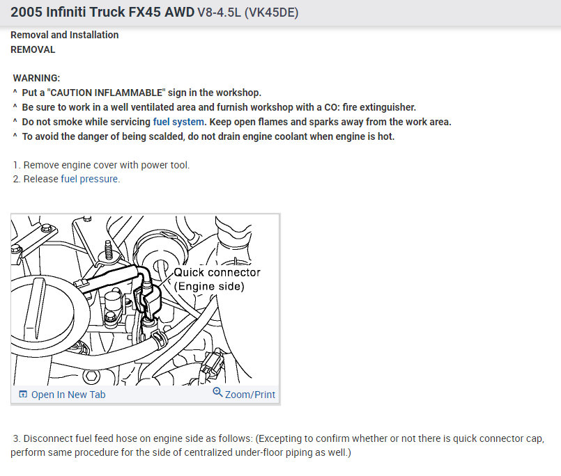

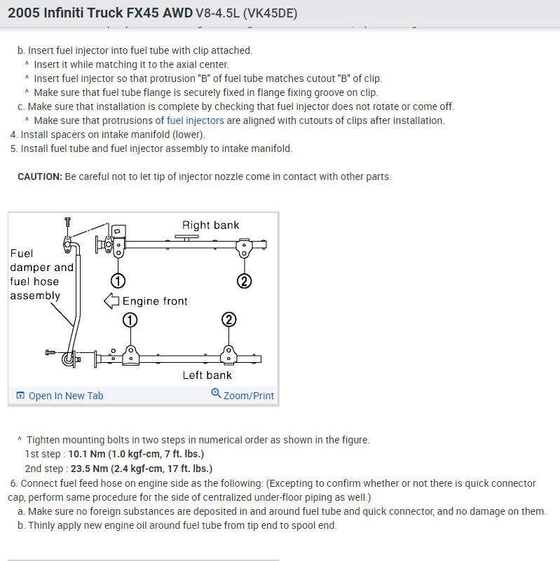

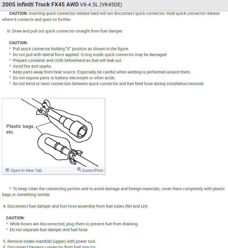

Rotten egg smell in the vehicle typically indicates some type malfunction in the fuel system. A worn out damaged catalytic converter, fuel pressure regulator can produce sulfur gas and that can enter the vehicle.
Keep in mind that leaking heater core will have a sweet smell to it for the coolant.

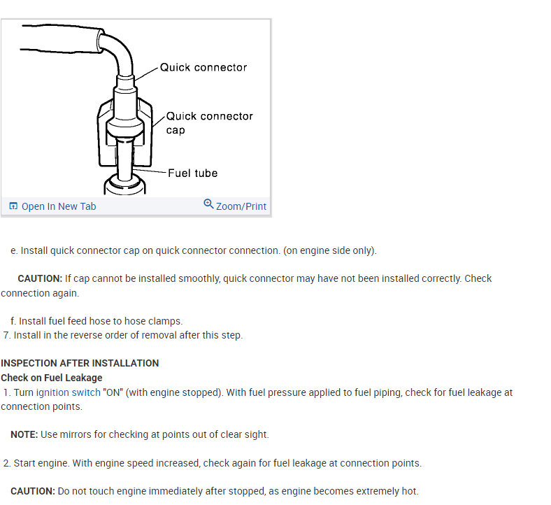

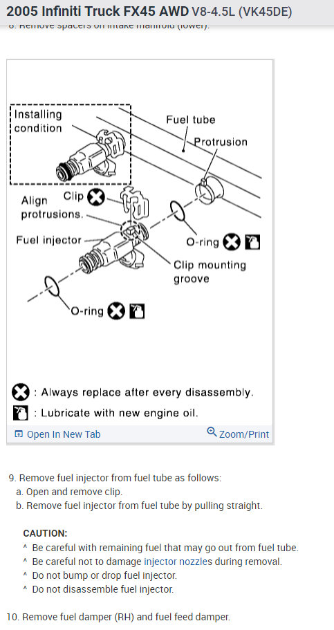

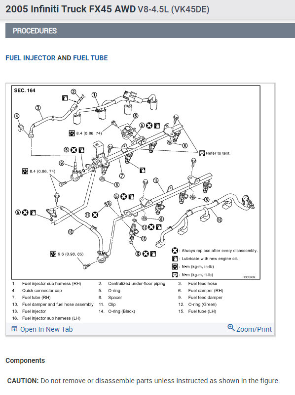

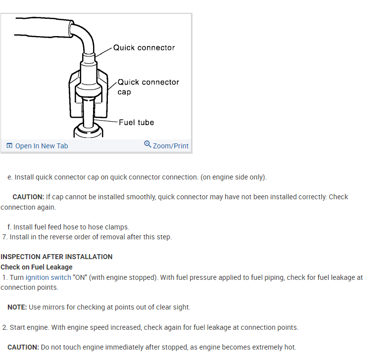

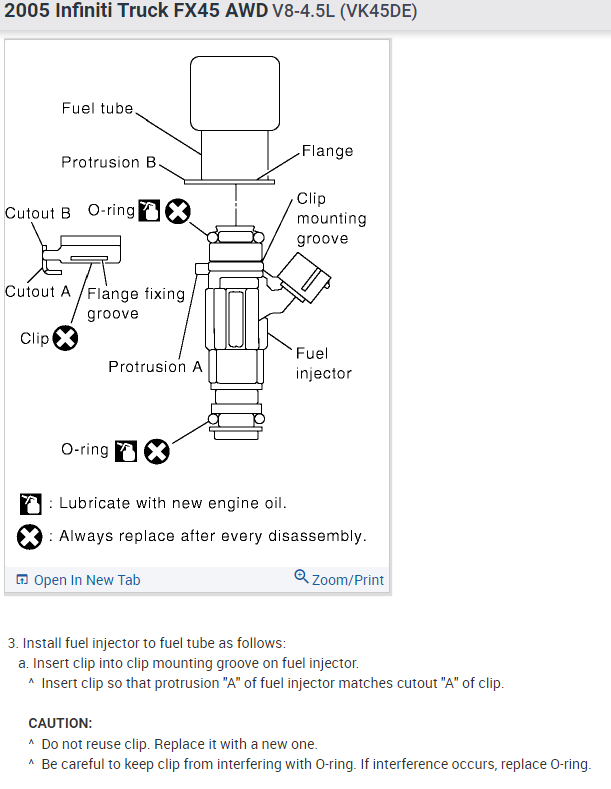

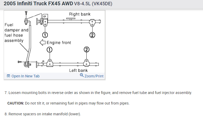

First do an inspection of under hood fuel components. Check the fuel rails and the fuel regulator. Look for any leak or damage to the components.
Also it will be a good idea to scan the vehicle for any trouble codes. Typically with a bad catalytic converter the check engine light will be illuminated.

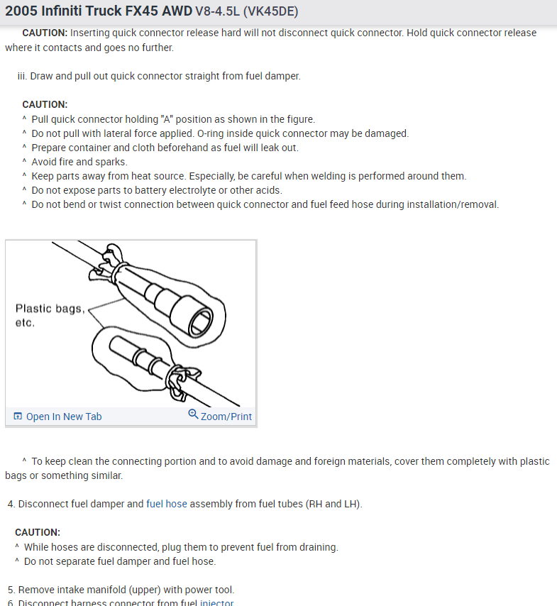

I have attached the fuel system diagrams under hood.
