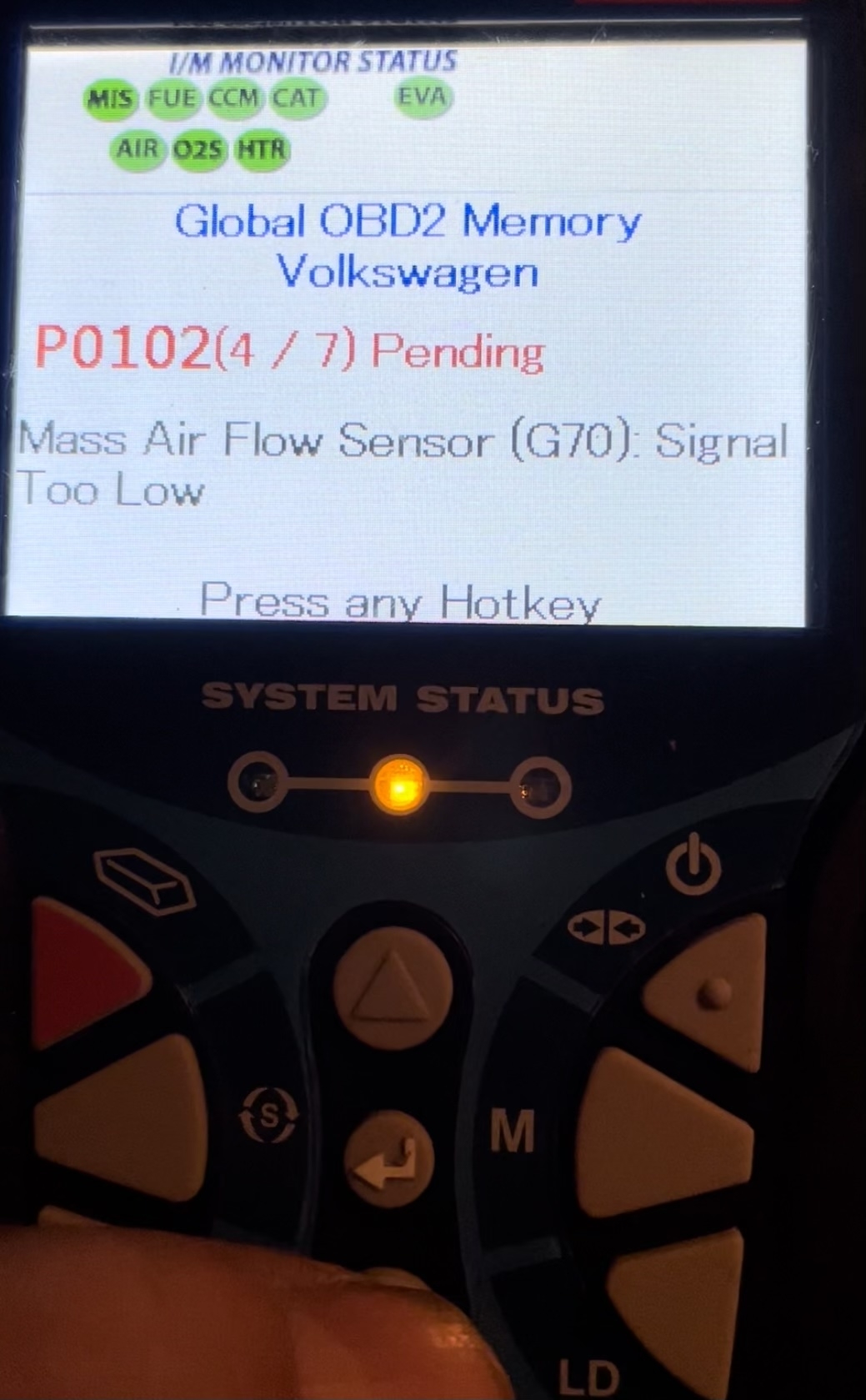

My EPC light and check engine light are now on. My fiancé did scan for codes and I’m not sure of all of them at this time, but I do know a few coolant codes came up.

And I believe a code regarding the ECU in it.

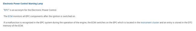

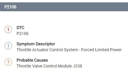

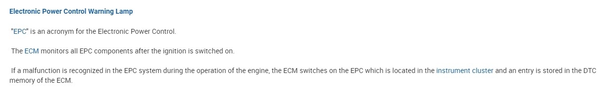

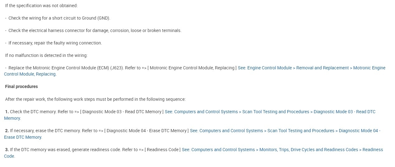

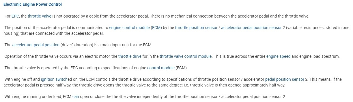

You described some intermittent acceleration issues, and that would make sense given you're seeing the EPC (or Electronic Power Control) light on the dash. When that warning light is illuminated, it usually means there is a fault somewhere in the system that controls the position of the throttle valve. I've attached a more detailed description of this system below.
If you're able to share the exact codes that the vehicle is setting, we might be able to pinpoint it a little further for you.

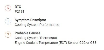

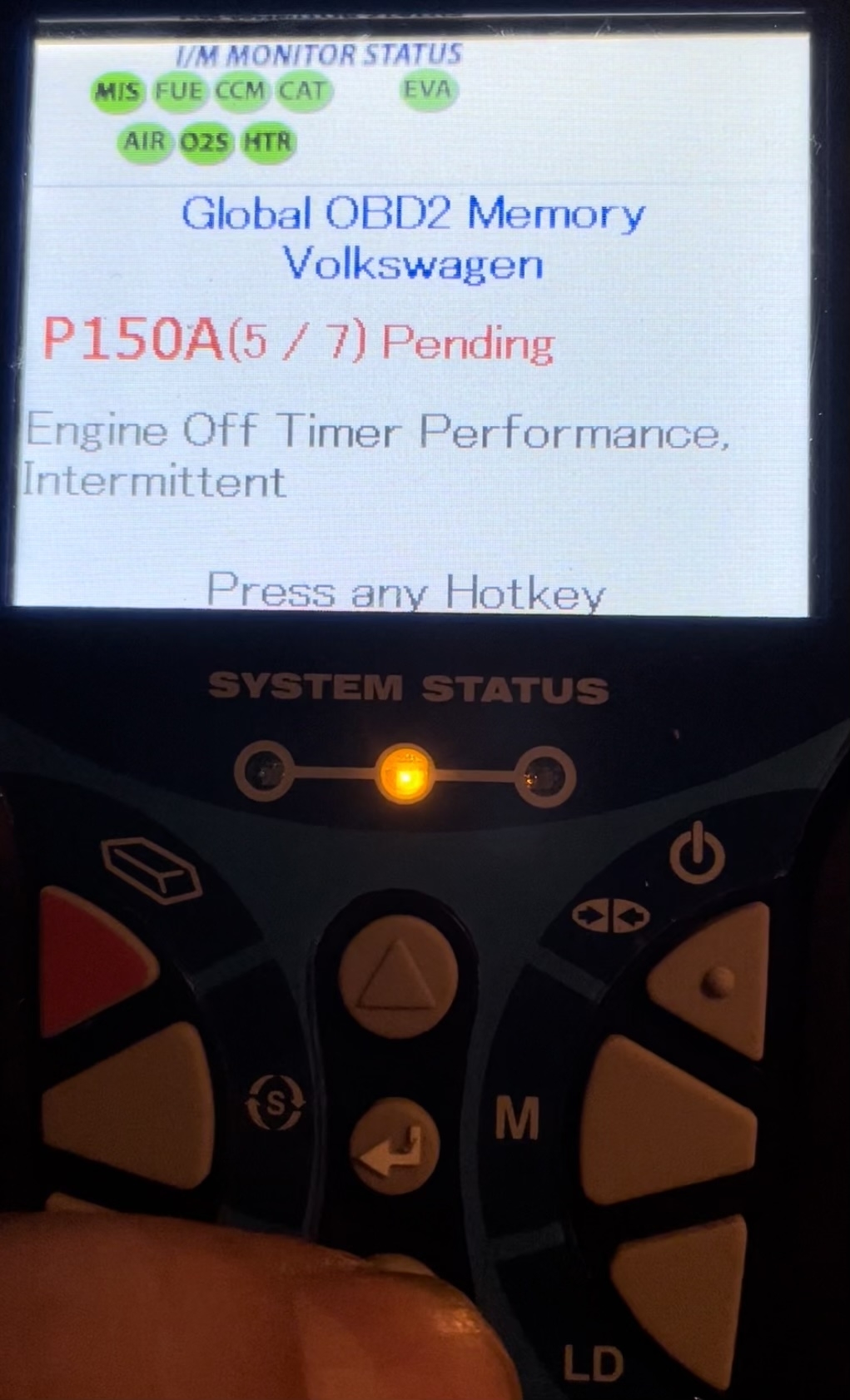

BWEST25
  • 6 POSTS

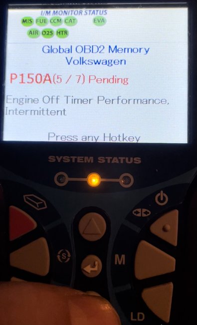

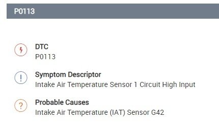

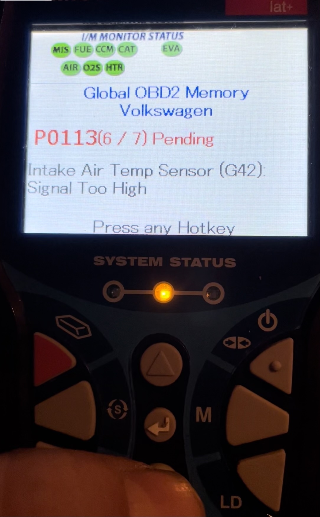

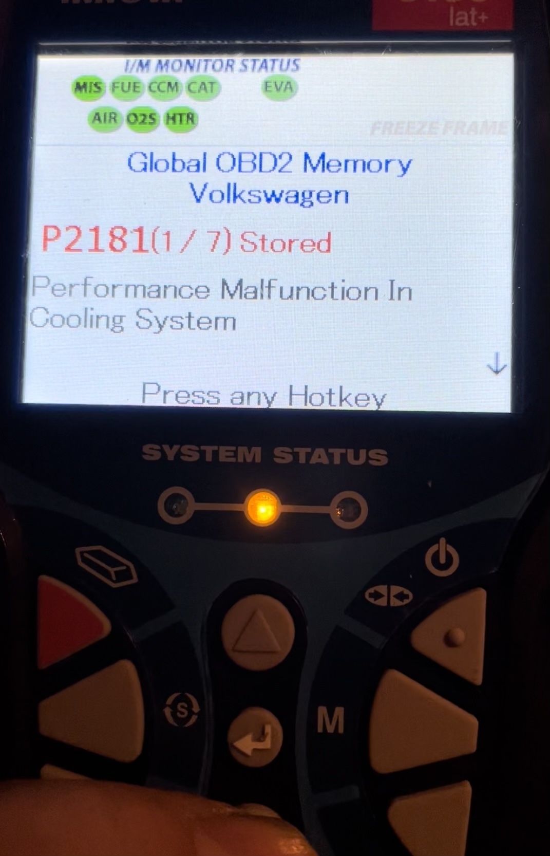

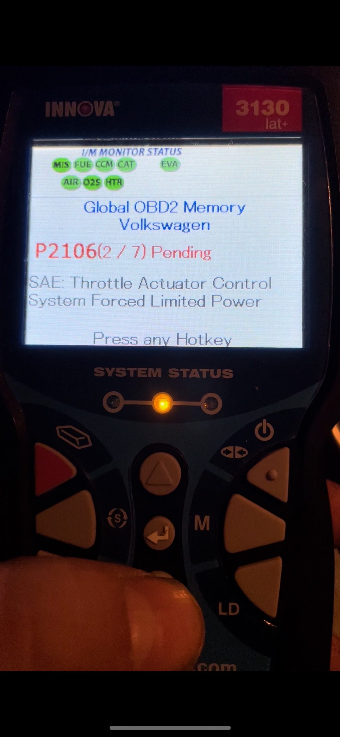

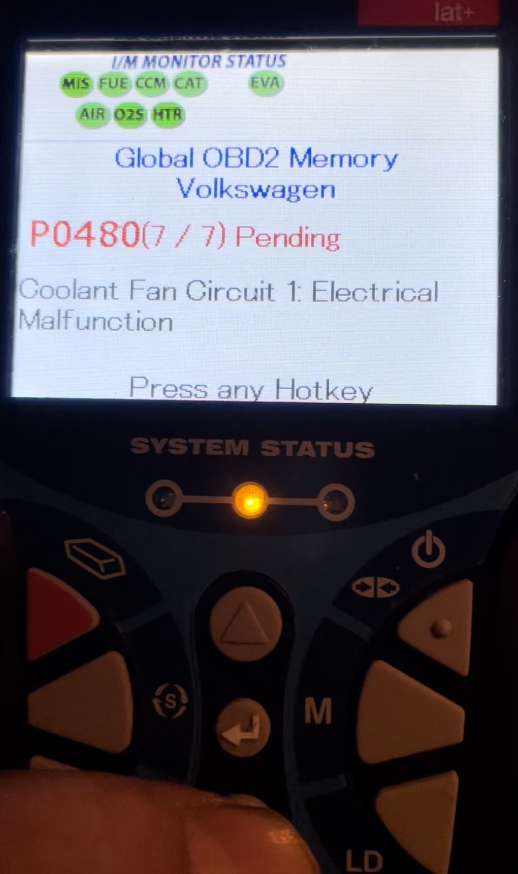

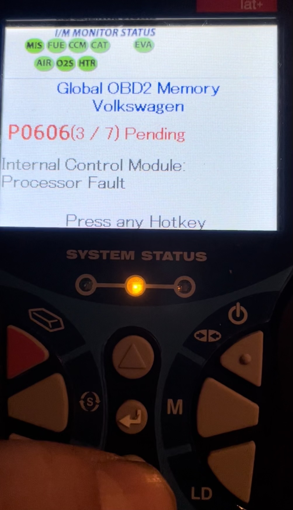

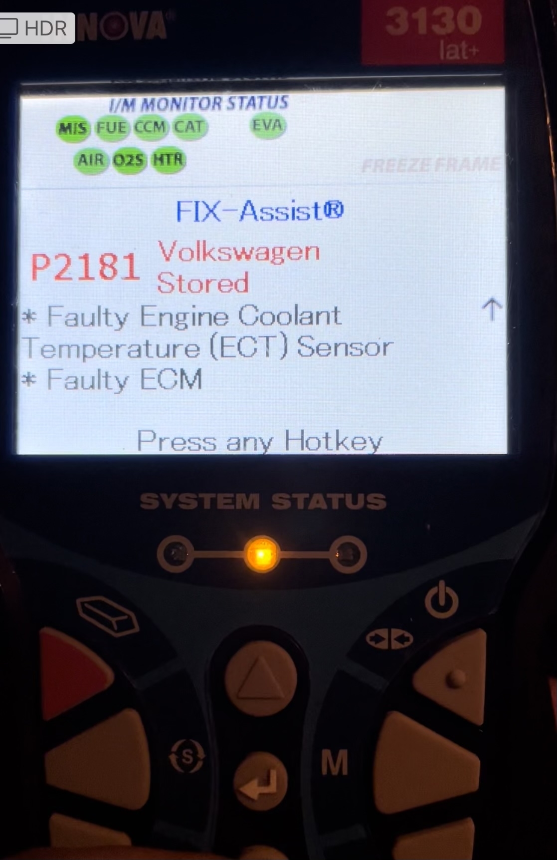

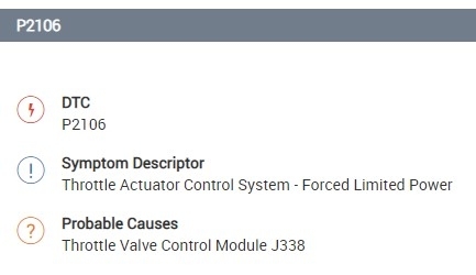

These are the codes.
Mar 10, 2022 at 1:56 AM

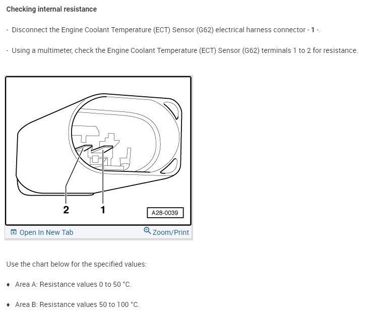

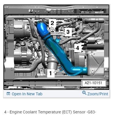

WENDY W
  • 86 POSTS
Hello!
Thank you so much for sending the codes you were able to retrieve.

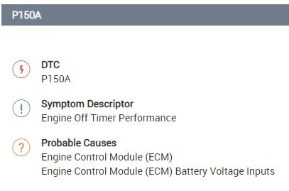

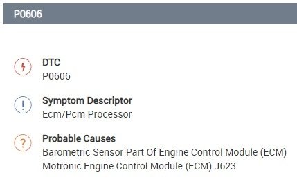

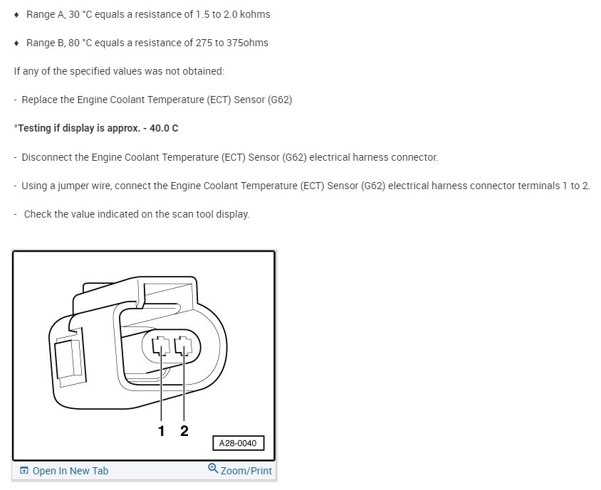

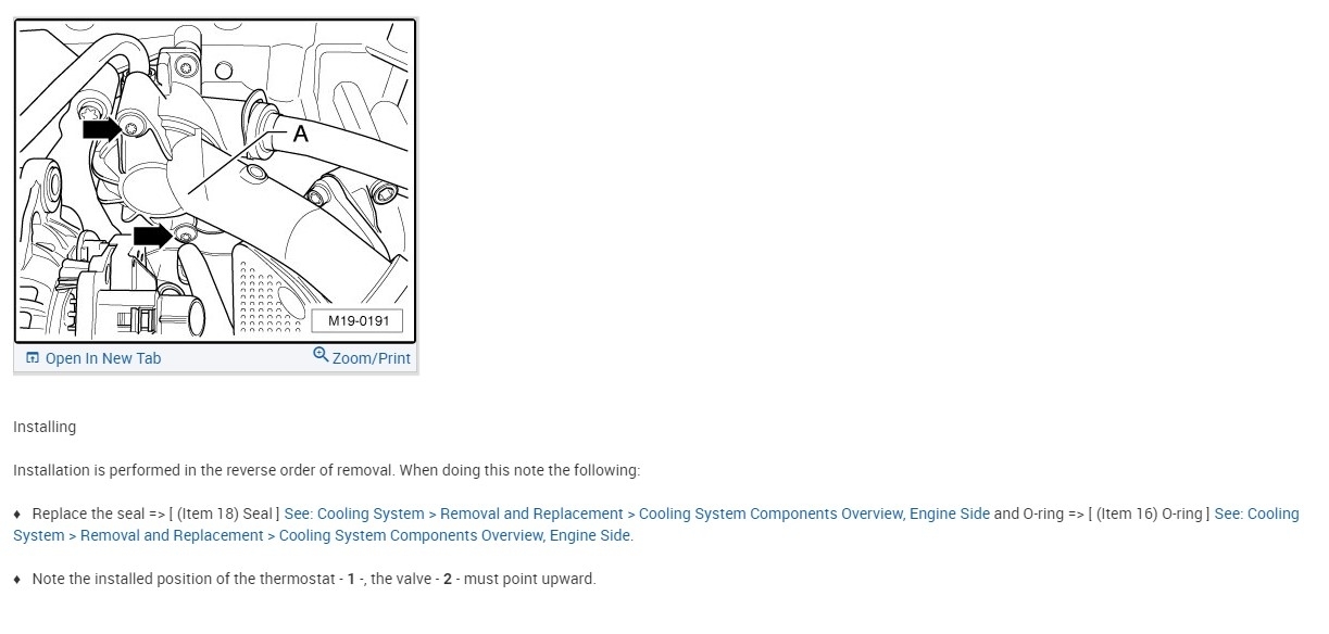

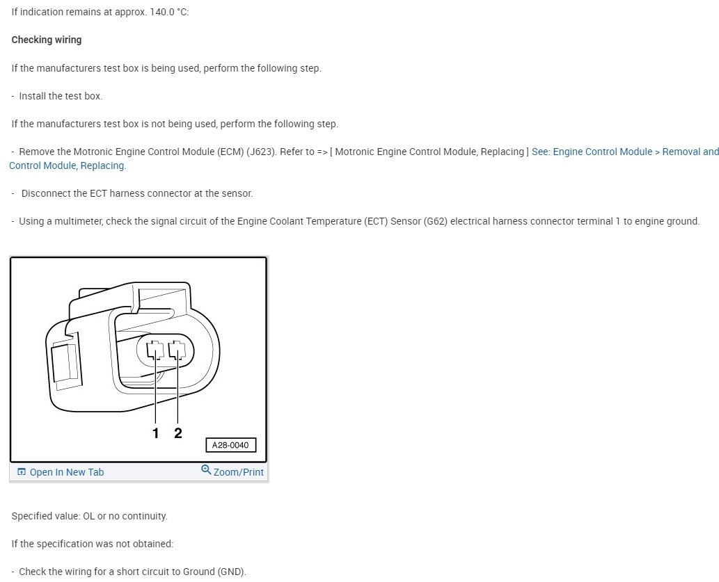

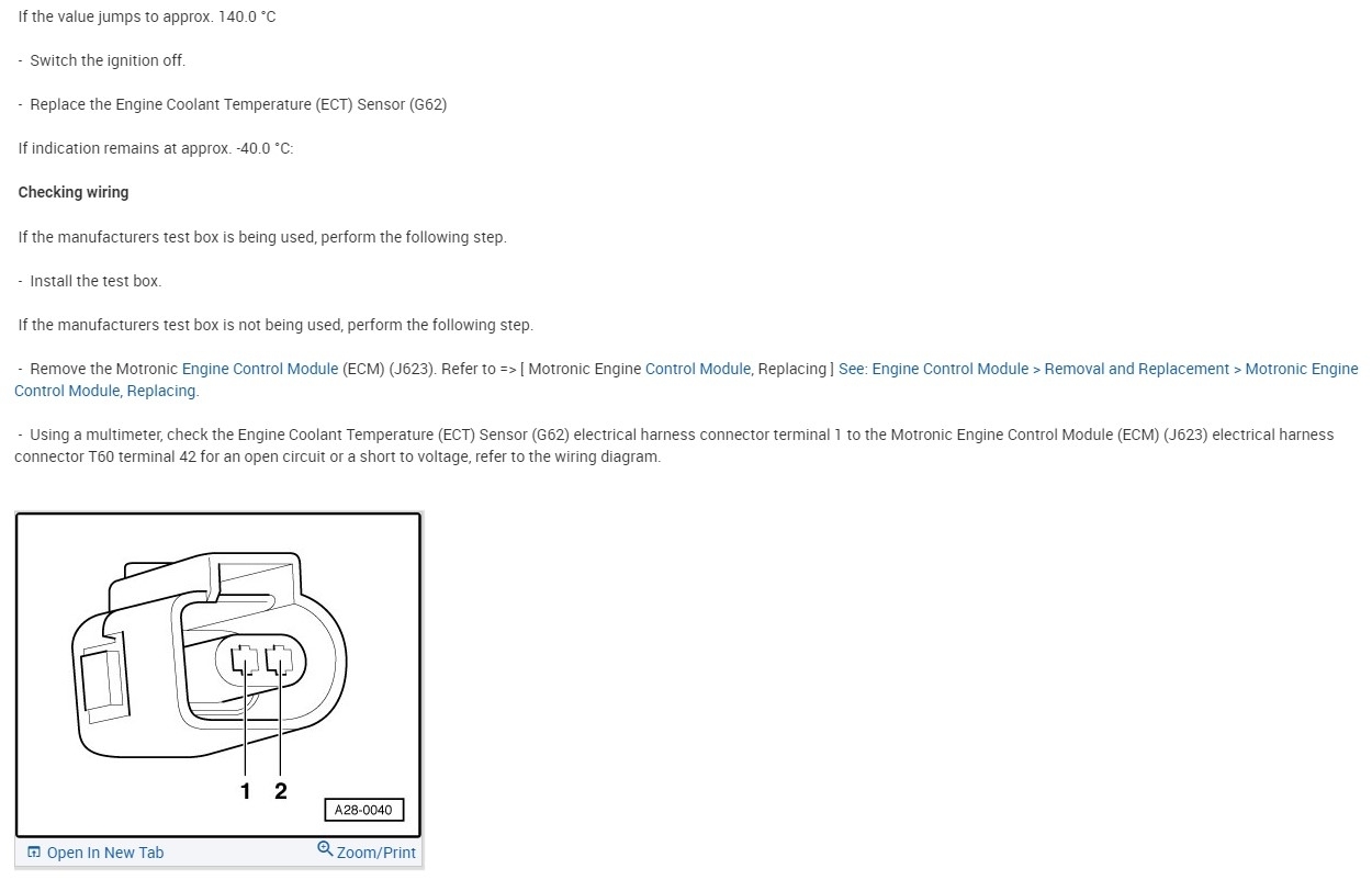

It seems like only one is a stored code, P2181, and the rest are pending codes.

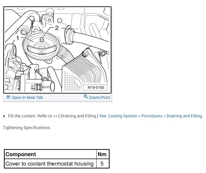

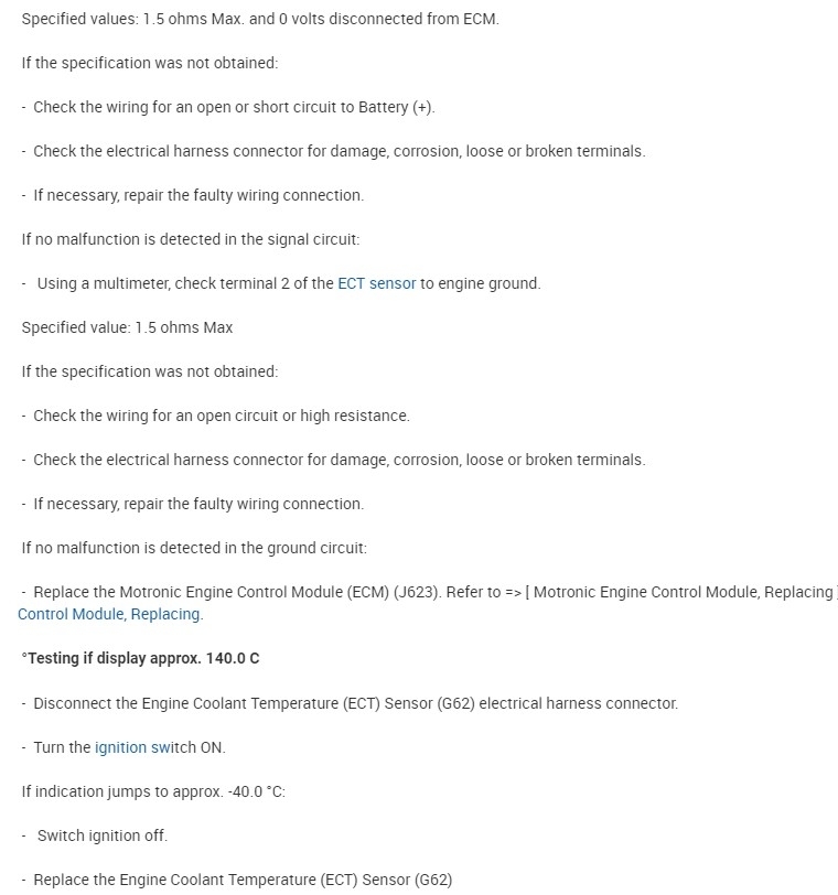

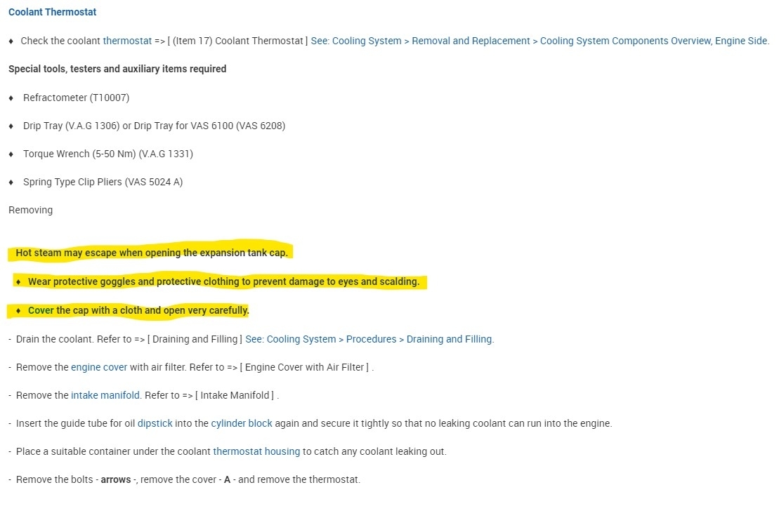

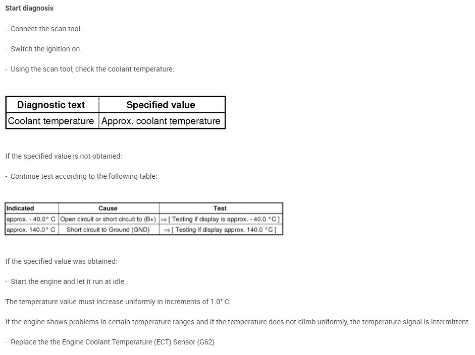

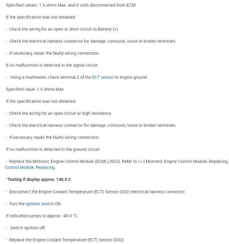

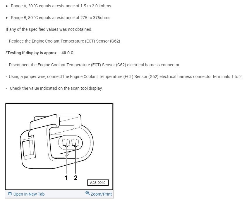

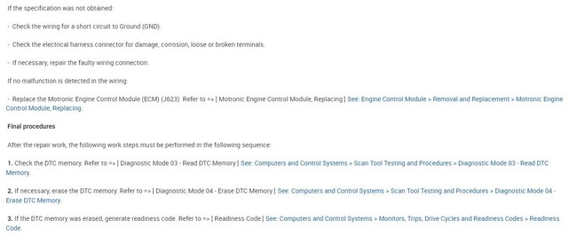

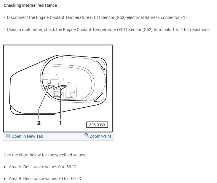

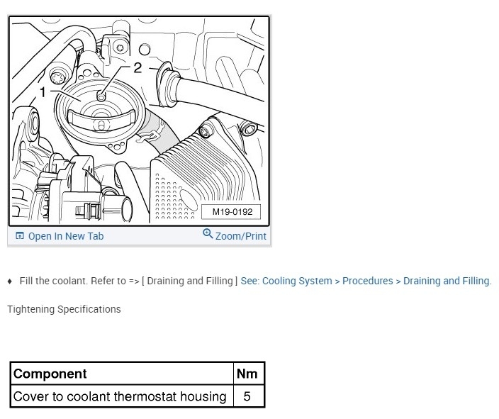

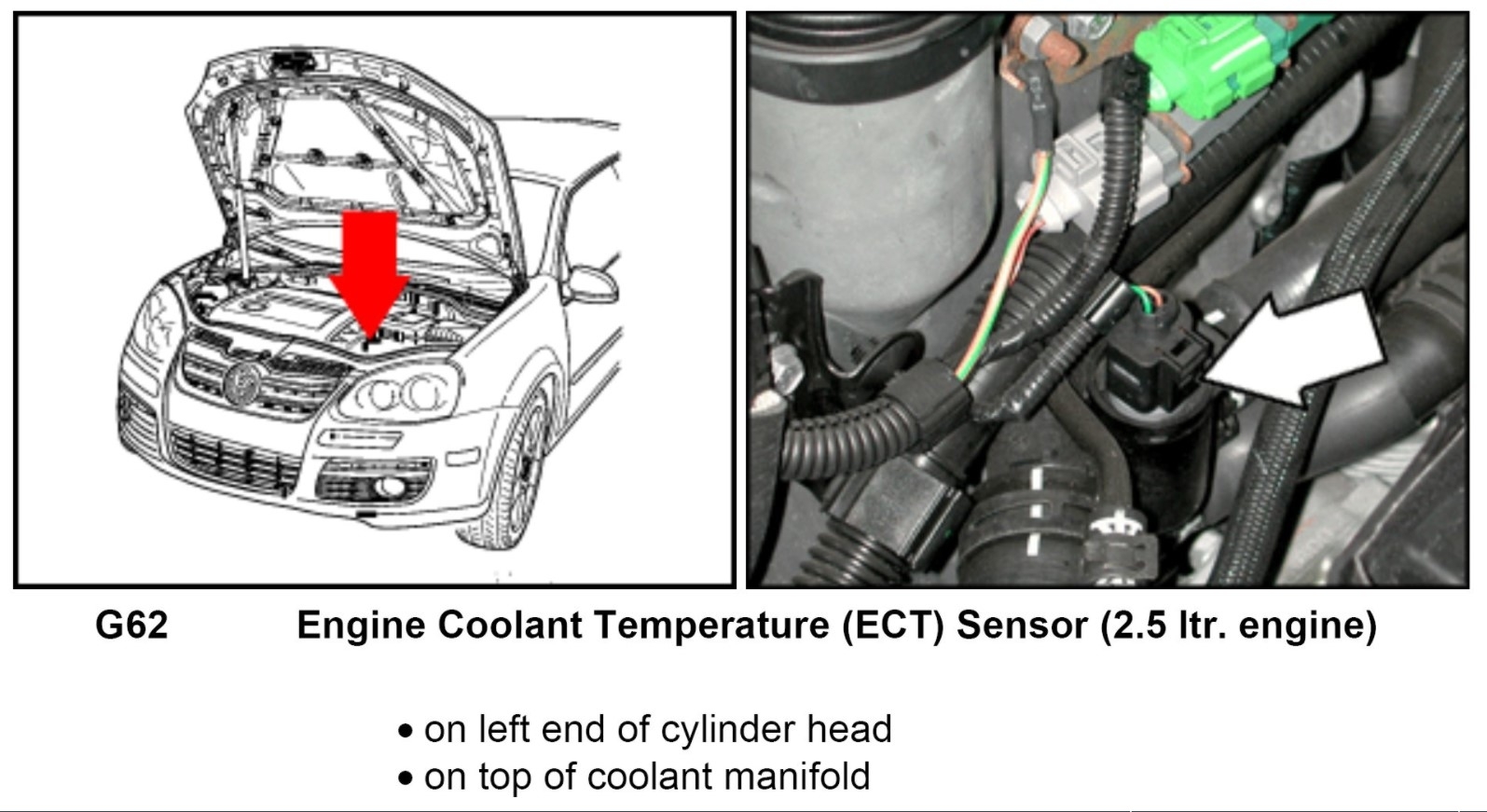

It might be a good idea to focus on the stored code first. I've attached the code description, possible causes, component locations, and repair procedures below. That particular code suggests there may be a fault with one of the engine coolant temperature sensors or with the thermostat. If there is a fault with one of these components, it could contribute to drivability issues.
Has the vehicle overheated recently, either before or after bumping into the other car?

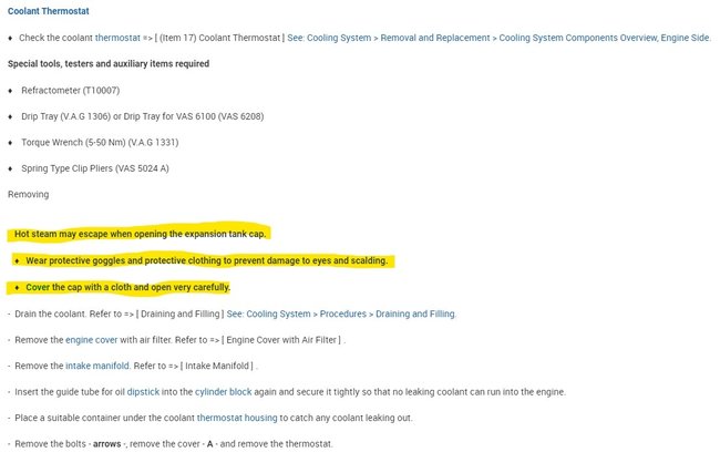

WENDY W
  • 86 POSTS
It sounds like the engine will crank but not start. Is that correct? Or will it not even crank?
If the vehicle's computer is not receiving accurate information from the sensors, it can cause the air/fuel ratio to be incorrect, and result in a no-start condition or running poorly.
If the thermostat has stuck open, it could prevent the engine from coming up to operating temperature, and that also could cause it to run badly but not necessarily prevent the vehicle from running.

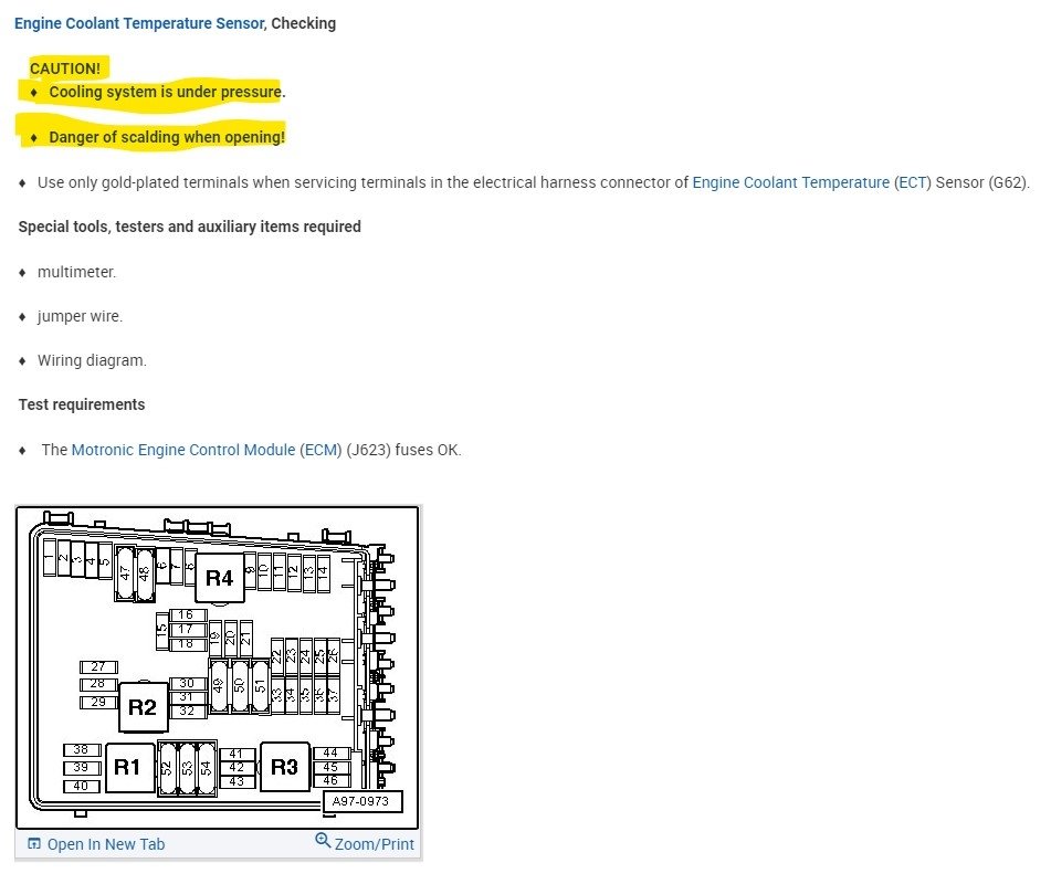

WENDY W
  • 86 POSTS

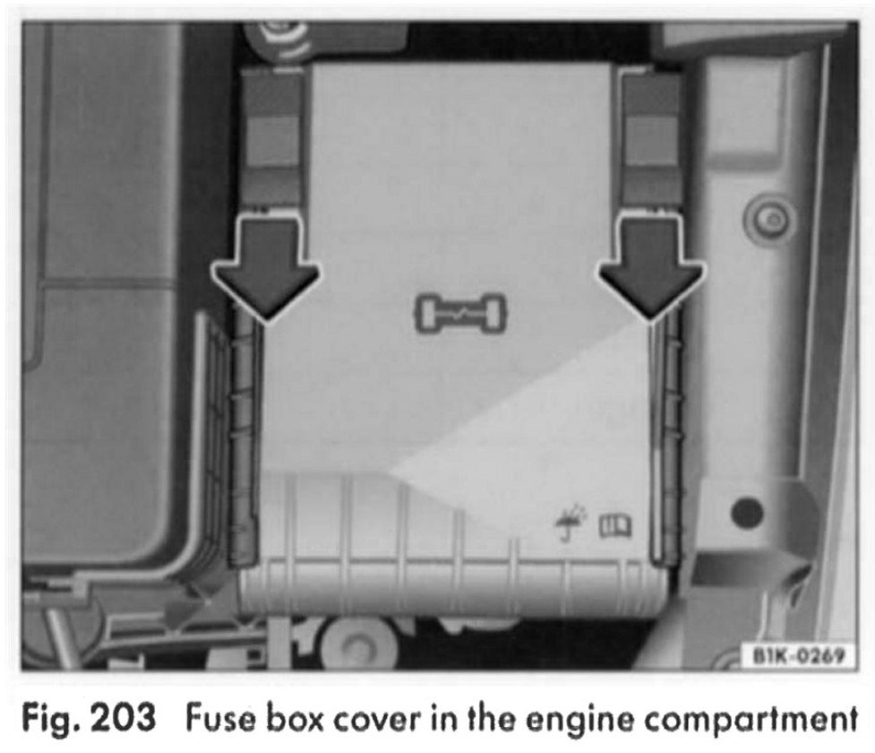

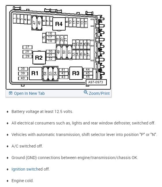

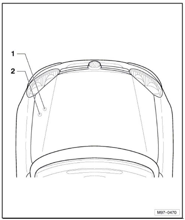

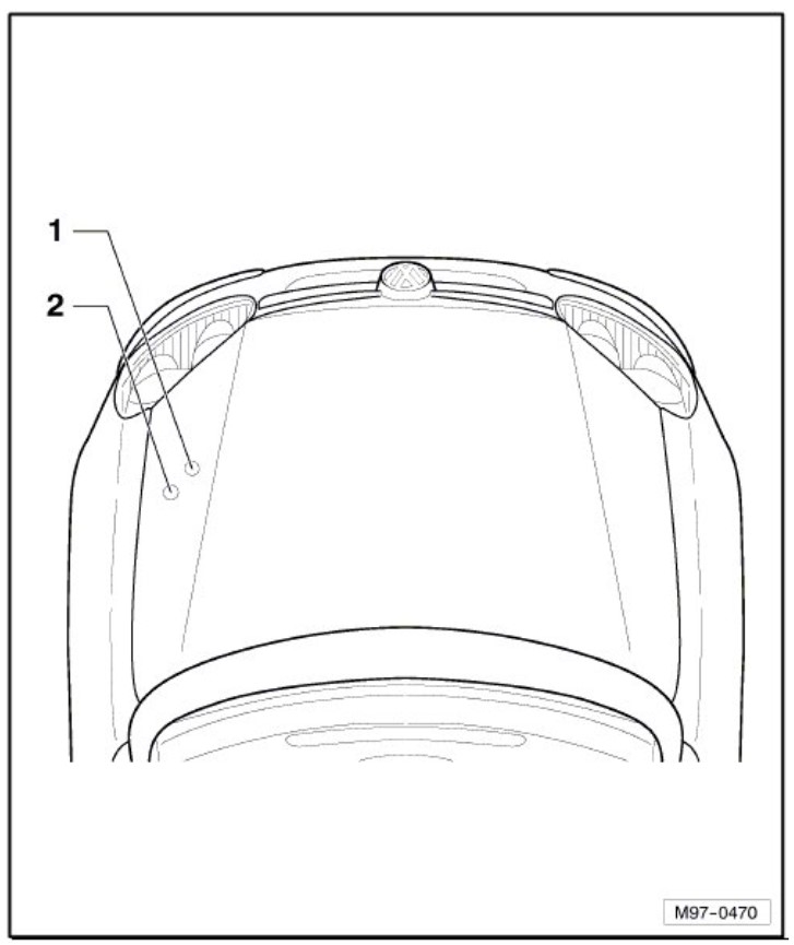

Okay, thank you. Have you been able to check the fuses in the interior and engine compartment fuse blocks? I've attached diagrams showing their location, below.
Thanks, Wendy
