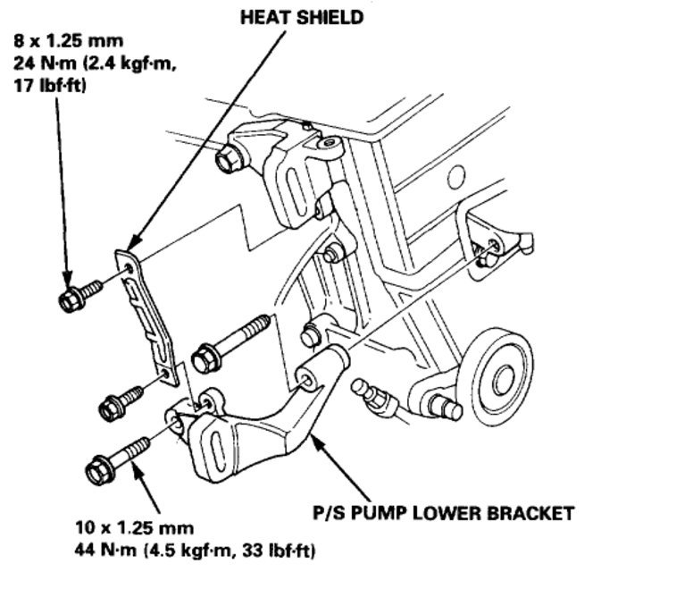

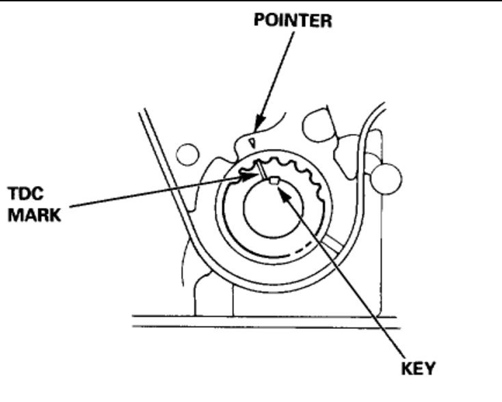

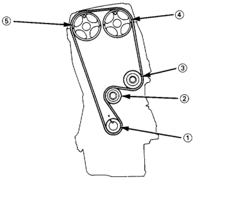

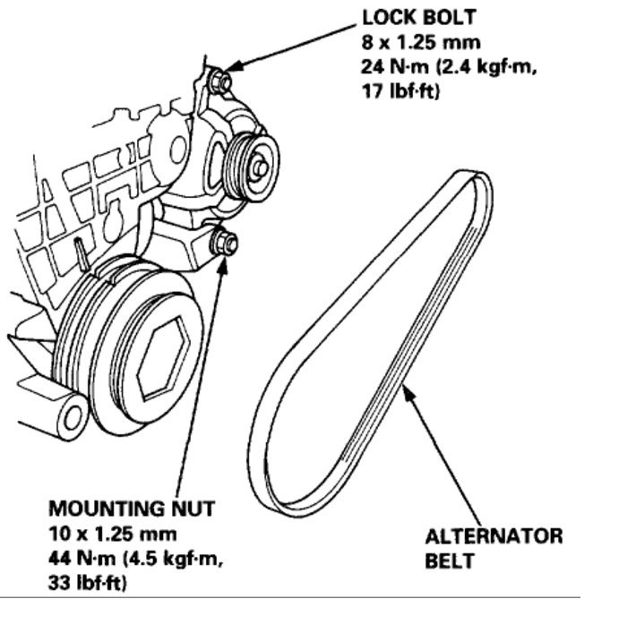

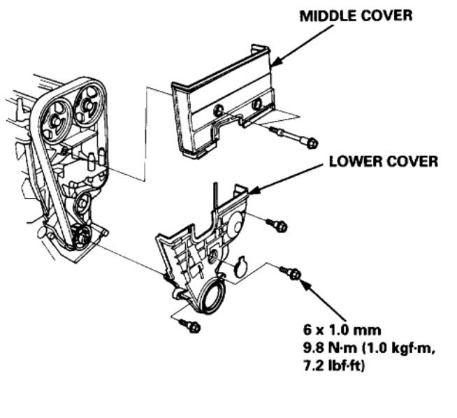

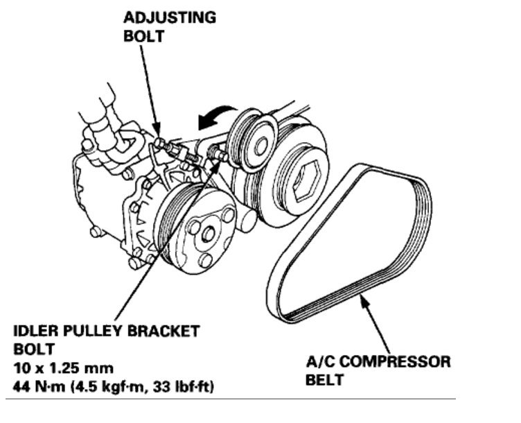

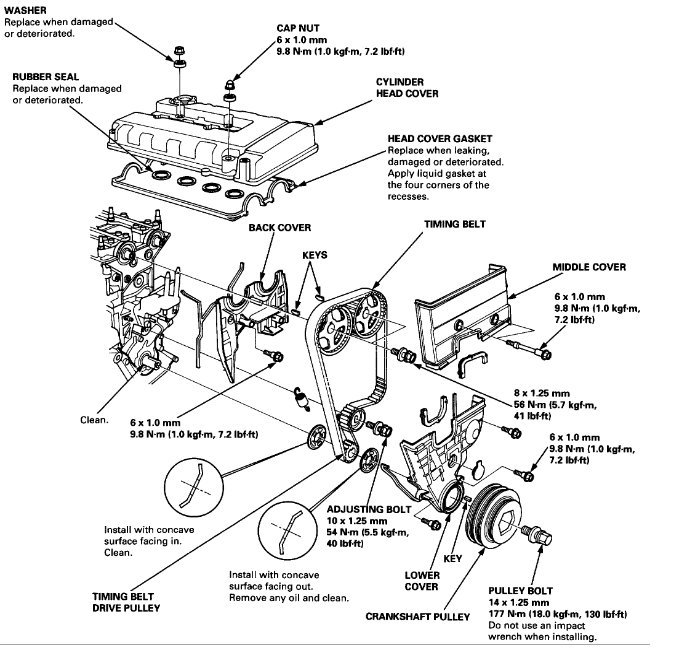

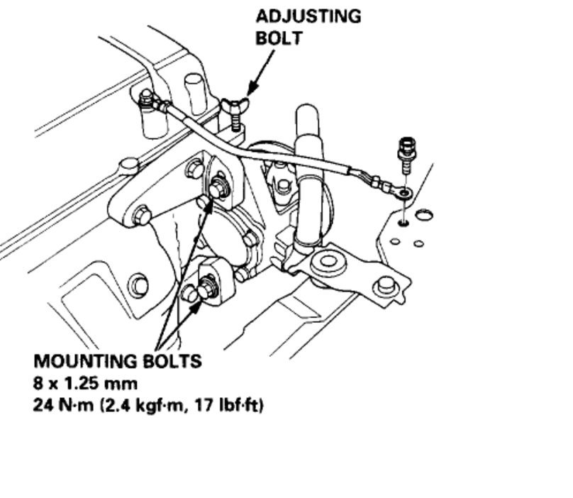

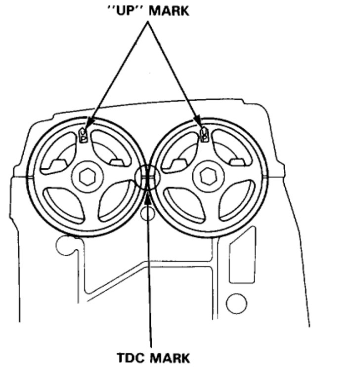

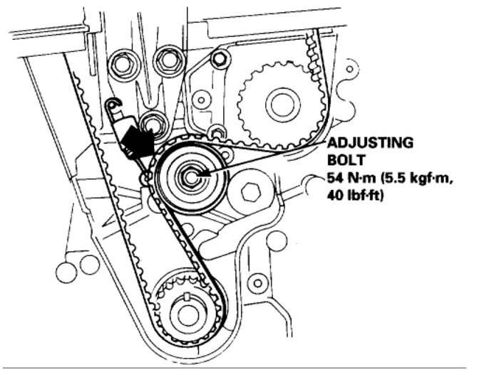

Hey BEE MAN2,
It sounds like the timing belt is off one tooth, can you remove the timing cover and check the cam timing?
Here is a guide to see if the mark are correct.
Please let us know happens so it will help others.
Best, Ken
