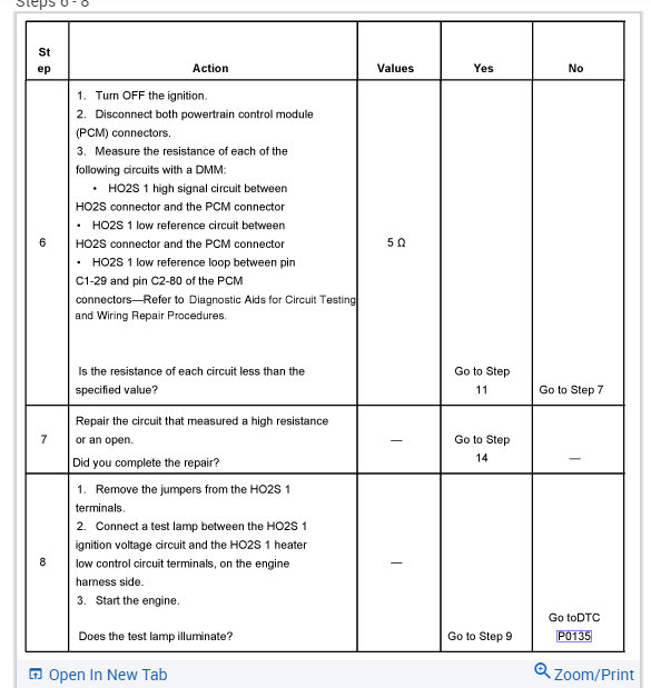

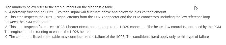

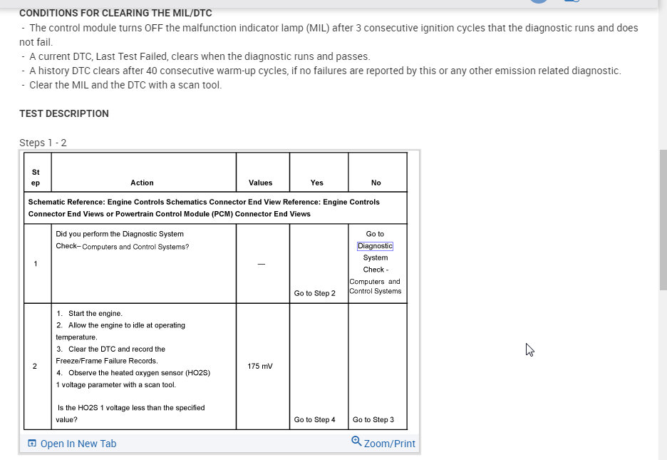

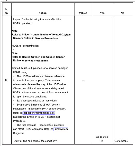

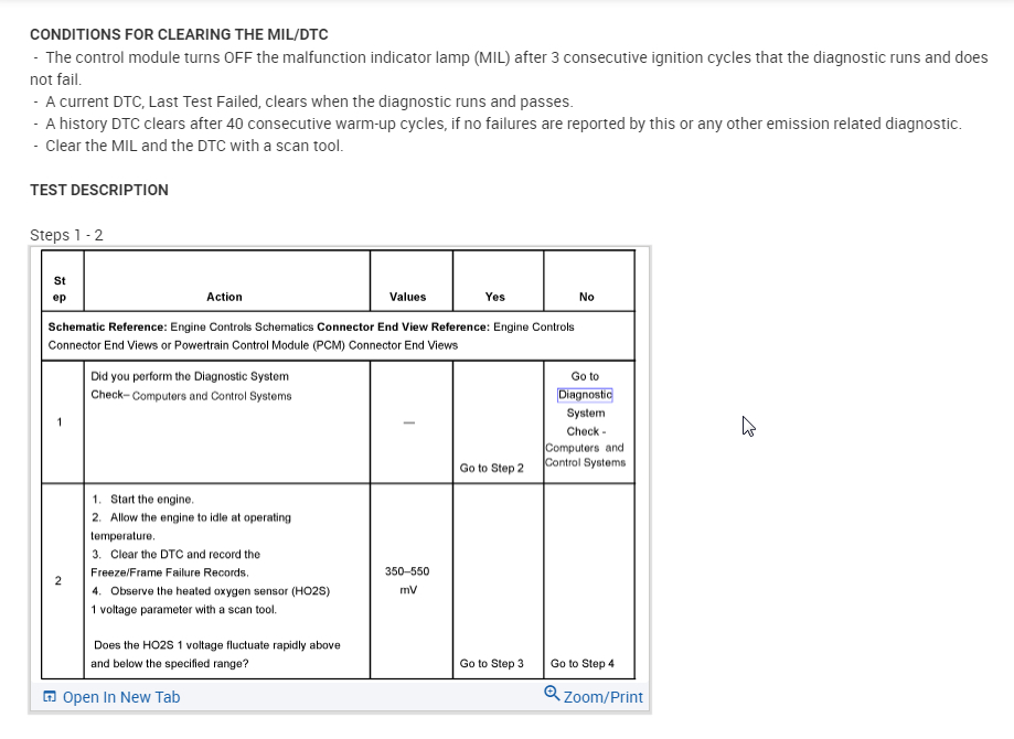

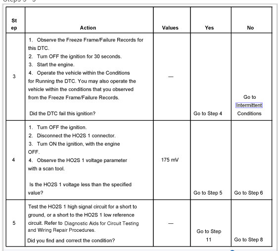

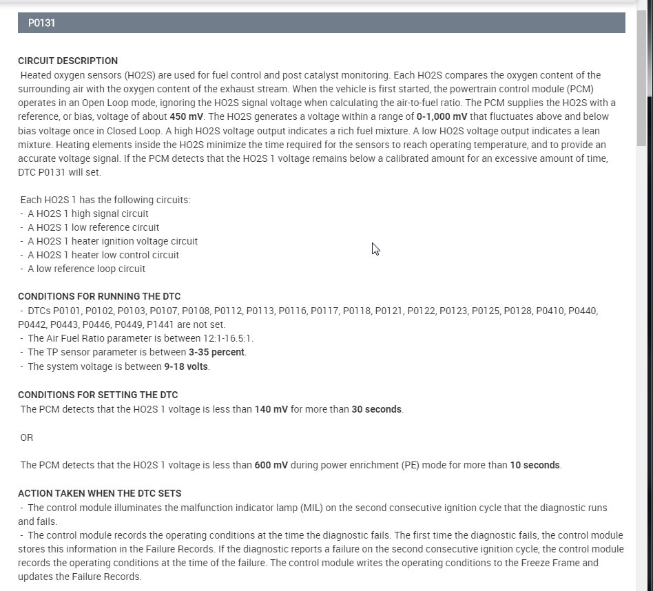

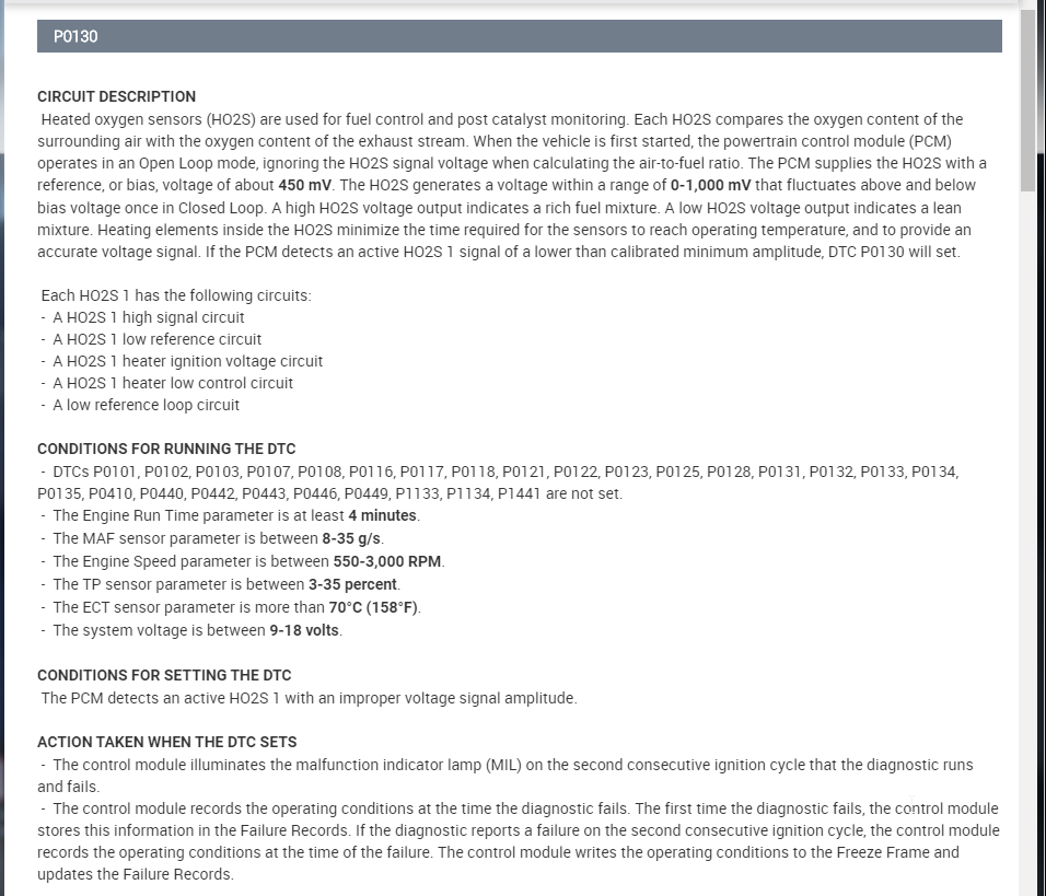

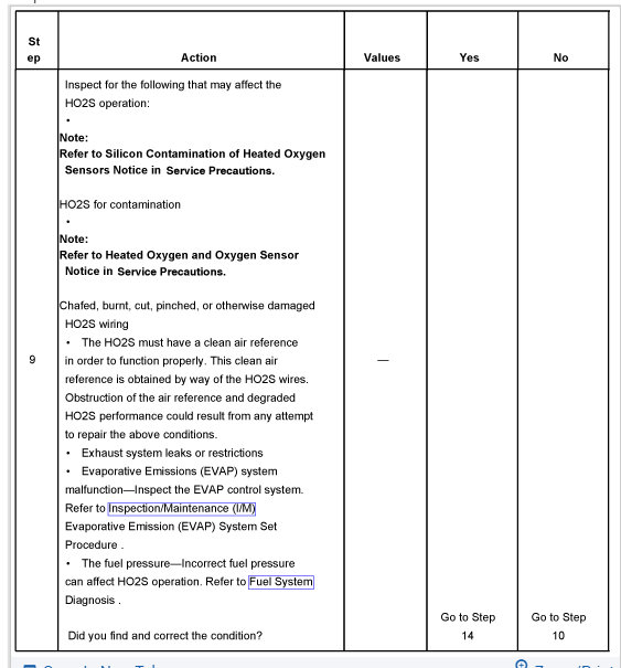

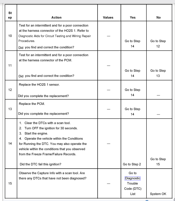

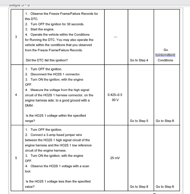

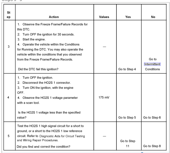

I checked transmission fluid level was okay, and clean. Recently I found a hole on the Air Cleaner Intake-PCV Valve Tube Hose 24508188, and replaced with new one, and replaced all 6 spark plugs. And running was okay without misfire. But old symptom of “hot-nutral-RPM surge high” still cause problem. Later I found thermometer increased near to the warning line after 20 minutes driving on the highway. Then, I suspected thermostat and replaced it, and had to disconnected one vacuum hose which connected to back of the engine, and throttle body. After restore all parts, when I start engine there was error code P0300-multiple misfire Detected. First time and car was vibrated abnormally, and engine service soon light turned on. After clear the error code when I start again the RPM surged from 400 to 3,000 rpm's. I start again and drove car out of garage, then there was high sounding like siren from two different sound scream source. I stopped soon. I found there was one more new error code added : P0131: oxygen sensor, circuit low voltage, bank1 sensor 1.
I think high surged RPM with high oxygen content caused oxygen sensor malfunction.
Now with two code P01300 and P0131 I do not know how to work on these issue. Thanks a lot for your expert review, instruction and help!
Saturday, July 18th, 2020 AT 10:02 PM

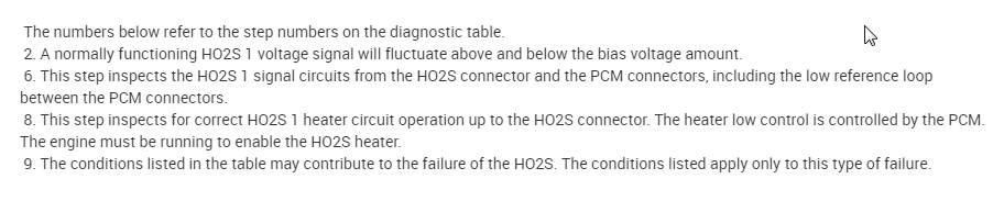

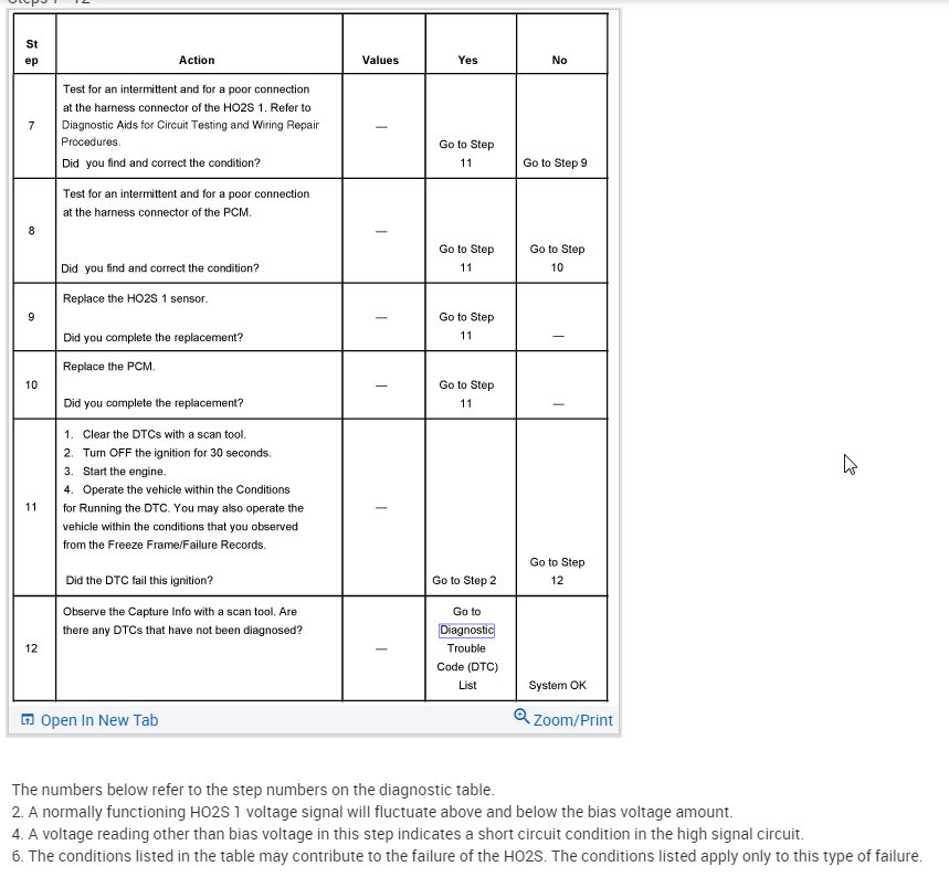

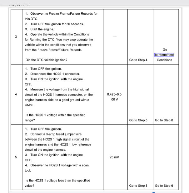

I attached the testing for these codes. You could be correct but these could also be a result of the misfire. Let's run through this testing and see what turns up. Both codes are basically for the same thing so I would think you only need to do one of them.
