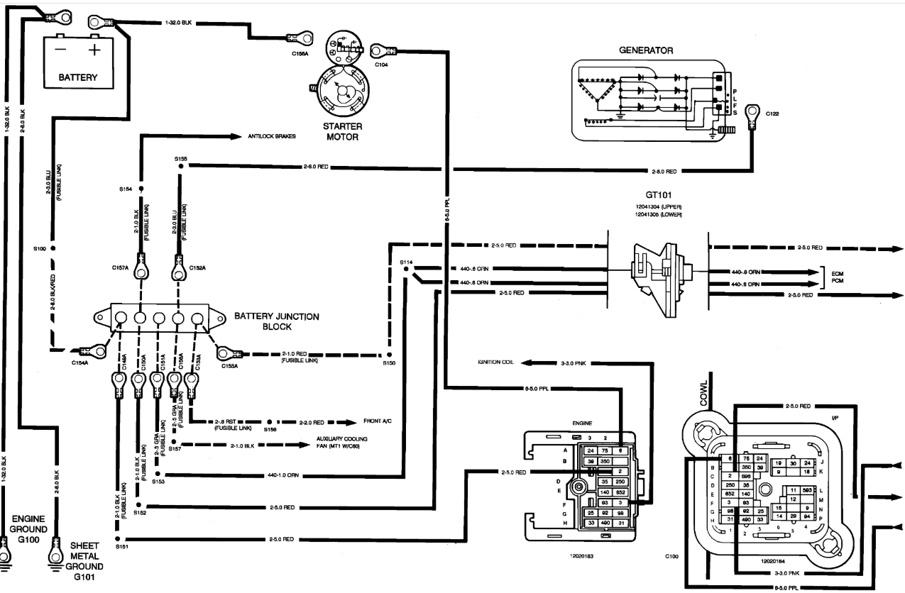

In column ignition switch wiring diagram needed
1993 CHEVROLET CHEYENNE
150,000 MILES • 6 CYL • 4WD • MANUAL
JULZAVEO
  • 8 POSTS

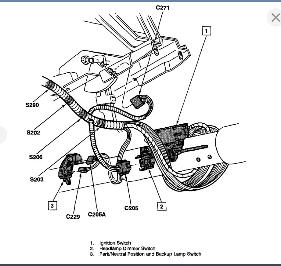

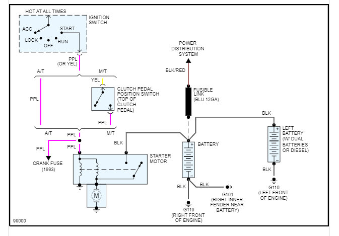

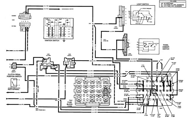

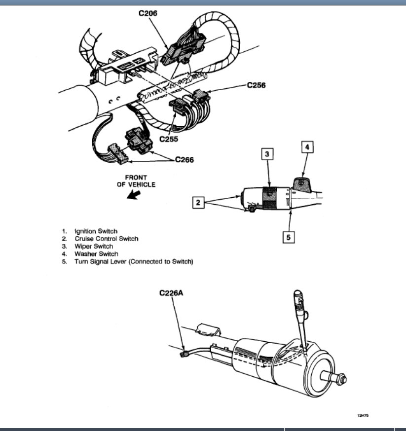

The switch is on the outside of column and one of the wires has come off and I need to know where it goes until I can order a new steering column to fix it. So I guess I'm needing the wiring diagram for it?
Dec 3, 2019 at 10:53 AM
Sure. I will attach the location of the harnesses and the wiring diagram that includes the ignition switch.
Here are a couple of guides that will help with this as well:
Please see the attachments and let me know if you have other questions.
May 27, 2022 at 11:52 AM
  • 55,433 POSTS
Here are the wiring diagrams for the ignition switch. Check out the images (below). Let us know how it goes.
