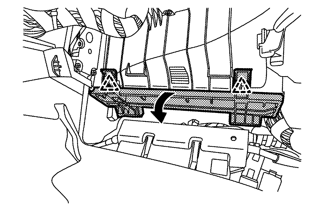

Hello! And thank you so much for your videos on YouTube, they are great! I wanted to ask if I can use the same filters on the QX30 and follow the same instructions as the GLA250 since they are very similar cars. I hardly find any videos with do-it-yourself instructions online for the Infiniti since it's not a very popular car, but there are tons of videos for the Mercedes. Thanks in advance!

Here are the directions for the cabin air filter specific to your vehicle. The attached pictures correlate with the directions.
______________________________________________
2018 Infiniti Truck QX30 FWD L4-2.0L Turbo
Air Conditioner Filter - Removal And Installation
Vehicle Heating and Air Conditioning Cabin Air Filter / Purifier Service and Repair Removal and Replacement Air Conditioner Filter - Removal And Installation
AIR CONDITIONER FILTER - REMOVAL AND INSTALLATION
Removal and Installation
REMOVAL
1. Disengage fixing pawls, and then remove filter cover.
NISSSWT0000000013550903-01-JMIIA4494ZZ
Pic 1
: Pawl

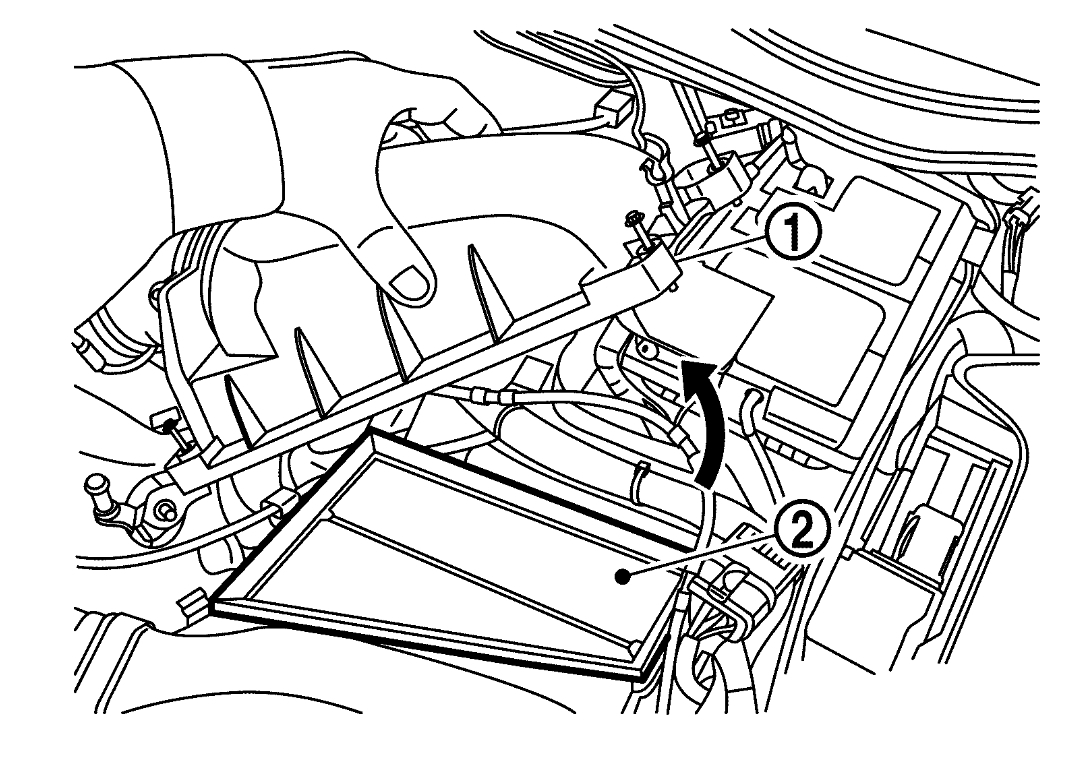

2. Remove air conditioner filter.
pic 2
NISSSWT0000000013550903-02-JMIIA4493ZZ
CAUTION:
If the filter is deformed/damaged when removing, replace it with a new one. Deformed/damaged filter may deteriorate the dust collecting performance.
INSTALLATION
Note the following item, and then install in the reverse order of removal.
CAUTION:
When installing, handle the filter with extreme care to avoid deforming/damaging.

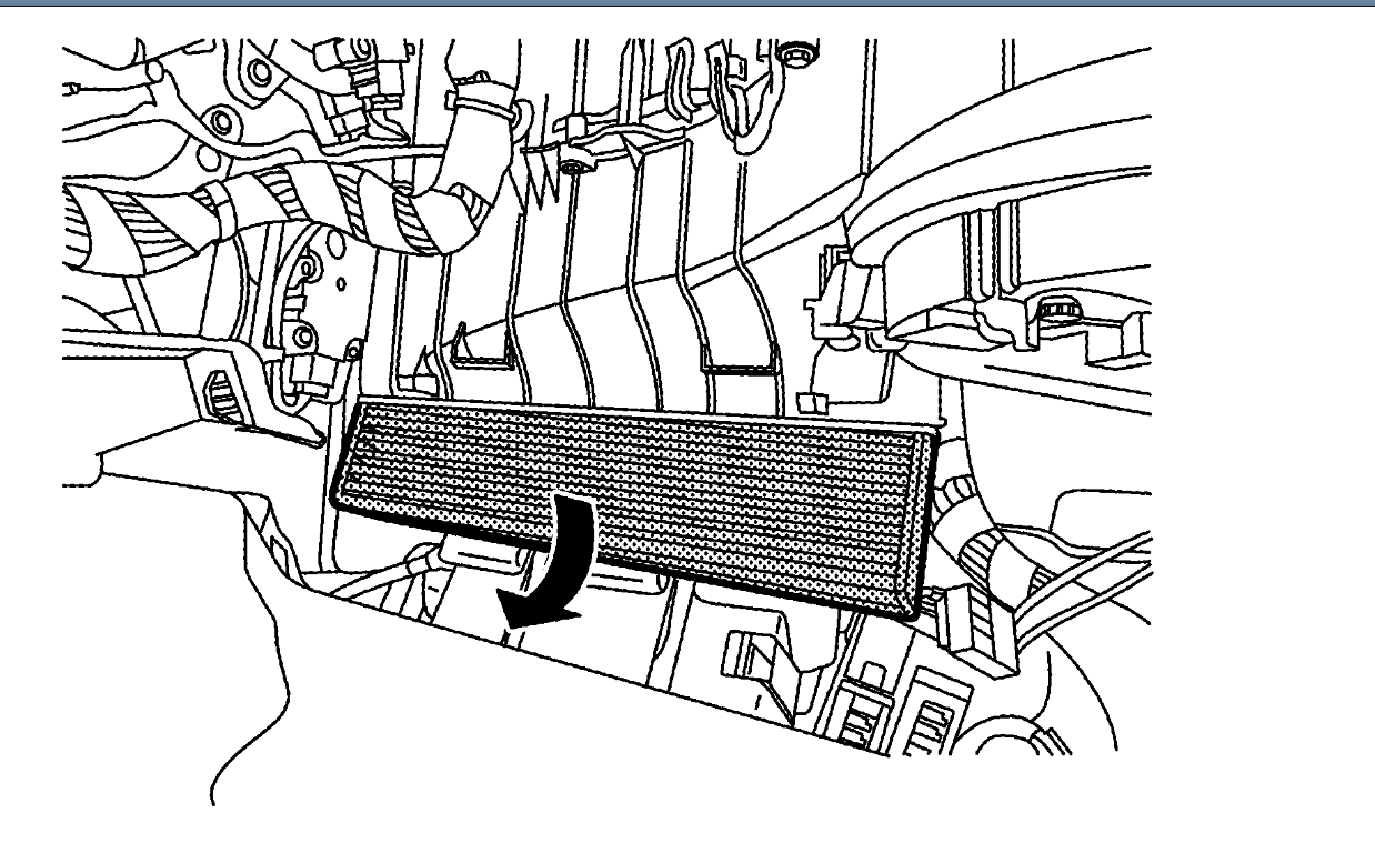

Here are the ones specific to your vehicle's engine air filter.
Air Cleaner Filter (2.0L Turbo Engine) - Removal And Installation
Vehicle Powertrain Management Fuel Delivery and Air Induction Air Cleaner Housing Air Filter Element Service and Repair Removal and Replacement Air Cleaner Filter (2.0L Turbo Engine) - Removal And Installation
AIR CLEANER FILTER (2.0L TURBO ENGINE) - REMOVAL AND INSTALLATION
REMOVAL
1. Remove engine cover. Refer to Removal and Installation
2. Remove vacuum tube from clamps image.
pic 3
NISSSWT0000000013536860-01-JSBIA9533ZZ

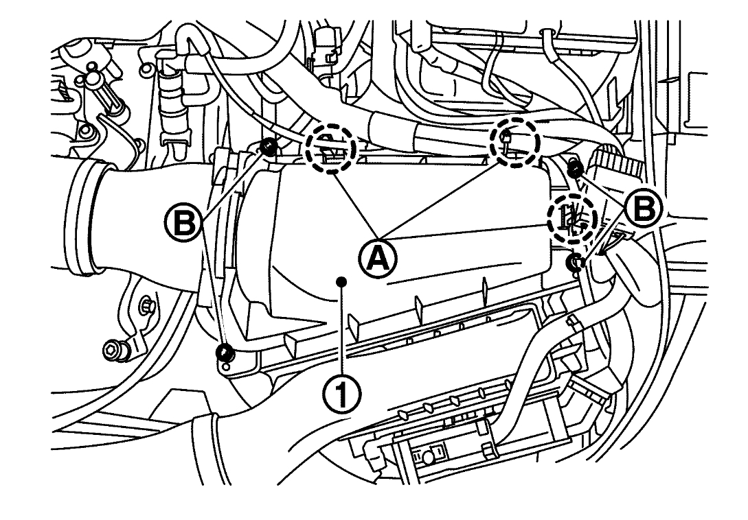

3. Loosen air cleaner housing cover mounting bolt image.
image NOTE:
The bolts remain the air cleaner housing cover image.
4. Pull up air cleaner housing cover image and remove air cleaner filter element image.
pic 4
NISSSWT0000000013536860-02-JSBIA9534ZZ
INSTALLATION
Note the following, and install in the reverse order of removal.
image NOTE:
Clean the inside of air cleaner housing and the air cleaner housing cover.
