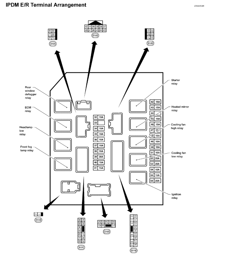

went into shop came out inserted my key car would not start plugged in my reader says mobiliser malfunction codep1610. traction control spinning circuit. u1000 fault in can communication circuit. p1612 immobilizer ECM communication error.

Here are what the codes mean:
U1000: This is a generic DTC that indicates a communication fault in the network between various control modules in the vehicle.
P1612: This code specifically relates to the Immobilizer Control Module (ICM) in the vehicle. The ICM is responsible for preventing the engine from starting if the correct key is not used.
The P1610 code is a diagnostic trouble code that is related to the Engine Control Module (ECM) in a vehicle, this code indicates a problem with the Immobilizer system

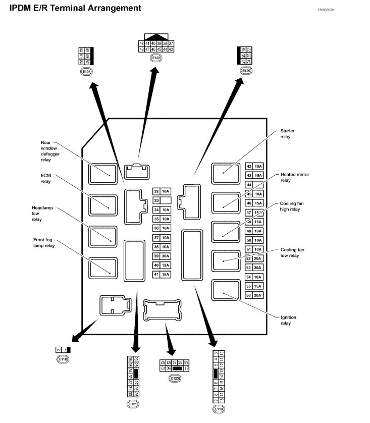

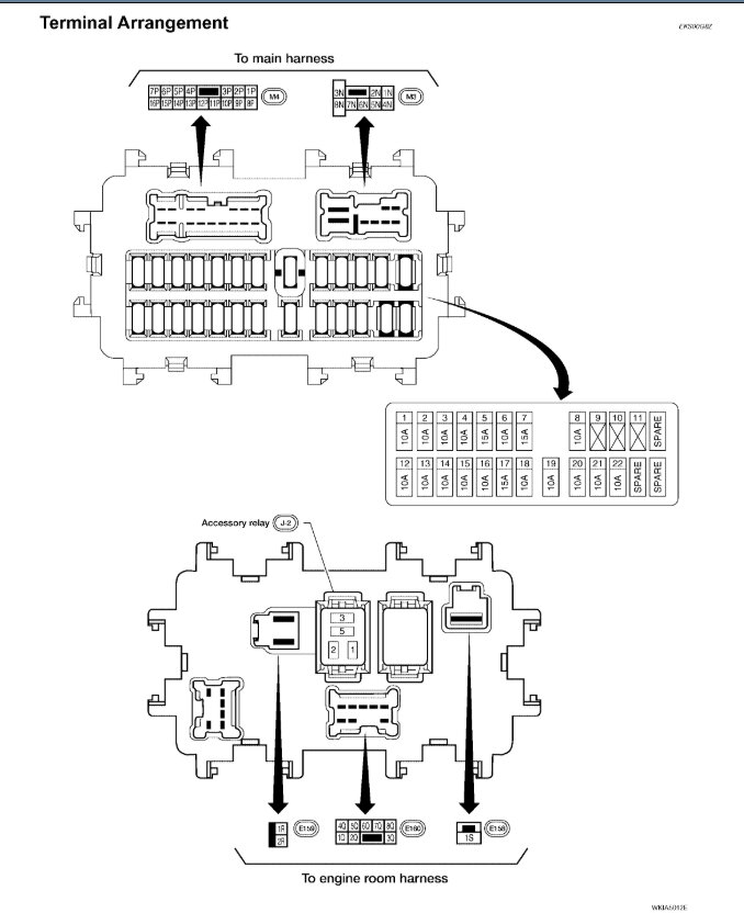

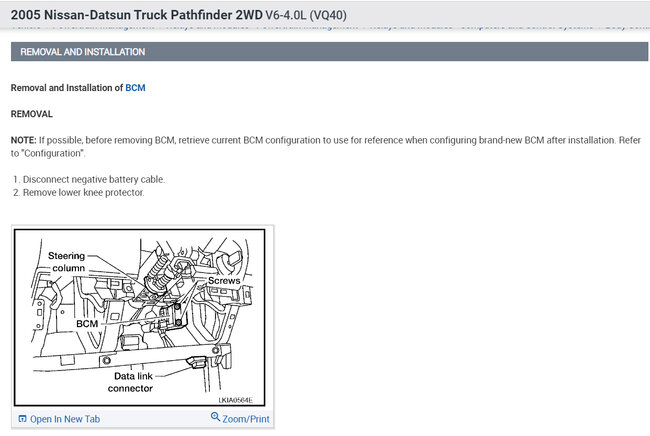

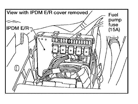

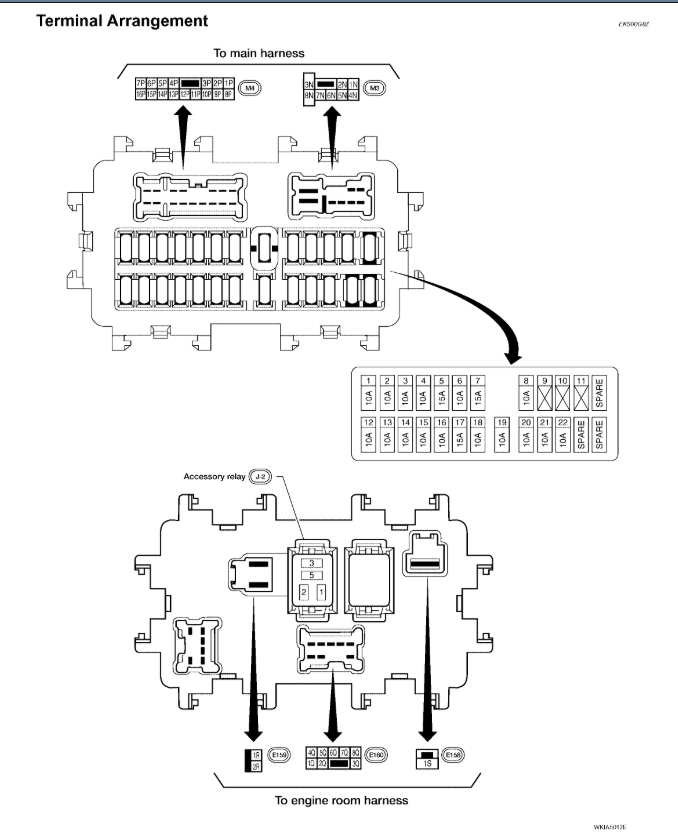

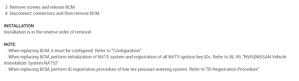

So, both of these codes can be caused by a bad BCM which controls the Immobilizer system. First, I would check all of the fuses with the key on.
If the fuses are okay, I would replace the BCM, you can get a preprogrammed unit by searching Google or Ebay. Check out the images (below). Please let us know what happens.
