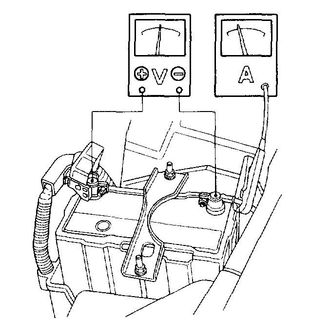

Immobilizer will not connect to car. Light on button goes but car still will not start. Has new battery I just do not know why. Can some one please help?

Hi and thanks for using 2CarPros.com These problems can be a nightmare. Here are no start directions from Alldata. I also attached the pictures which correlate with these directions.

Hook up the following equipment:
Ammeter, 0 - 400 A
Voltmeter, 0 - 20 V (accurate within 0.1 volt )

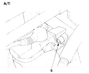

Make sure the transmission is in neutral, then disconnect the BLK/WHT wire from the starter solenoid S terminal. Connect a jumper wire from the battery positive terminal to the solenoid terminal.
Did the starter crank the engine?
YES - Go to step 7.
NO - Remove the starter, and repair or replace as necessary.

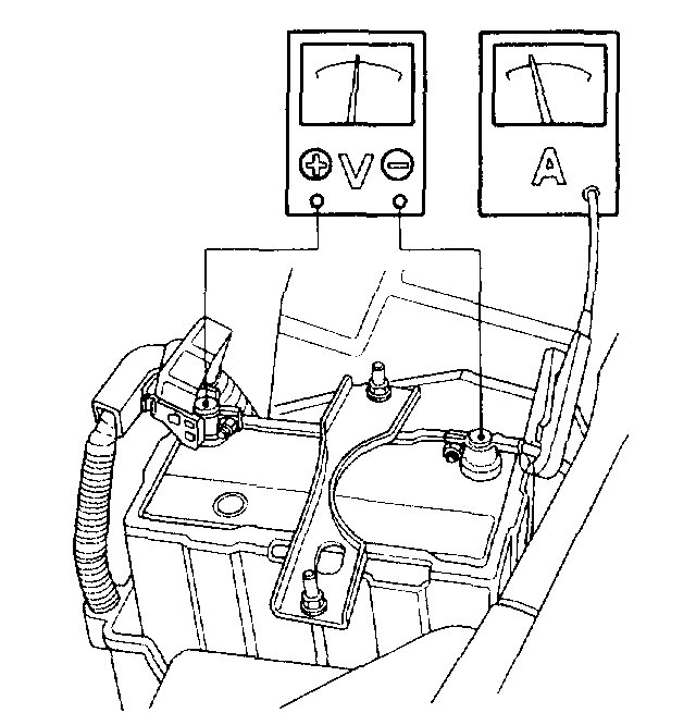

While cranking the engine, check the cranking voltage and current draw.
Is cranking voltage greater than or equal to 7.7 V (M/T)/8.5 V (A/T) and current draw less than or equal to 400 A (M/T)/380 A (A/T)?
