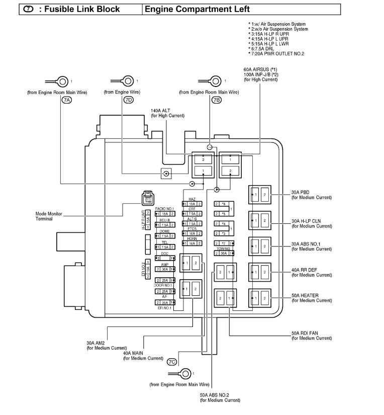

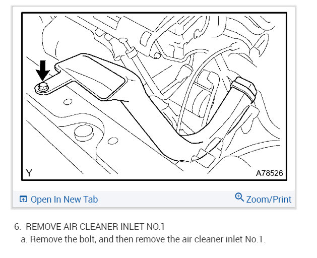

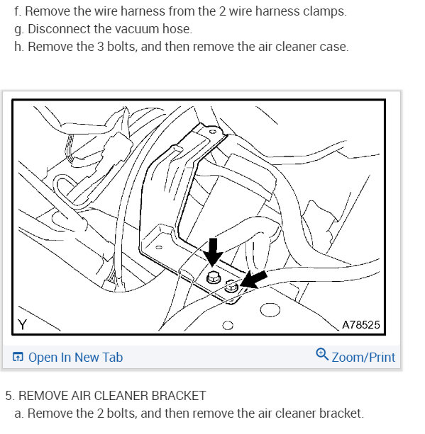

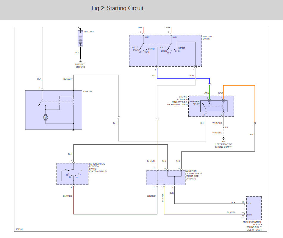

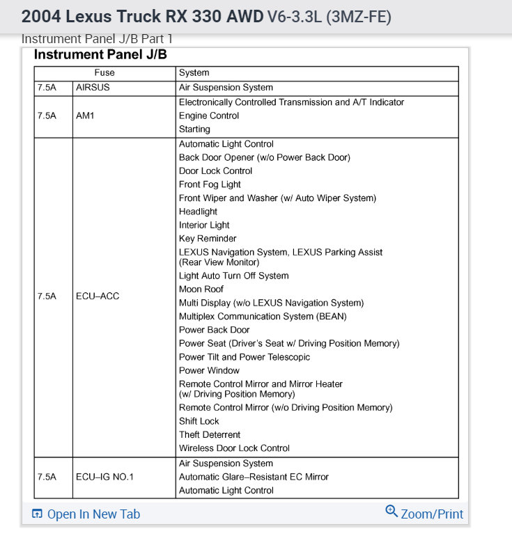

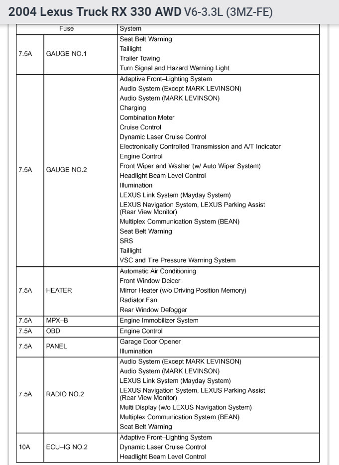

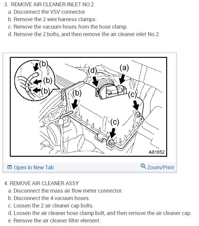

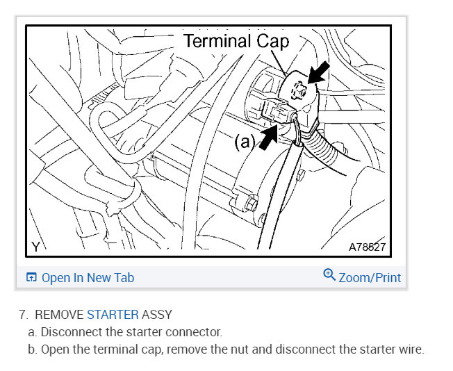

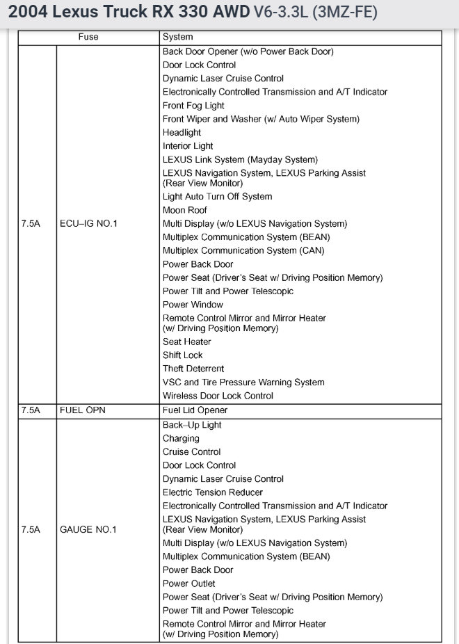

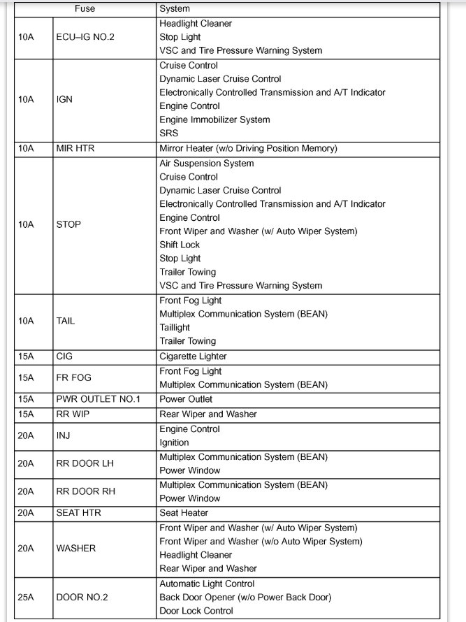

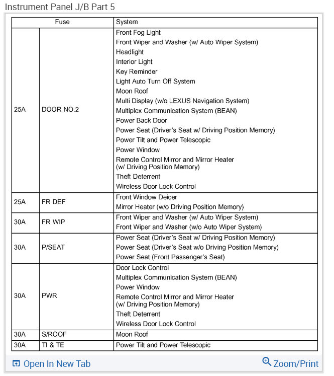

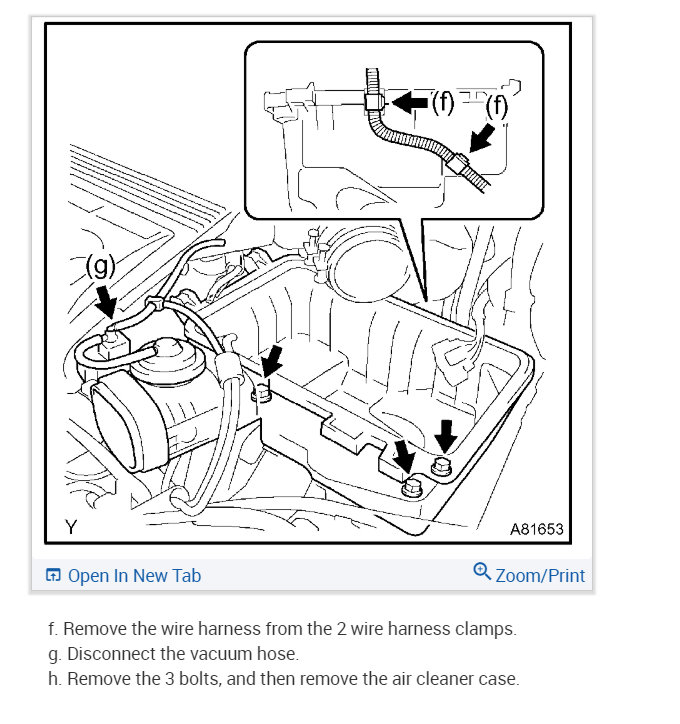

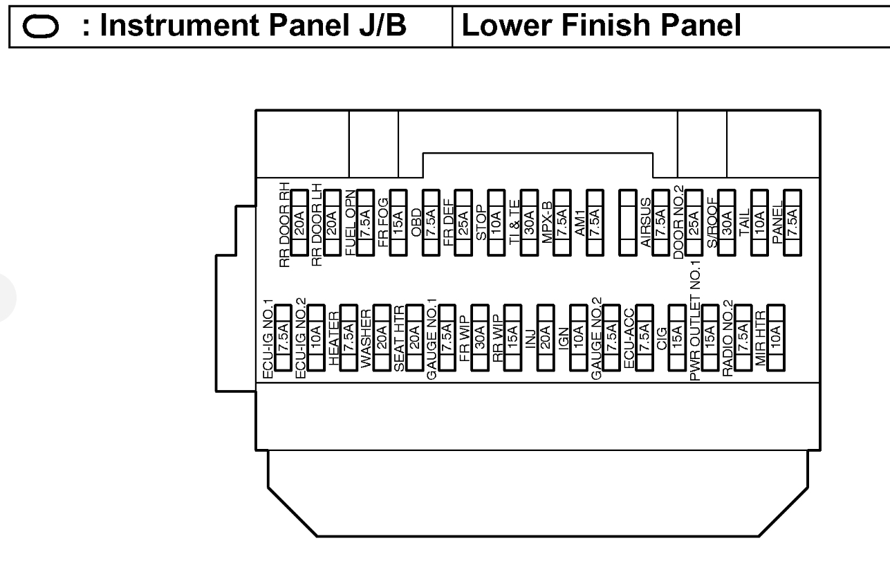

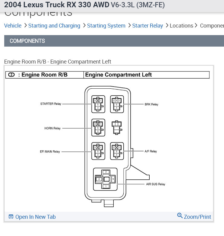

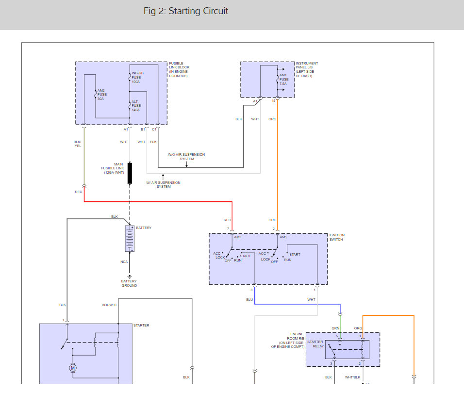

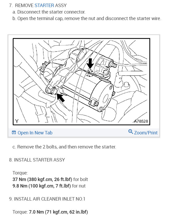

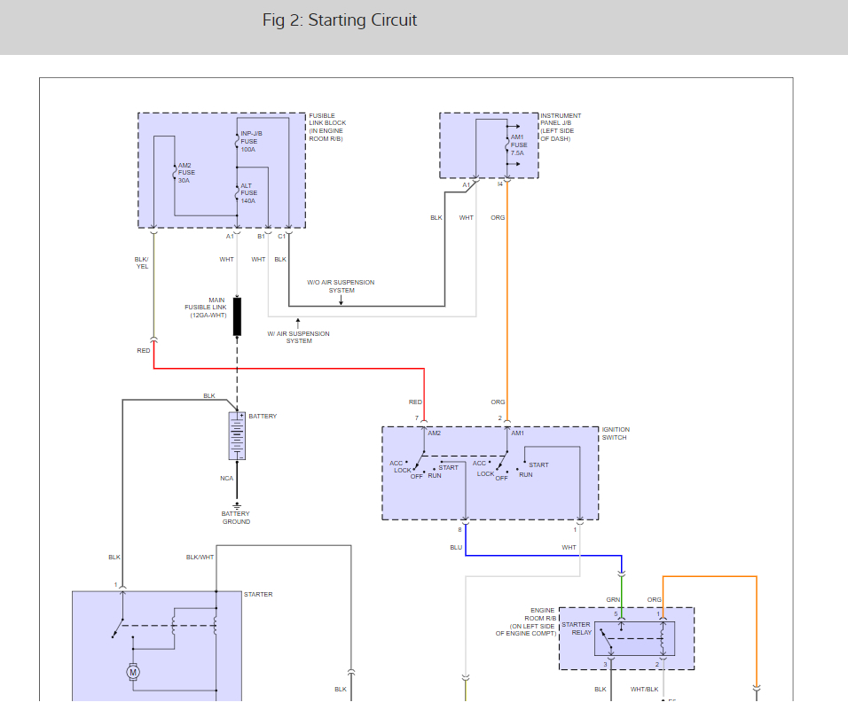

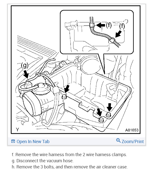

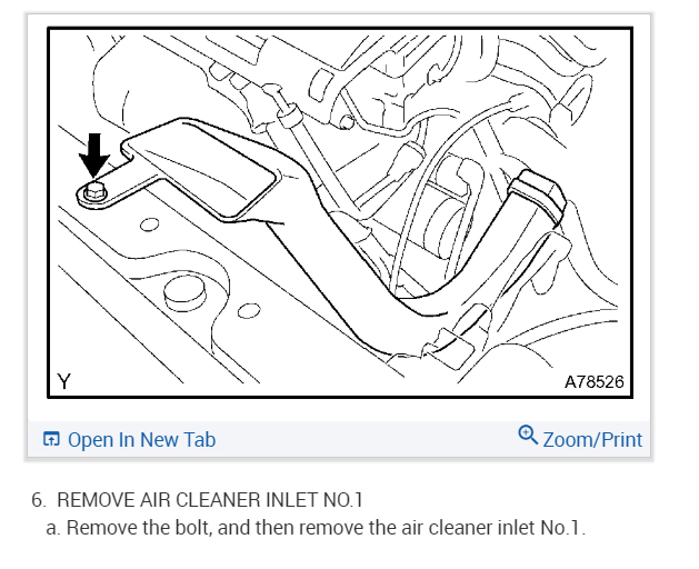

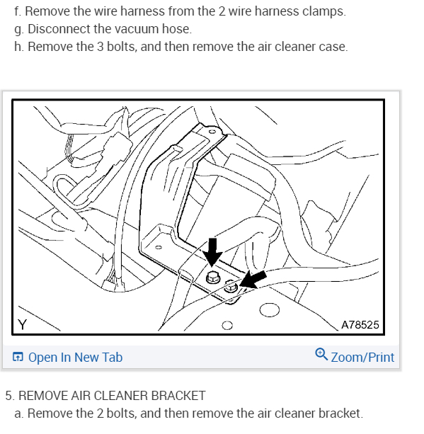

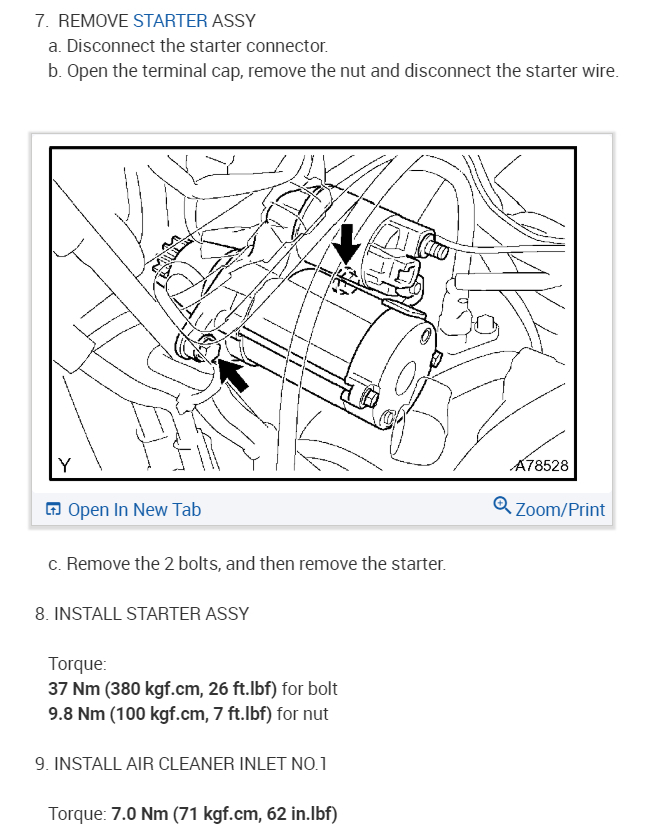

If the security light is not flashing the system is disabled and we have another issue like the starter or starter relay went out. but to be sure lets run down this guide. I have included the starter wiring diagrams and fuse and relay location so we can get it fixed. Lets check the fuses as well, # AM1 fuse in the fuse panel.
and

I was told the only so many keys can be programmed to a Lexus and I only received one previous owner so I was told I must have added too many keys and have a locksmith clear out the keys and add the ones that I had. I had it towed to a master key shop in Portland Oregon, AA Express locksmith. They cleared out the computer and added my keys but the car still would not start. From there I had it towed to Integrity Auto Repair who only deal with Toyota Lexus and Scion. Sorry I only mention these folks by name because they did an awesome job, the locksmith didn't even charge me for the work he did. It did turn out to be the starter. Totally shocked because it did not make a noise that the starters usually make when they're going out. It even started a couple times before completely shutting off. It is now running awesome I should get at least another couple hundred thousand miles out of it and I thank all for their help.
