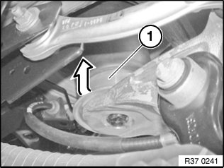

After some time being parked my car goes down about 4 inch and on starting up I hear a loud noise (compressor ) and the noise stops after the car is completely lifted (about 30 seconds or so), also while driving I hear it turning on sometimes for a few seconds.

Replace both rear air bags and air compressor (left rear air bag suspension leaking and compressor overworking ). $ 3,000.00.

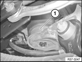

As far as the lower control arm bushings, that is really based on how bad they are. Do you hear any clunking or having any steering issues? Also, if the compressor is being overworked, why can't the just replace the airbag to prevent it from happening or has the compressor gone bad as well?

Regarding arm bushing; no clunking or steering issues however once left side of a car would not lift completely (not sure is it related to the arms), but I got a warning (yellow sign) on the dash board that ride might be uncomfortable and not to go fast in the corners.

1. looks like compressor is fine (overworked which make sense if there's a leak but nothing wrong with it).
2. arm bushings are worn apparently. how long do you think I got? and how fast should I dead with them/how much damage can they do if I don't focus on the at the moment.
3. airbag seems to be the issues and if you think airbag could be replaced alone could I just take care of airbag for now?

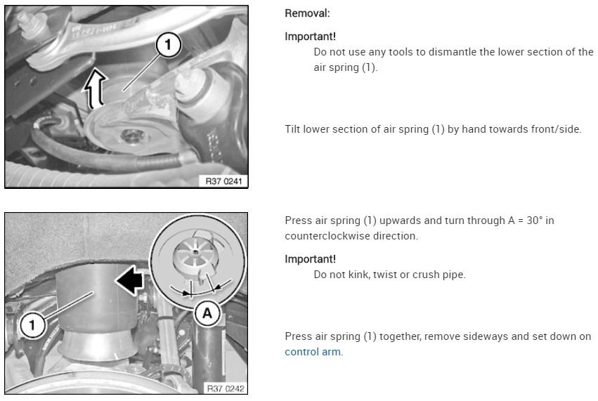

Here is a run down of the removal in the images below review it to see if you feel comfortable.

Yes back of the car is low after being parked few hours (low rider pretty much), front is good, then at start a loud compressor noise until the car is lifted.
while driving it will also kick in and make the noise here and there.
It does seem like I wont be going thru the dealership, I looked over the YouTube a bit as well and I went ahead and ordered a pair of rear suspension air bags (cost me $105.00 on Autoshack), I might even have the tools needed to reach and replace them (YouTube made it look simple, lol).
I think I might start with airbags and that should stop the air compressor from being overworked for one and hopefully solves my issue for now.(they did told me it was a suspension leak a the dealer)
regarding front lower control arm bushings, I do not have any noise or any issues described so I might be okay for now but definitely keep an eye on it and replace them soon. (Because they also mentioned they are worn/loose)
I guess that's my game plan for now.

I think that is a good plan. I don't know if you want the directions for replacing the air spring / bags, but figured I would add them in case you do. The attached pics correlate with the directions.

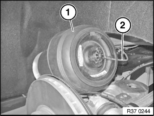

Remove rear wheel
Pic 1
Removal:
Important!
Do not use any tools to dismantle the lower section of the air spring (1).
Tilt lower section of air spring (1) by hand towards front/side.

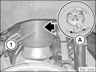

Pic 2
Press air spring (1) upwards and turn through A = 30° in counterclockwise direction.
Important!
Do not kink, twist or crush pipe.
Press air spring (1) together, remove sideways and set down on control arm.

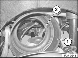

pic 3

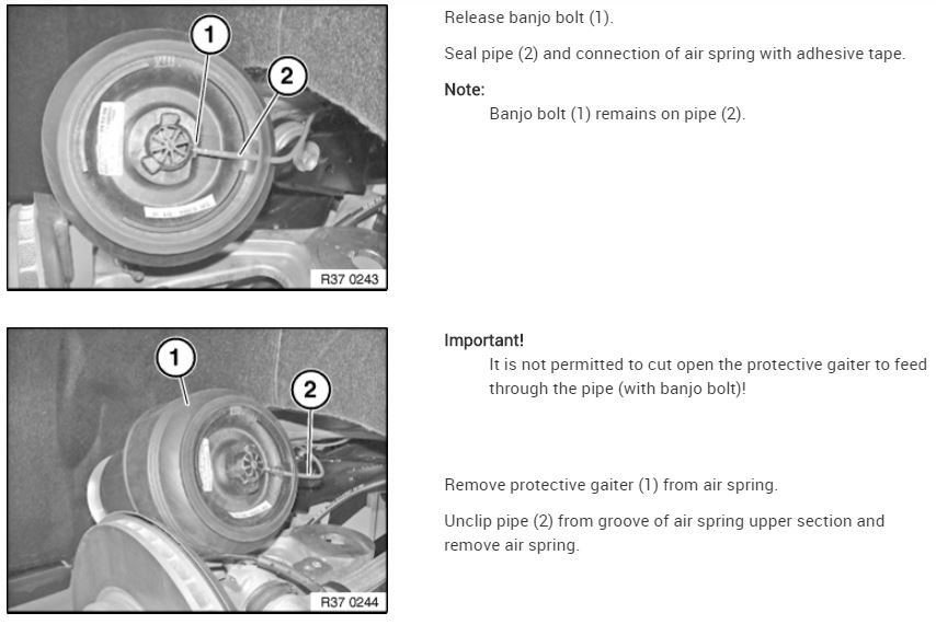

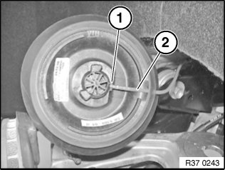

Release banjo bolt (1).
Seal pipe (2) and connection of air spring with adhesive tape.
Note:
Banjo bolt (1) remains on pipe (2).

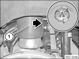

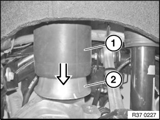

Pic 4
Important!
It is not permitted to cut open the protective gaiter to feed through the pipe (with banjo bolt)!
Remove protective gaiter (1) from air spring.
Unclip pipe (2) from groove of air spring upper section and remove air spring.

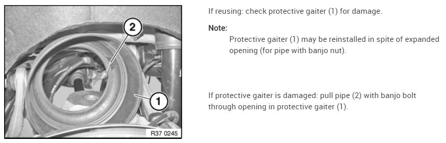

Pic 5
If reusing: check protective gaiter (1) for damage.
Note:
Protective gaiter (1) may be reinstalled in spite of expanded opening (for pipe with banjo nut).
If protective gaiter is damaged: pull pipe (2) with banjo bolt through opening in protective gaiter (1).

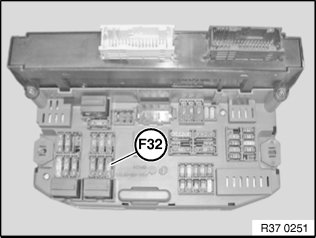

Deactivating air suspension system:
Fold down power distribution box in passenger compartment
Pull out fuse (F32) for air supply system
Pic 13

Insert fuse (F32) into the corresponding slot in the power distribution box.
Connect BMW diagnosis system.
Switch the ignition on.
Fill air springs using BMW diagnosis system (control unit functions).
Lower vehicle.
Clear diagnostic fault entries from fault memory.
