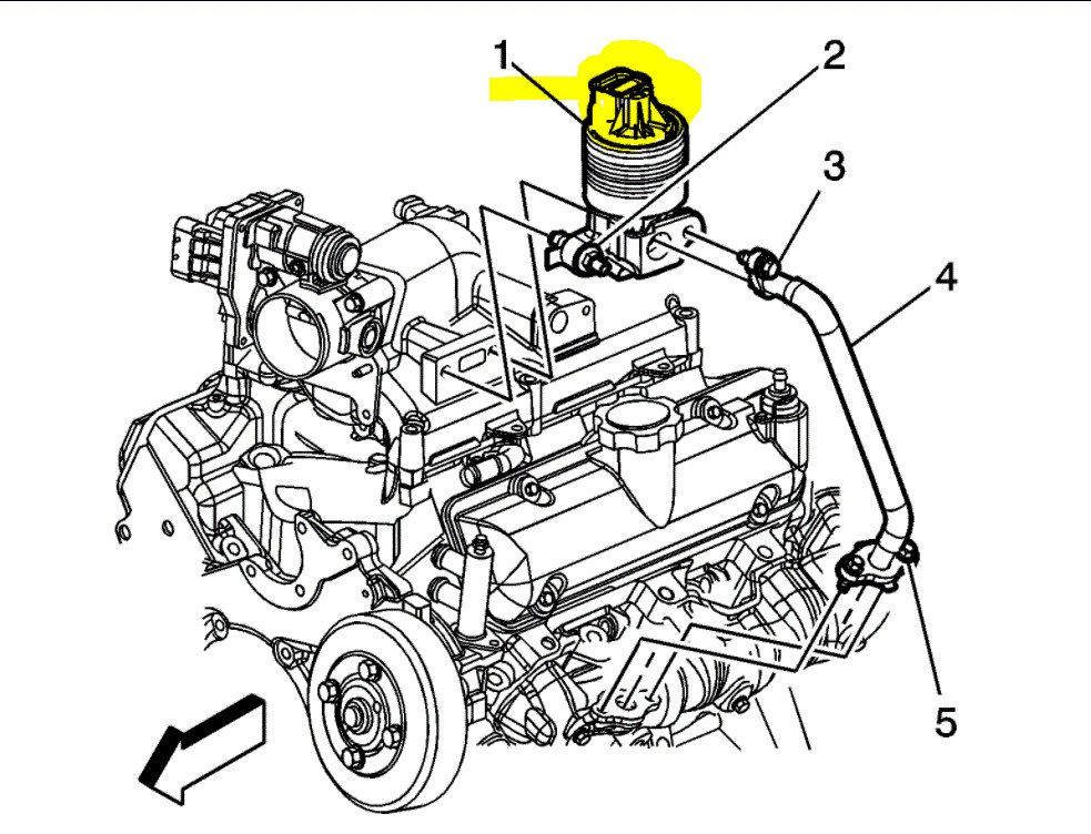

So, as you can see I have the car listed above.Great car. Looks beautiful, clean. However one morning I go outside to crank it, and nothing. Not even lights would come on. I got it to the Pontiac dealership and it they said it was the computer. They replaced it and I picked my car up and when I did it was spitting and sputtering and wouldn’t go over 15-30 MPH. It idles just fine. It’s when you press the gas that it wants to sputter. My husband ran a diagnostic and codes P0315 and p0405 came up. For P0315 we replaced the crankshaft sensor. Still didn’t erase the code. The check engine light is on and “service stabiltrak” and something with traction control are light up on the dash.

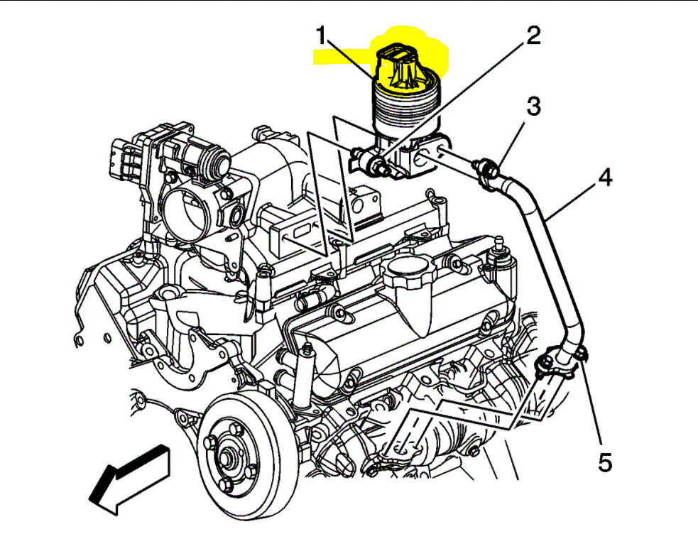

The P0405 is related to the exhaust gas recirculation (EGR) system. That could cause issues. In this case, it deals with a low voltage. Several things can cause that, but the first thing I want you to check is the connector at the EGR. Since the vehicle was just worked on, something may have been disconnected or not properly connected.
I attached a pic below showing the EGR. I highlighted where the connector is located. Check for damage, make sure it's tight, and make sure it isn't corroded.
Jan 22, 2021 at 6:38 AM
SHANDELL
Yes! My husband replaced the EGR. The EGR code went away. It’s still spitting and sputtering. Yes, I contacted the dealer. They won’t even look at it now. I took it to a shop, they checked the MAF, throttle body, etc. they said the computer is fine, and the engine supposedly is fine.
