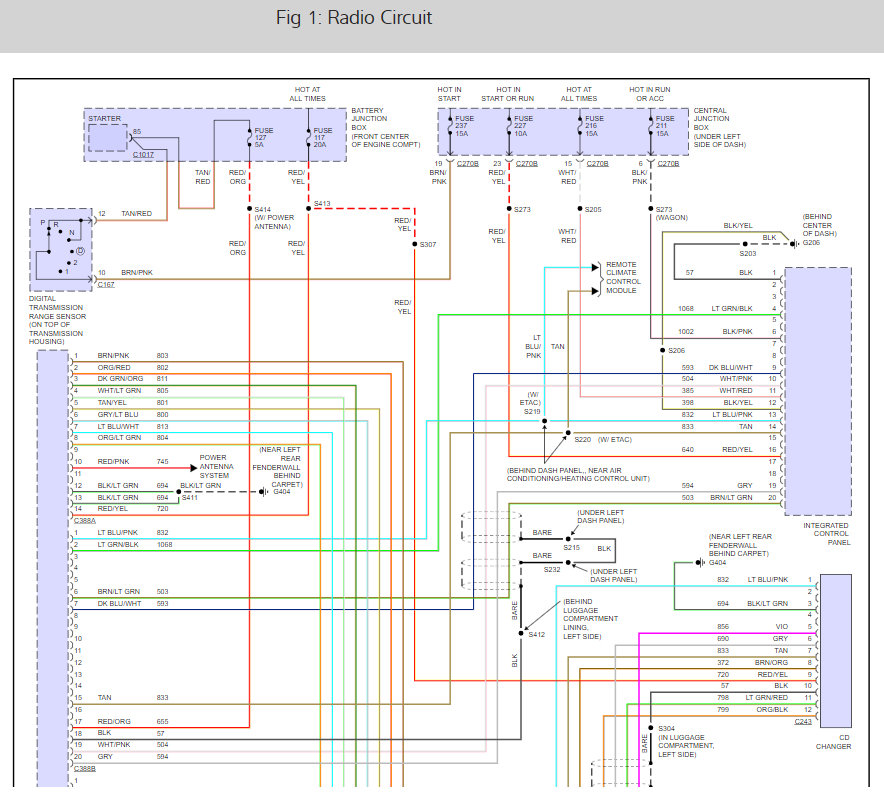

I cannot get my radio sound to come out my speakers.

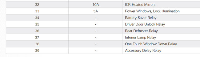

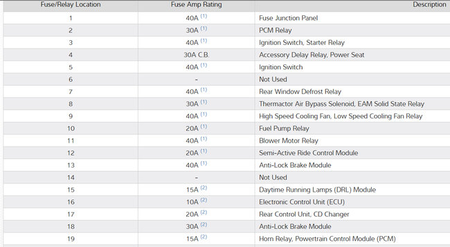

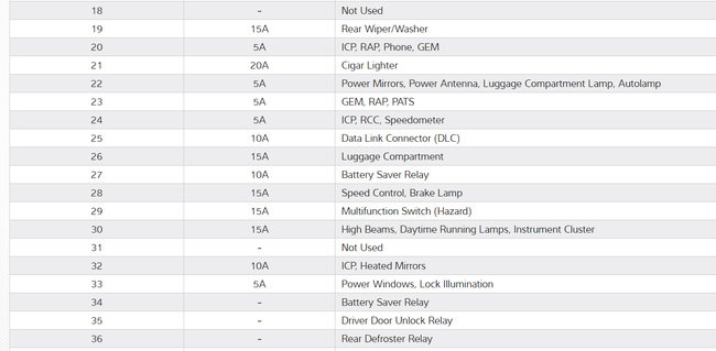

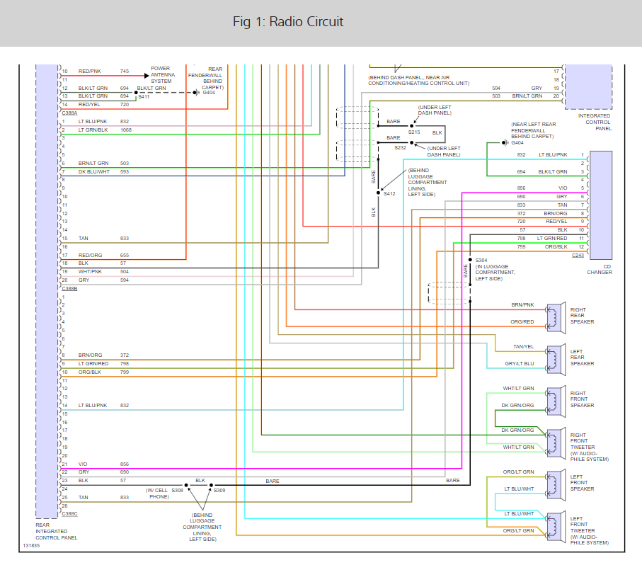

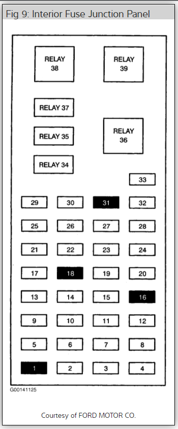

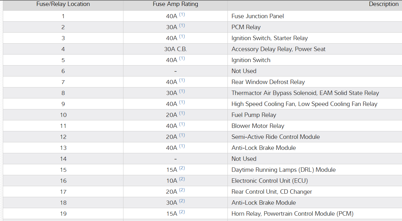

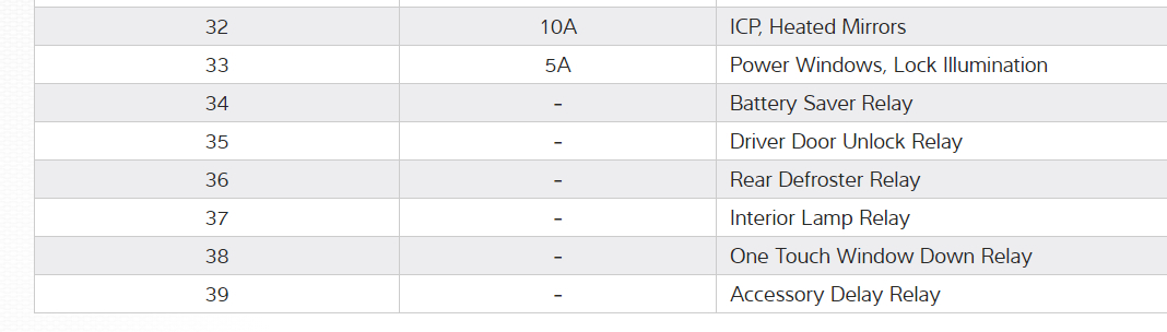

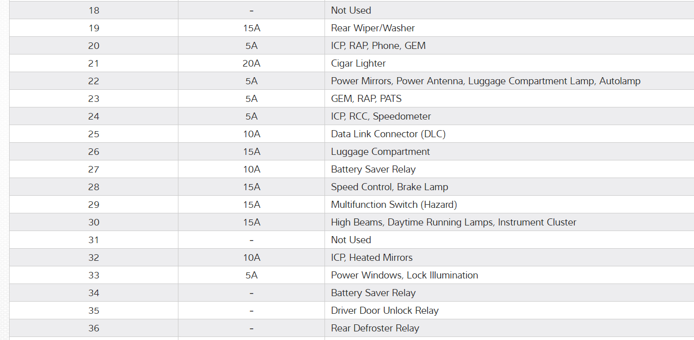

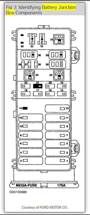

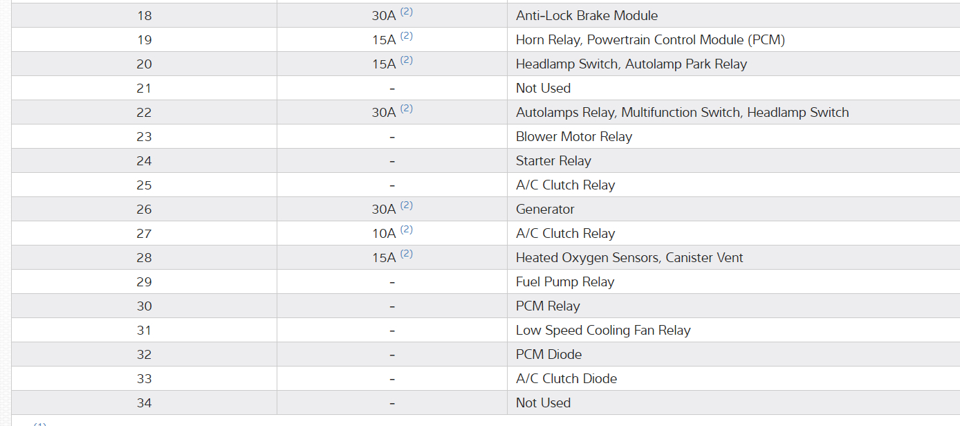

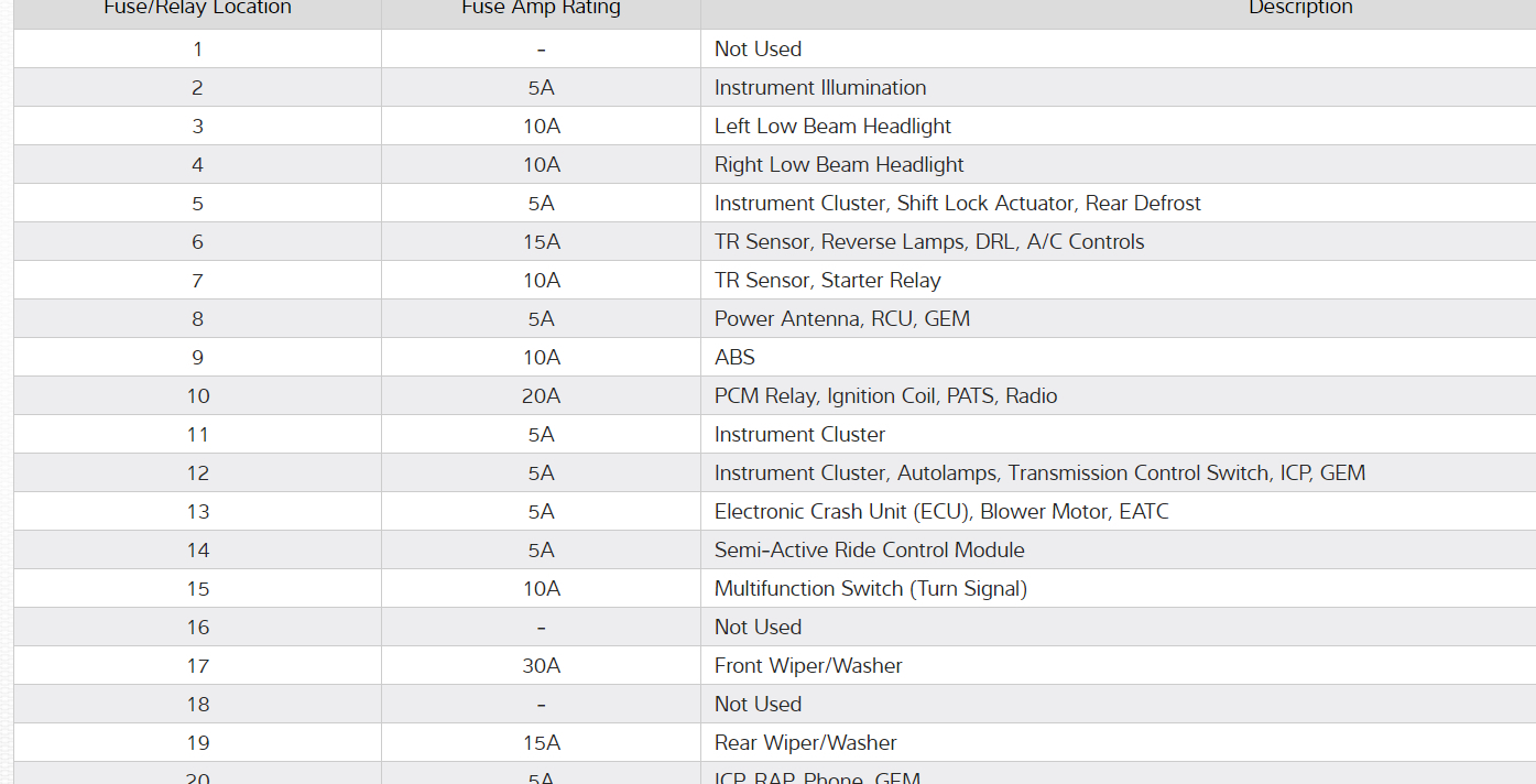

There are six fuses that need to be checked; #127, 117, 237, 227, 216 and 211. Here is the radio wiring diagram so you can see how the system works and a guide to help you check the fuses with the location of the fuses as well:
