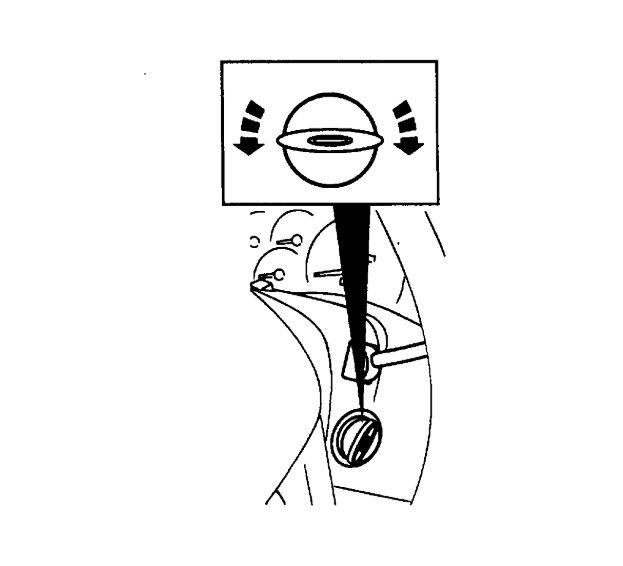

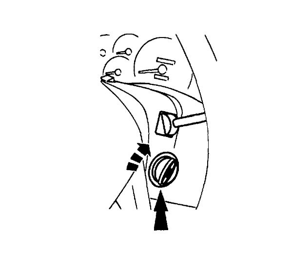

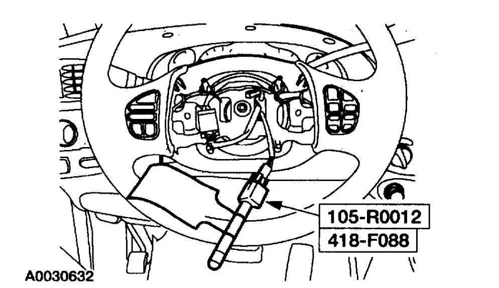

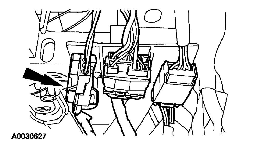

Removal and Installation
1. Disconnect the battery ground cable for at least one minute to allow depletion of the restraint system back-up power supply.
2. WARNING: To reduce the risk of serious personal injury, read and follow all warnings, notes, and cautions in the deactivation procedure.
Deactivate the supplemental restraint system (SRS).
3. WARNING: To reduce the risk of serious personal injury, read and follow all warnings, cautions, notes and instructions in the steering wheel removal and installation procedure.
Remove the steering wheel.

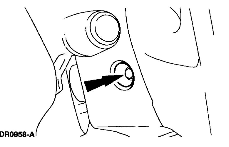

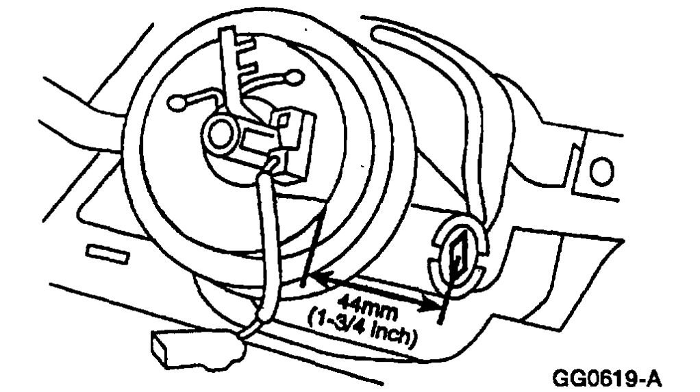

4. Twist off the cap from the ignition switch lock cylinder.
5. Remove the ignition switch lock cylinder.
Use a 3/8-inch diameter drill to drill down the middle of the ignition lock key slot until the ignition switch lock cylinder breaks loose.
Remove and discard the ignition switch lock cylinder and drill shavings from the steering column.

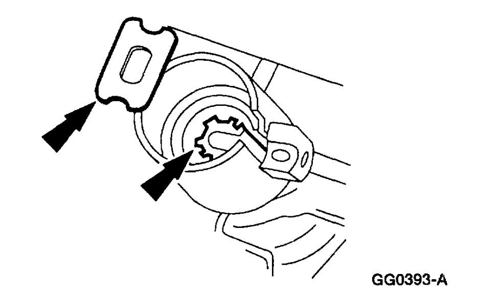

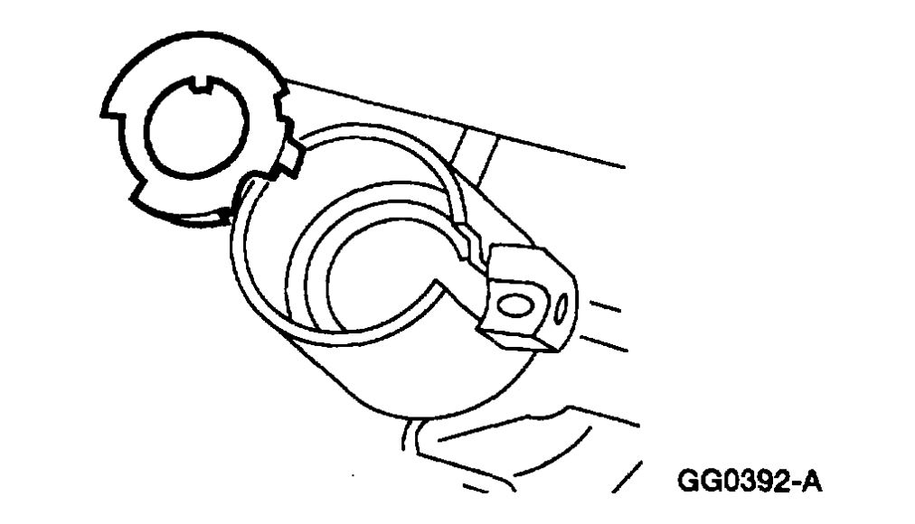

6. Remove the bearing retainer.
7. Remove the bearing and the gear.
Thoroughly clean all drill shavings from the steering column and inspect for damage.
8. NOTE: Use a new ignition switch lock cylinder.
To install, reverse the removal procedure.
Verify ignition switch lock cylinder operation.
9. WARNING: To reduce the risk of serious personal injury, follow all warnings, cautions, notes and instructions in the reactivation procedure.
Reactivate the supplemental restraint system (SRS).

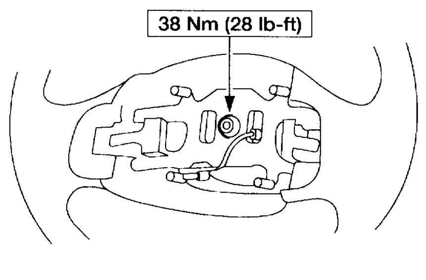

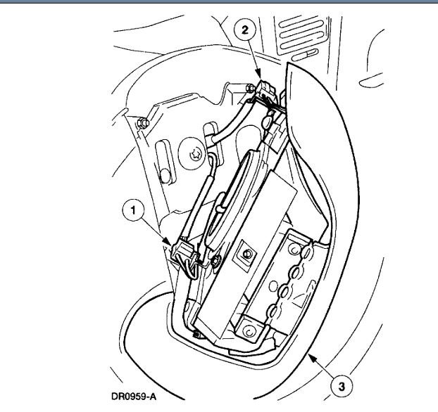

4. WARNING: To reduce the risk of serious personal injury, read and follow all warnings, notes and instructions in the driver air bag removal and installation procedure.
Remove the driver side air bag module.

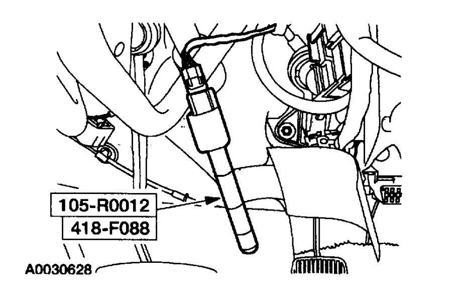

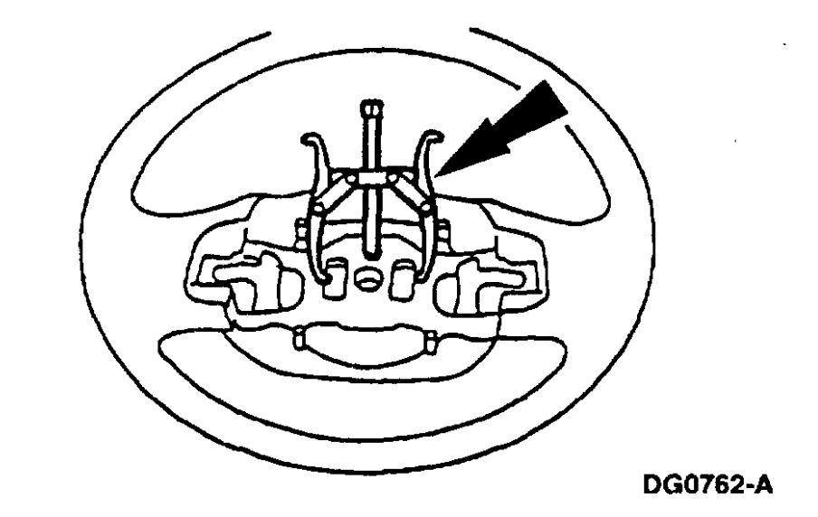

5. Remove the steering wheel bolt.
6. CAUTION: Removing the steering wheel without using a puller can damage the column bearings.
Use the Differential Side Bearing Puller to remove the steering wheel.
7. To install, reverse the removal procedure.
