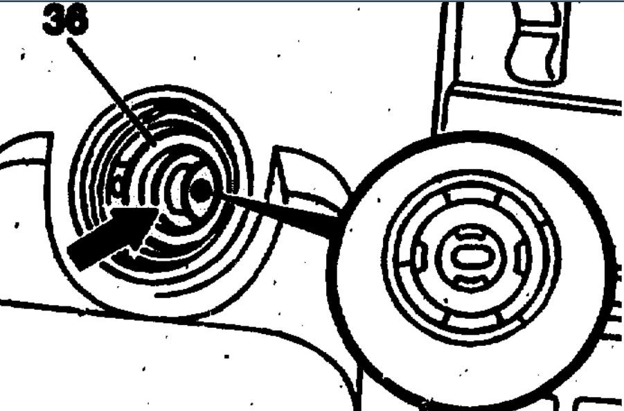

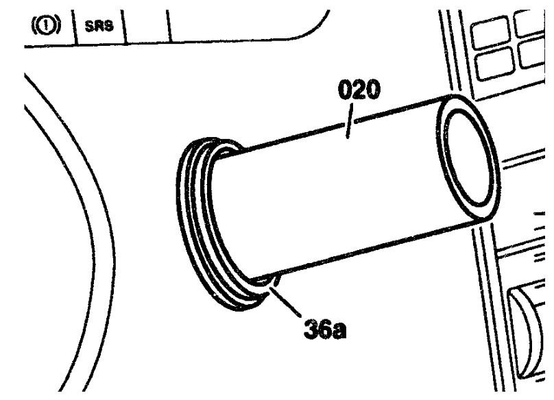

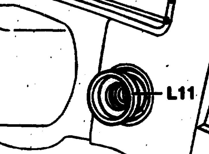

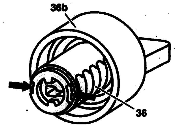

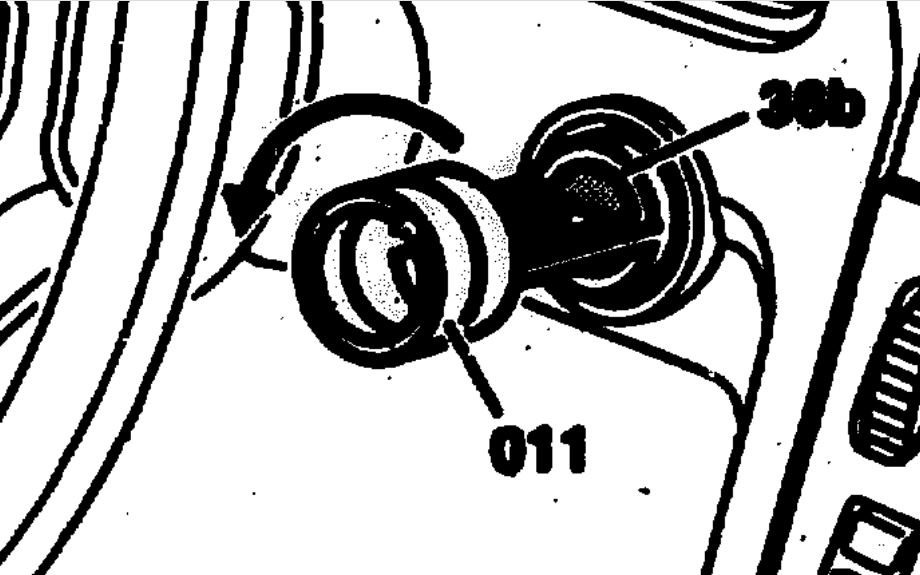

Here are the instructions for changing the ignition lock:
1.1. On vehicles without drive authorization system - using claw-type wrench (020) (Special Tool 210 589 00 70 00), unscrew trim ring (36a) from the instrument panel.
2.1. On vehicles with drive authorization system - remove coil (L11) for transponder from lock cylinder,
3. Push sleeve (011) onto the cap (36b) and turn lock cylinder into position "1" with the key.
4. Unlock and remove lock cylinder by turning the cap (36b) counter clockwise through 90°.
5. Spay the outside of the lock cylinder (36) with lock cylinder grease and insert in the covering cap (36b).
6. Push in key (36c) through the cap (36b) as far as the stop in the lock cylinder (36). The tumbler must be drawn in fully.
7. Push lock cylinder (36) into the steering lock. The recesses (arrow) in lock cylinder (36) must align with the recesses in the steering lock (arrow).
8. Turn cap (036b) with sleeve (011) (Special Tool 202 589 00 14 00) approx. 90° clockwise until it locks in position delectably or audibly.
9. Turn key into position "0" and pull out/remove with the sleeve (011).
10.1. On vehicles without drive authorization system - using claw-type wrench (020), screw trim ring (36a) into the instrument panel.
11.1. On vehicles with drive authorization system - press coil (L11) for transponder onto lock cylinder.
I am also attaching the illustrations associated with the instructions.

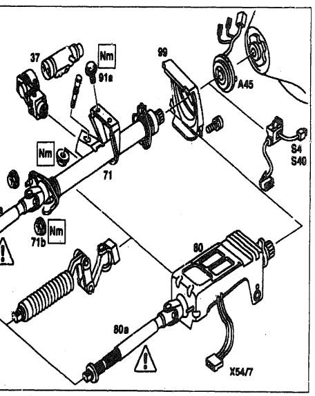

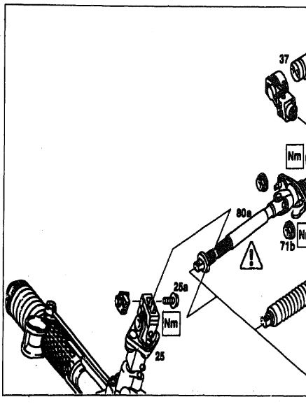

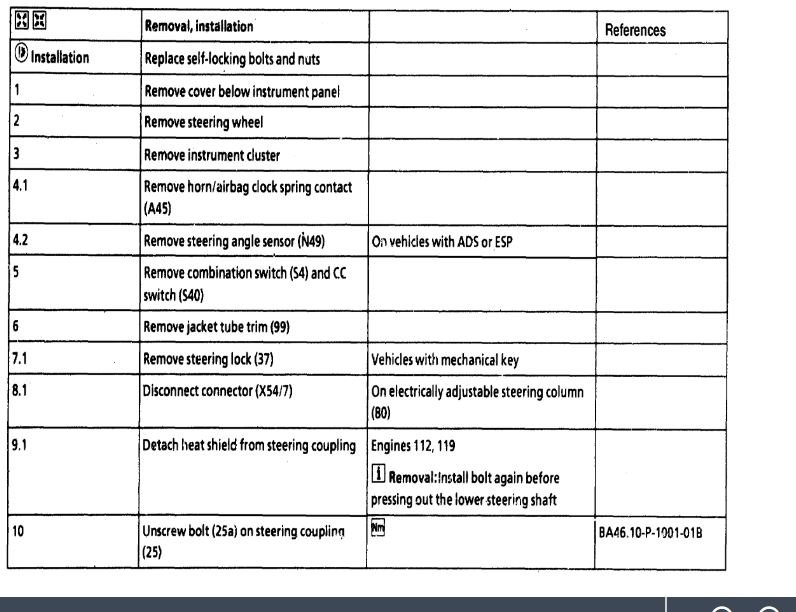

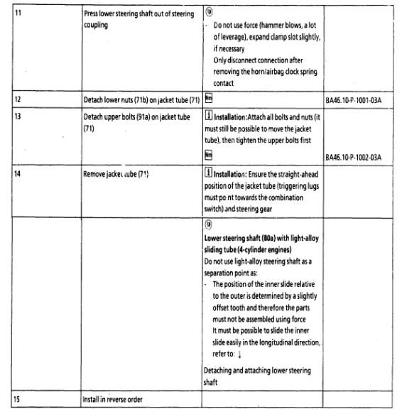

Do you have any instructions on removing the instrument cluster on this 1997 E320 or any instructions how to cut the steering lock out of steering column? Thanks, Jim
Jan 11, 2020 at 12:43 AM
MOTOR MASTER
  • 279 POSTS
Hello again,
I have attached the instructions for the steering column removal. As for the instrument panel it just clips in place however they do show a special tool to grab it but I have just used 90 degree picks to grab around the cluster, if you're careful they usually aren't terribly stubborn. You will need to pull the steering wheel for the cluster to clear it and come out however I don't believe there are any advantages to removing the cluster in order to get the column out. I hope this helps you get your car moving and again thank you for using 2CarPros!
