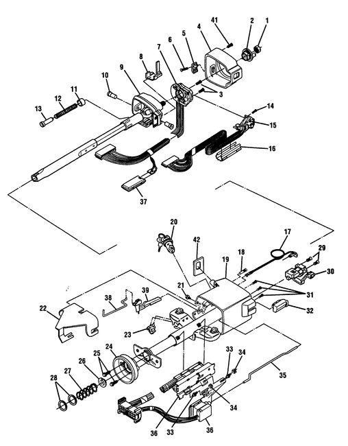

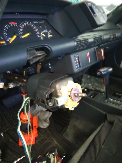

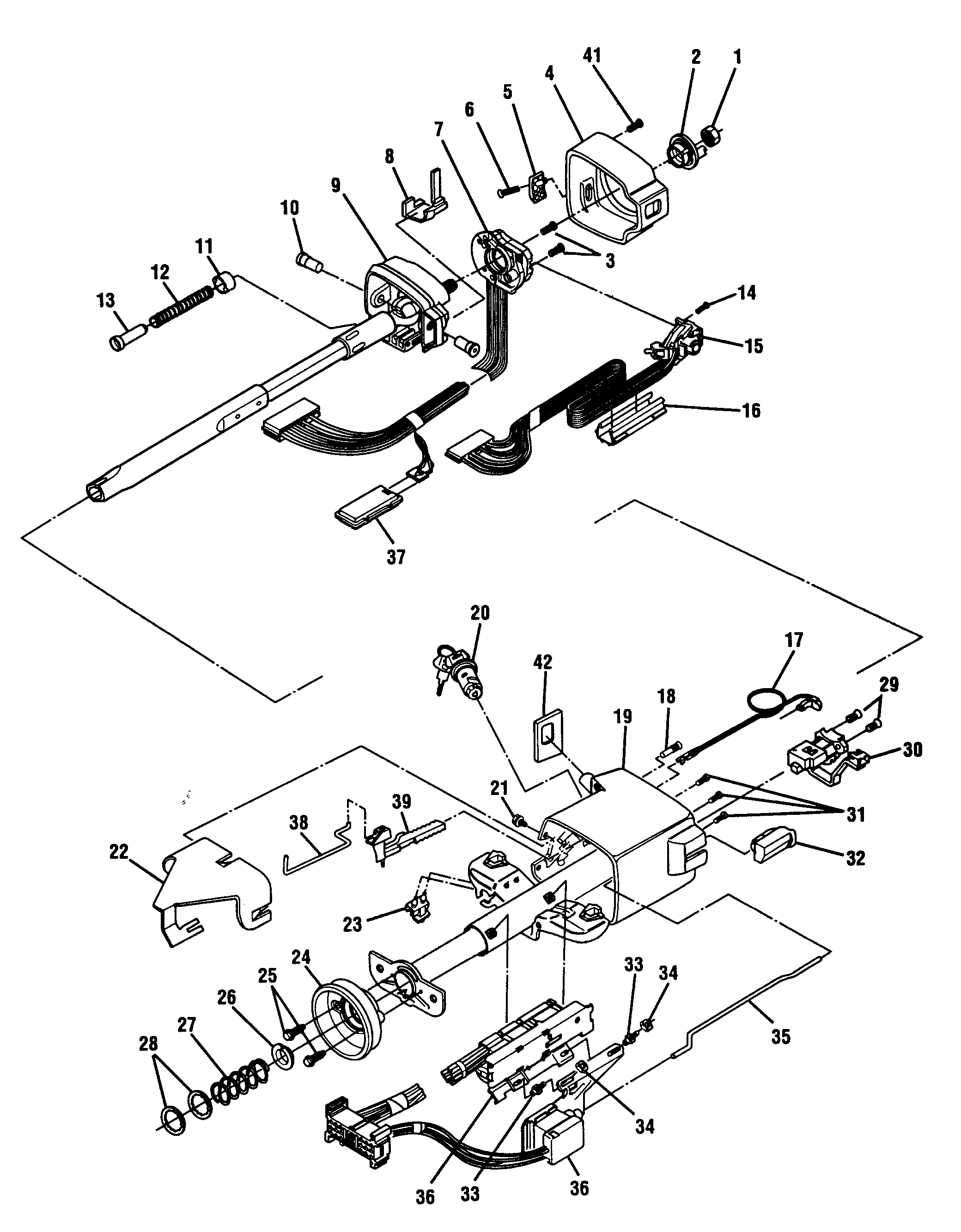

I was replacing the ignition switch on my car which has tilt steering and I forgot to move the switch slider on the new switch one detent from the far left position to the right before installing the ignition switch rod. After completing the work I tested my work and inserted the key into the lock cylinder and turned the key forward and the key is now stuck in the forward position. So then realizing the mistake I made I began to try and correct it and having no luck can I remove the housing assembly behind the steering wheel by first removing the pivot pin to reset the lock cylinder from the front of the column or do I need to remove the entire steering column? Thank you!

I hate to say it, but I feel the entire steering column needs removed. I looked at different exploded views of the column and can see how it can work any other way.
Here are the directions for removing the column. The attached picture correlates with these directions.

Fig. 27 Steering Column Removal And Installation.
See Picture 1
8. Remove lower steering column attaching bolts, Fig. 27, then the upper steering column attaching bolts, and lower steering column to seat.

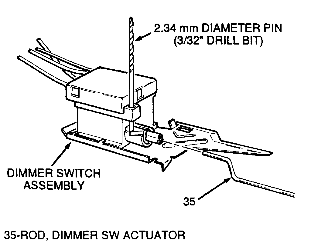

I don't know if you want them, but here are the directions for replacement of the switch specific to your vehicle. I thought I would add them just in case you wanted them. The remaining pictures correlate with these directions.
________________________________________
IGNITION & DIMMER SWITCH
Tilt Wheel Steering Column
See Picture 2

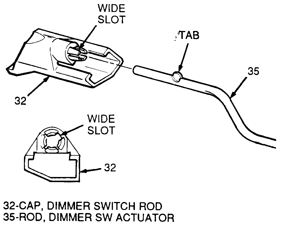

Legend
Picture 3

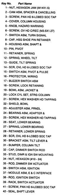

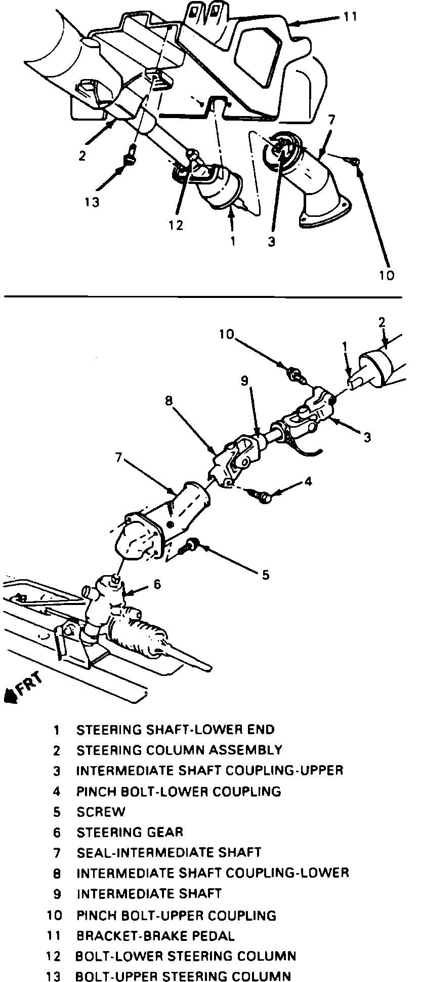

Ignition Switch And Actuator Installation
Picture 4

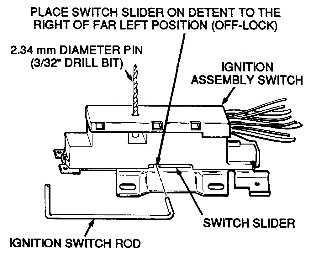

Dimmer Switch Rod Installation
Picture 5

Important: All fasteners in the following steps must be firmly seated before being tightened to specified torque. Lock cylinder set (20) must be in the "Off-Lock" position when installing ignition switch to insure proper switch slider positioning.
1. Place the ignition switch slider in the far left position and move back one detent to the right, "Off-Lock" position.
Important: Insert a 2.34 mm diameter pin (3/32" drill bit) in adjustment hole on ignition switch to hold switch slider in proper position during installation.
2. Ignition switch (36) to switch rod (38).
3. Ignition switch (36) to jacket and howl assembly (19) with lower mounting stud (33) and torque to 4 Nm (35 lb. In.).
4. Remove adjustment tool from ignition switch (36).
5. Dimmer switch actuator rod (35), tab end first, through hole in "IP" bracket and into hole in dimmer switch rod cap (32). Tab on rod (35) must engage wide slot in rod cap (32) and snap in place.

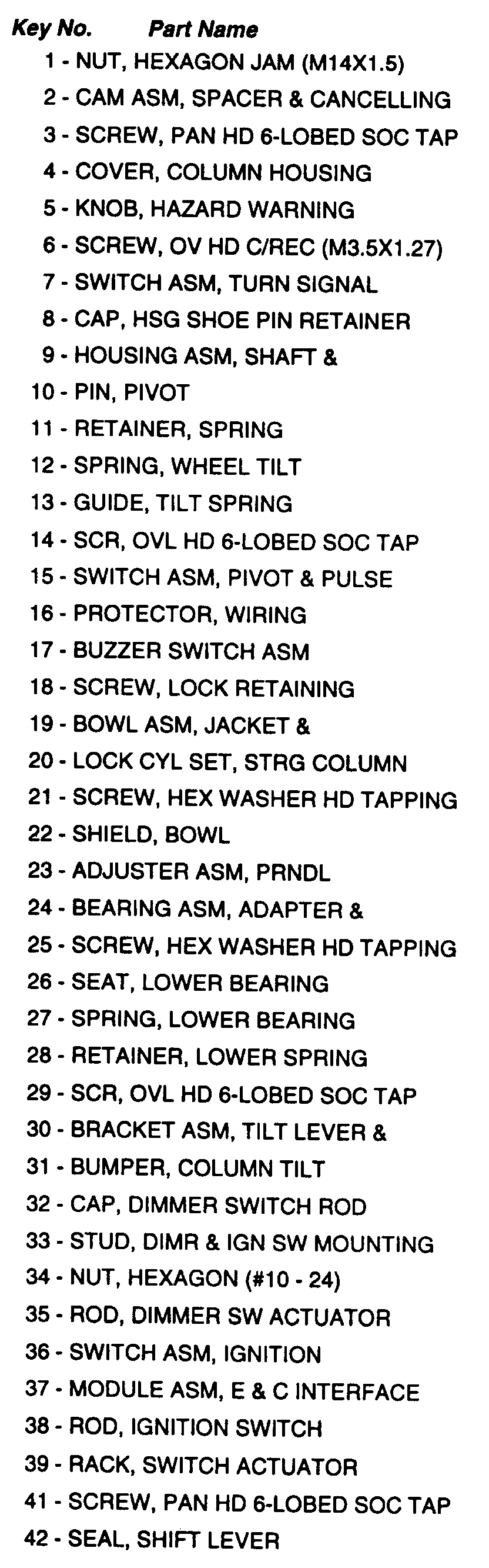

Dimmer Switch Adjustment
Picture 6
Important: To adjust dimmer switch, insert a 2.34 mm diameter pin (3/32" drill bit). Push switch against actuator rod (35) to remove all lash.
Tighten: Dimmer switch nut (34) and upper mounting stud (33) to 4 Nm (35 lb. In.).
8. Remove adjustment tool from dimmer switch.

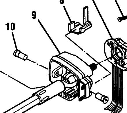

You asked which way it needed to be done. I looked over different exploded views and see no other way to do it other than remove the column. The long lists were added to help you if you didn't have the directions. I'm not sure what you were looking for. Can you explain? Also, keep in mind that most people don't have that information. That is why I included it. Removing the pivot pin will allow you to remove the housing shaft. Look at the attached picture. It shows the pin and shaft.
