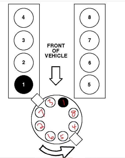

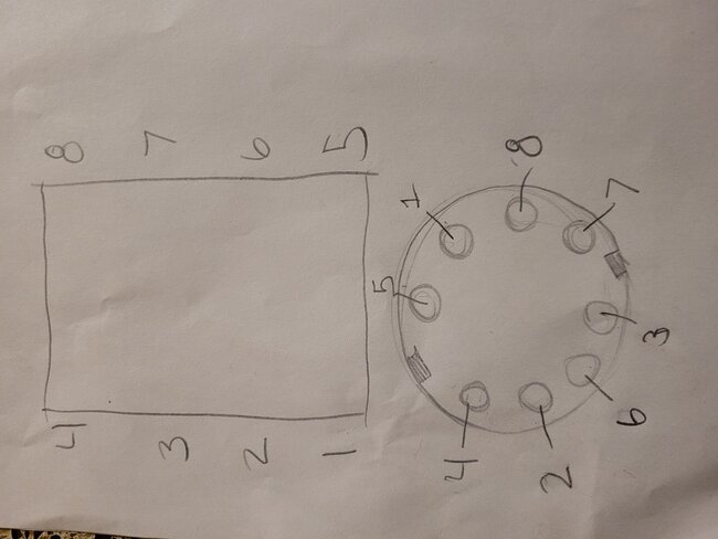

Sorry, my truck is actually automatic. It says manual in my profile info. I was going to change my spark plugs, wires and distributor cap on my truck and was confused about the current configuration (I'm the third owner, my first time doing this). I made a diagram of my current wiring configuration, and it looks like it has been setup for a 5.0l engine this entire time! I double checked my work, and here is the current firing order on my truck:1-5-4-2-6-3-7-8.
According to my Haynes manual, it says "255, 1993 and earlier 302 (5.0L) and 460 cu in (7.5L) V8 Engines = 1-5-4-2-6-3-7-8". Which is exactly how my wiring is set up. This does not match my engine type.

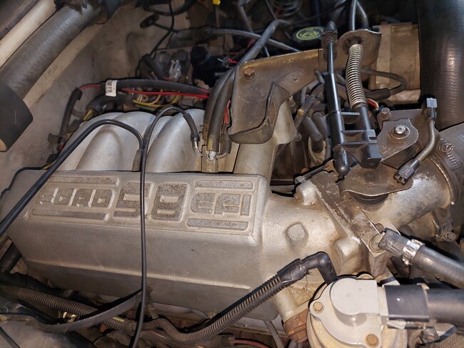

And for 5.8L Haynes says "351W (5.8L), 351M, 400 and 1994 and later 5.0L V8 engines = 1-3-7-2-6-5-4-8". My truck is a 5.8L so shouldn't the above order be correct? So, sanity check, sounds like the previous owner or their mechanic used the wrong diagram? Or am I reading the Haynes manual incorrectly? Seems like a no-brainer here but wanted to get a second opinion. And, perhaps unwisely, i reconfigured my wires to the 1-3-7-2-6-5-4-8 order just to see what would happen and the results were not pretty. The truck shook pretty badly, and the rpms were very low, 4 or 500. I turned it off very quickly. Very confused. I'll also say that my truck is running fairly well, the reason i wanted to change my plugs is because my acceleration at higher speeds is not great and gas mileage is pretty bad, maybe 8 or 10 MPG. I should note that I'm sure the engine hasn't been swapped by the previous owner. I added an image of motor top where it says 5.8 9n the top of the engine. It should be around 13. Thanks for any help!

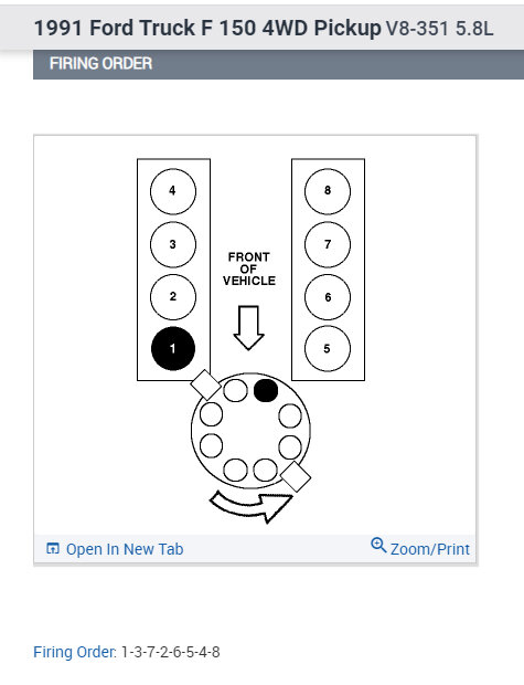

I attached what I have from my manual. 1 3 7 2 6 5 4 8 is what it shows. Maybe you had the wires on the distributor backward. The rotor turns counterclockwise. Is that how you routed them? See pic below.
Let me know. Also, see if you can find a production date under the hood or in the driver's door frame. Maybe we have a very early or very late production and they changed something.

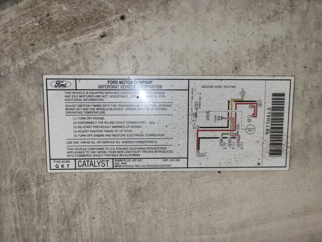

Thanks so much for the reply! Yep, the graphic you sent is the exact configuration I tried. The rotor spinning counterclockwise. It did not end well :-) I searched my VIN and this all of the information I received back:
1991 Ford F150 1/2 ton P/U 4WD 8 Cylinders H 5.8L MFI OHV 351 CID
My door sticker probably fell off long ago and I can't find any other information on the driver's side door. I did attach a picture of a sticker that's under the hood of the car, but I'm not sure if that's helpful. After some more searching, I did see a reference to 351w H.O engines and non-H.O engines and there's a difference in firing order, but I'm not sure if this applies to my situation. My Haynes manual doesn't say anything about H.O/non H.O engines. If my configuration is wrong, it's very odd to me how my truck is operating at all. Is it possible some timing was altered to make it work?

Thanks for the thoughts! The engine is a 5.8L for sure, it has "Ford 5.8L EFI" on top of the engine. Attached an image. But, I think what may have happened is a crankshaft from a 5.0L 302 was installed into my 351 at some point, therefore changing the firing order. After some googling, I have found quite a few people online that have run into this as well, and that they are completely interchangeable. What do you think? Can't think of anything else. Thanks for your time, it's much appreciated.
