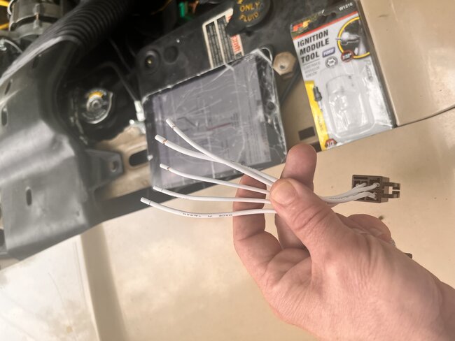

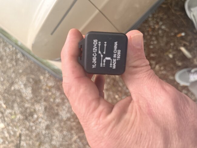

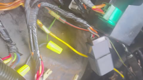

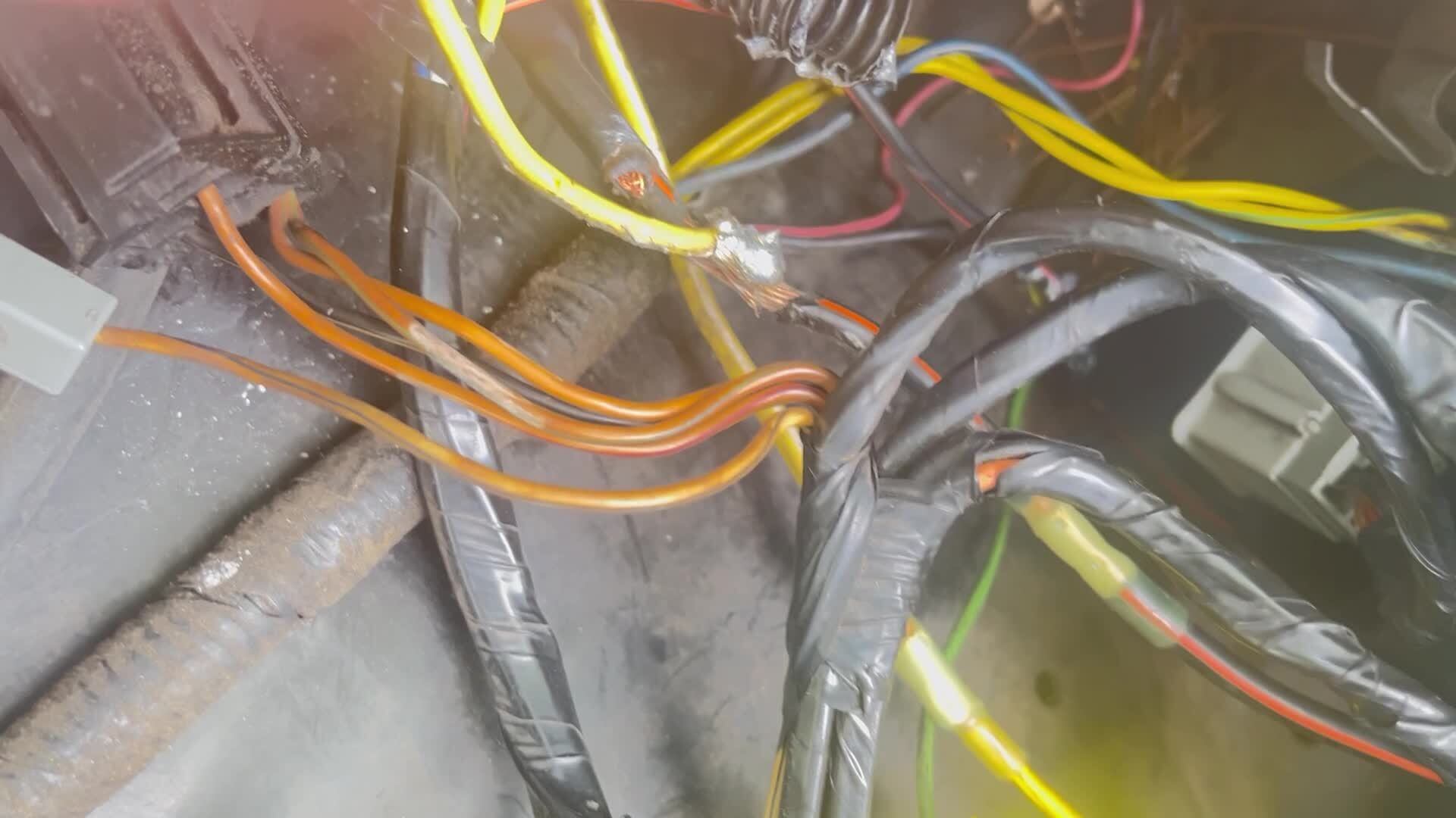

I recently purchased this car, and someone cut the ignition relay harness and all out and bypassed it. I have a new harness and relay, 5 pin, labeled 1-5. I need guidance on which wires go to which pin. I am having a hard time finding this on the internet. Any help would be appreciated.

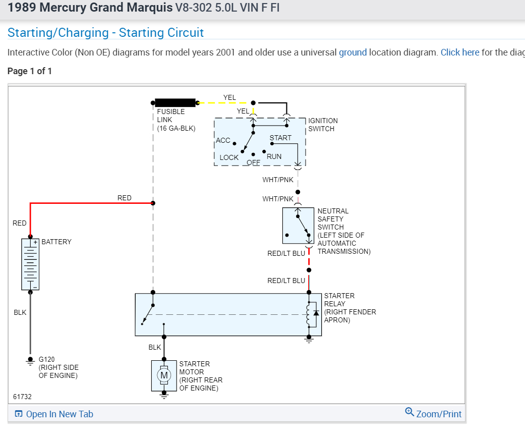

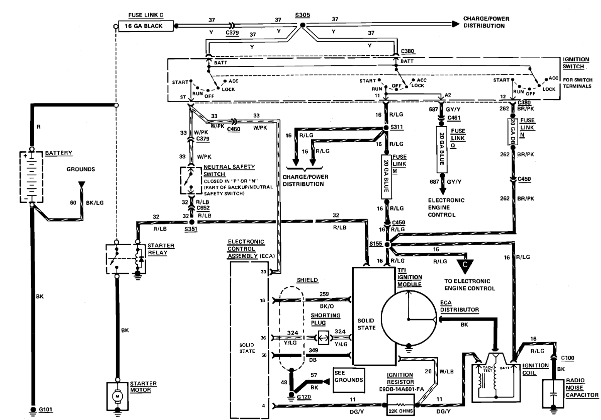

Sure, here are the ignition switch wiring diagrams and I have included a guide to help you test the connections.
Check out the images (below). Please let us know if you need anything else to get the problem fixed.

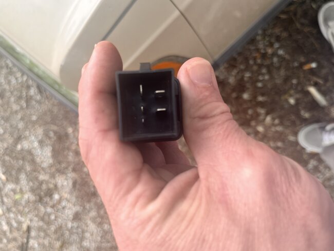

The problem is that i don’t know which specific wires go to which pins on the relay.

Yep, they don't show that only the color of the wires and then the relay only plugs in one way so you need to orenant the connector correctly to the replay before the wiring can begin. Thanks for the images and video it helps.
