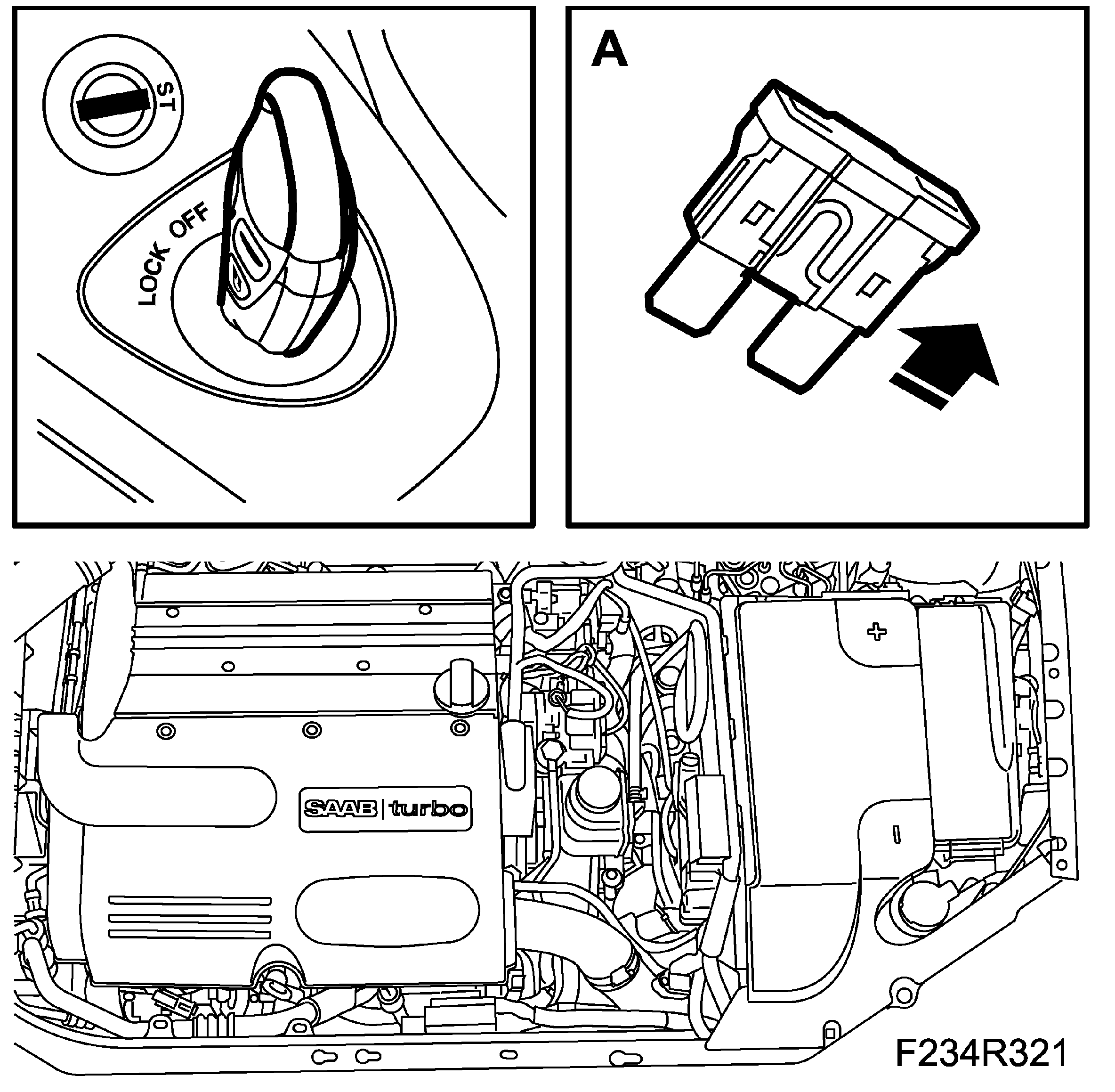

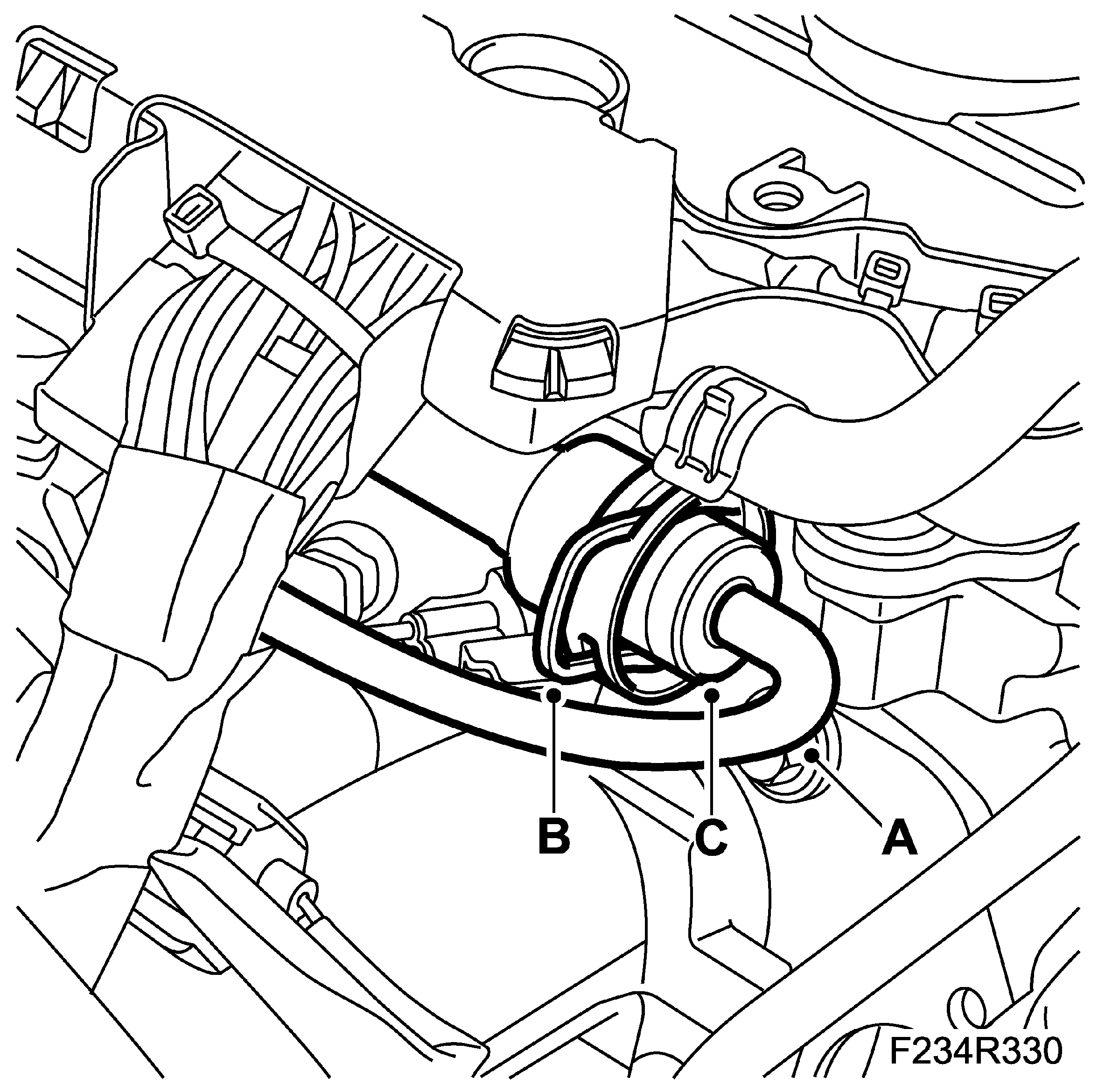

I replaced every component of the trionic system in this car. My problem is the fuel pump is sending too much fuel to occasionally start or will send too much fuel when I slow down causing it to shake and the check engine light to flash. Like I said, I've already replaced every electronic ignition component. I haven't yet touched the fuses and have all the fuses that relate to the issue. This only happens then the car is hot. Could it be a relay or fuse. I have another car for parts. I just need to fix this issue. I keep getting codes for things like camshaft sensor or knock sensor that the car doesn't have.

If you are getting too much fuel, then the fuel pressure regulator is most likely the problem and it isn't anything electric. First, check fuel pump pressure to see if the regulator is doing its job. Here is a link that shows in general how it is done. By the way, if you disconnect the vacuum hose going to the pressure regulator and find fuel is in it, replace the regulator.
Here are directions for testing the regulator specific to your vehicle. Fuel pressure specs are included in the directions. Also, the attached pictures correlate with these directions.

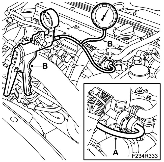

2. Detach the vacuum hose from the pressure regulator (A) and connect pressure/vacuum pump (B), 30 14 883 Pressure/vacuum pump, and charge pressure meter (B), 83 93 514 Charge pressure meter.
pic 2

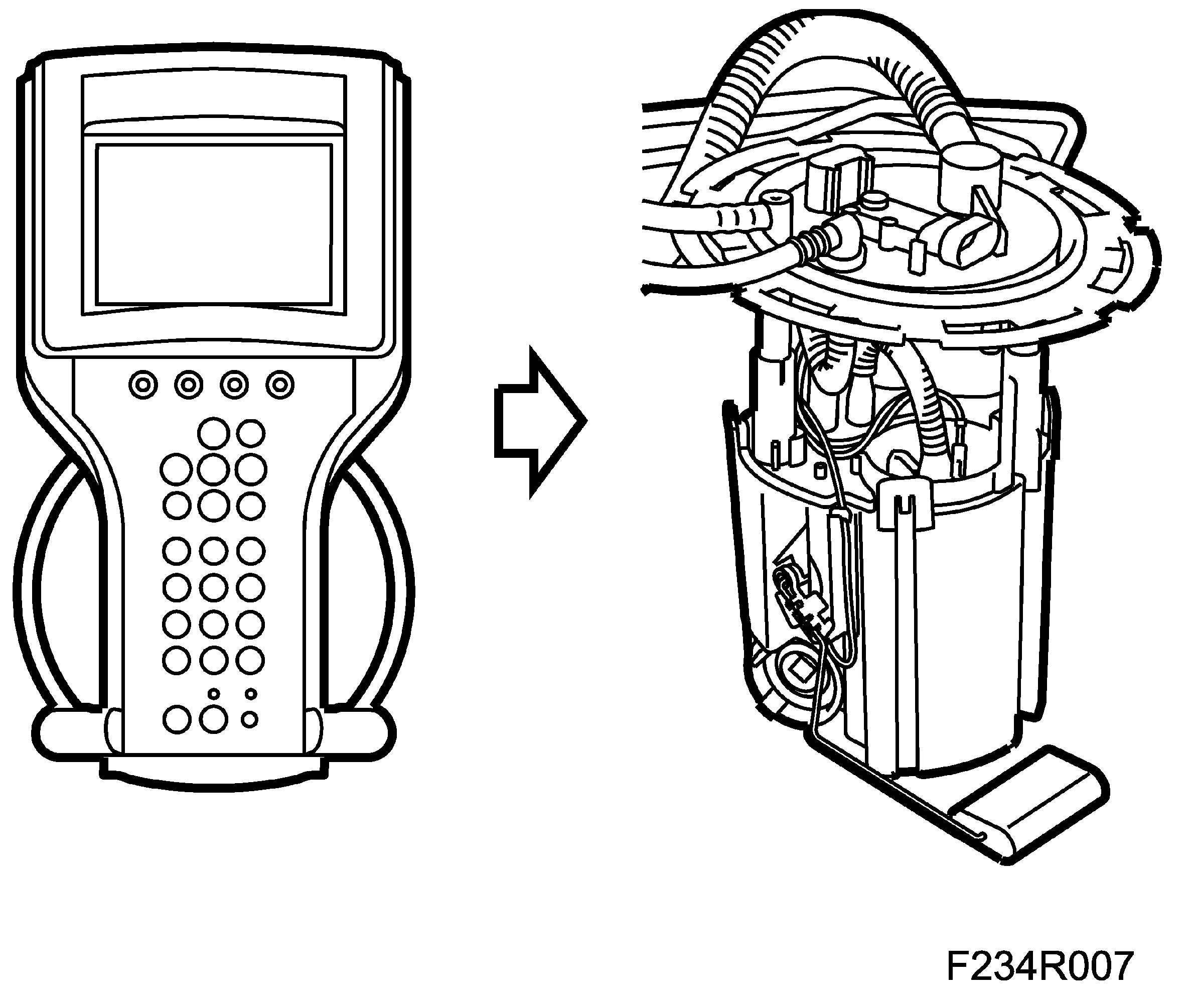

3. Start the fuel pump using the diagnostics tool.

4. Check the reading at atmospheric pressure. The reading should be 3 bar (43 psi).
5. Increase the vacuum in the pressure regulator by means of the pressure/vacuum pump. System pressure should drop by the same amount as indicated on the pressure gauge.
System Pressure .................... 3 bar (43 psi)
6. Pump up the pressure in the pressure regulator with the vacuum pump. The system pressure should now increase with the same amount as the reading on the pressure gauge.

If you determine the regulator is bad, here are the directions for replacing it. The attached pictures correlate with these directions.

To remove

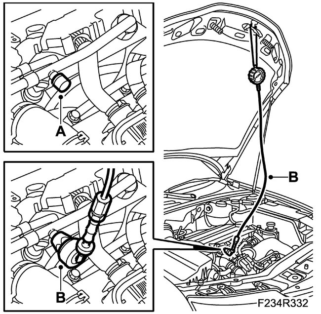

1. Reduce the oil pressure by removing fuse 2 for the fuel pump while the engine is running (fuse 2 is located in the main fuse box in front of the battery). Once the engine has stopped, turn the ignition key to LOCK and refit the fuse (A).
Pic 4

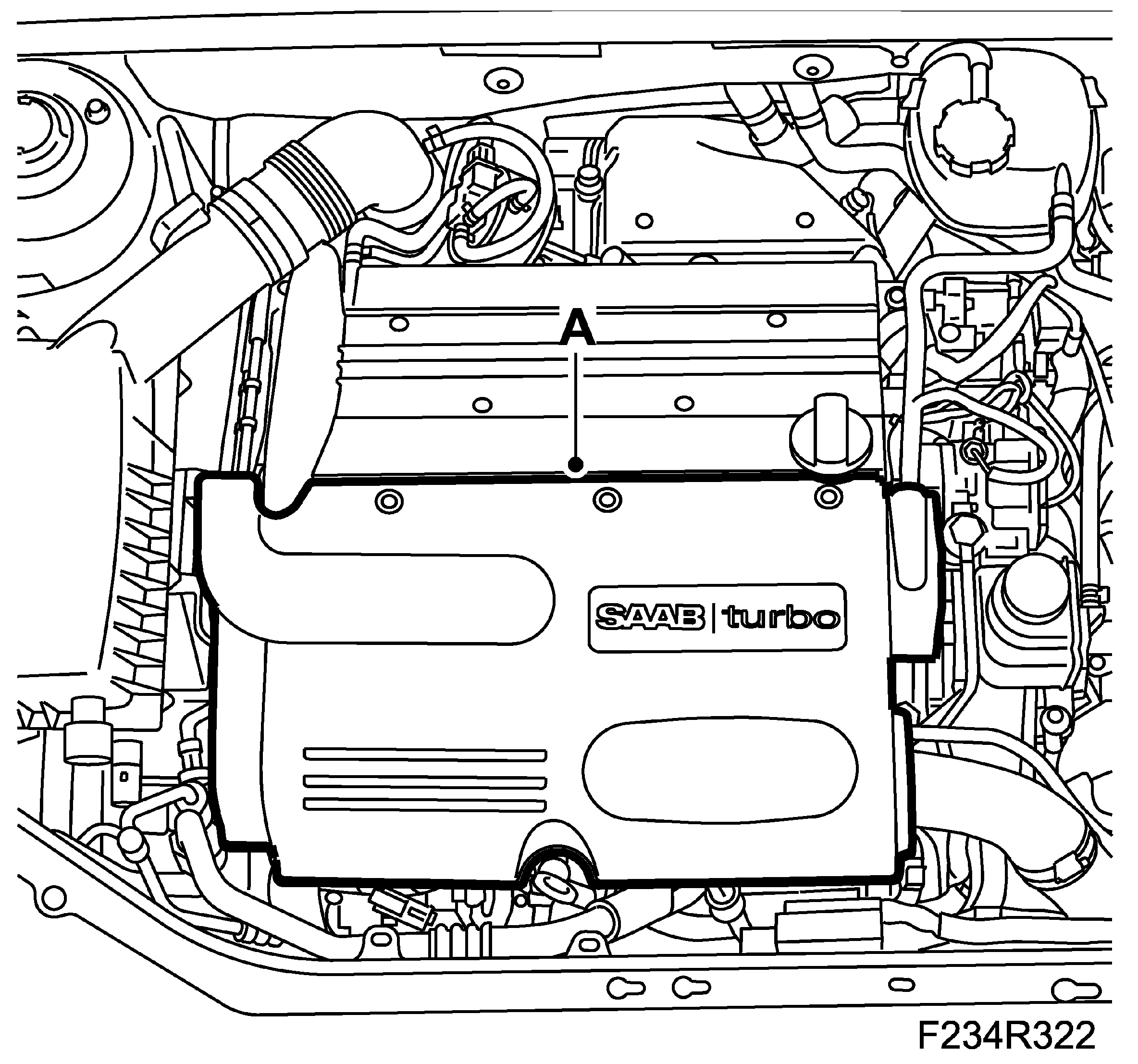

2. Remove the upper engine cover (A).
pic 5

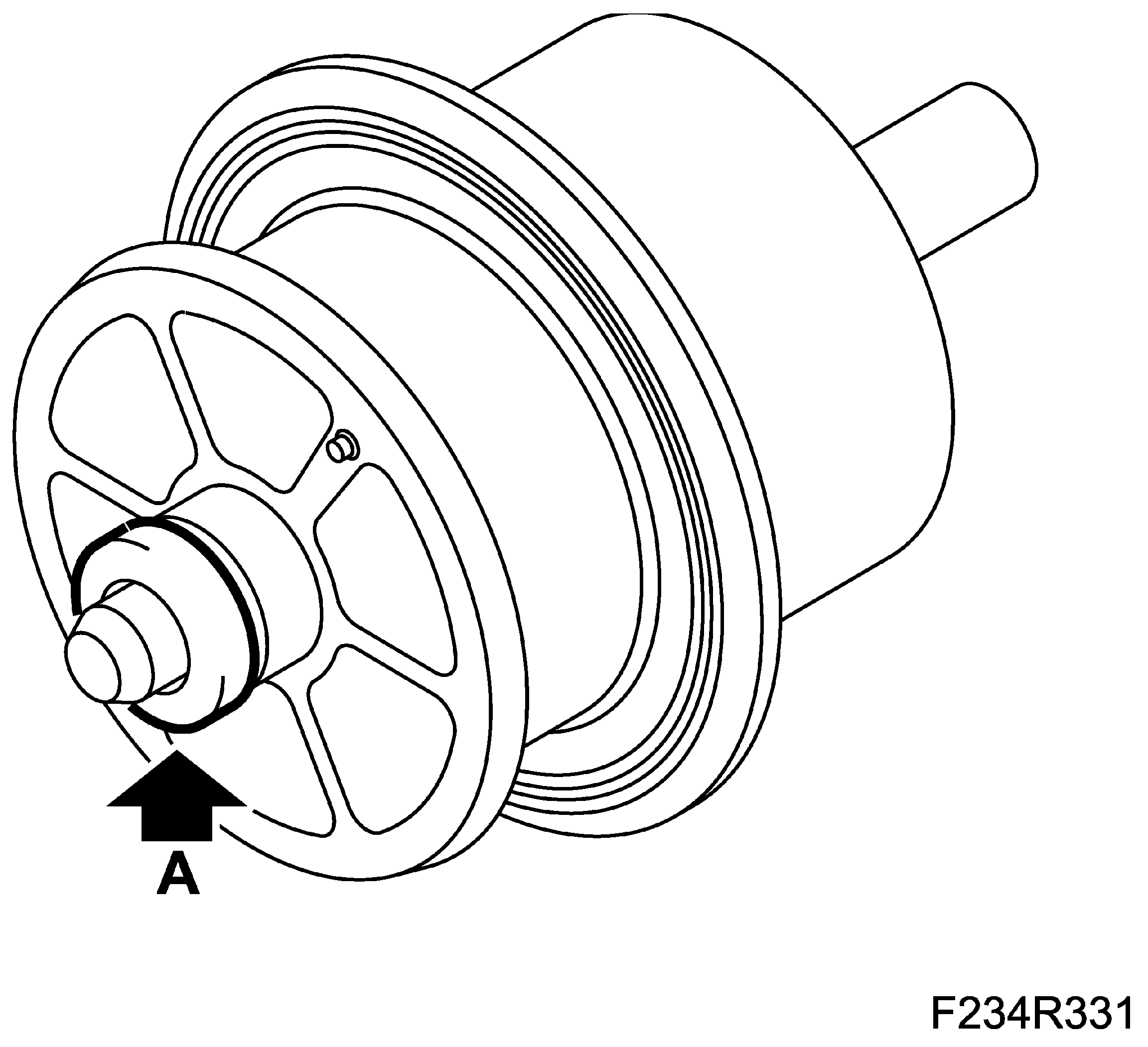

3. Remove the vacuum hose (A).
pic 6
4. Undo the fuel pressure regulator retaining clip (B).
5. Remove the fuel pressure regulator (C). Collect any fuel spill with a rag.
