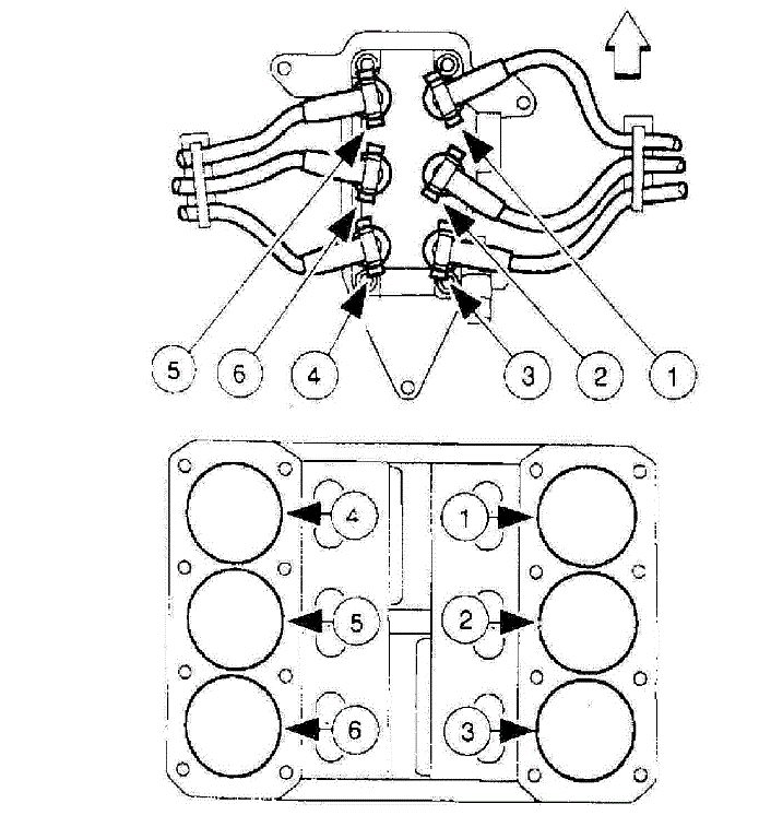

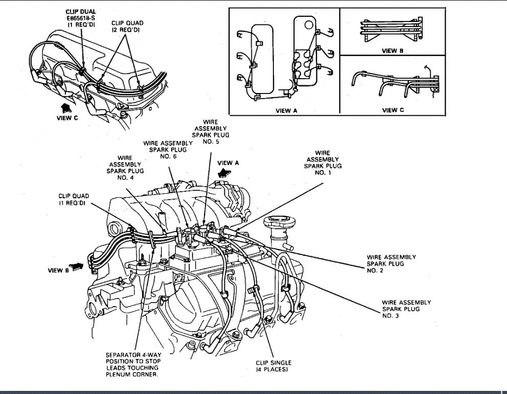

I have the vehicle listed above xlt model. We just replaced the spark plugs and wires one at a time so they were put back right, and also replaced the coil pack. Now during acceleration it sounds like we are driving over one of those wake up strips and gets worse at 45 mph. We can't seem to find anything wrong. They were pre gaped plugs and we double checked them anyways. Any ideas as to what might be the problem?

First, reconfirm they were put on correctly. I will tell you the wire routing is extremely important on these vehicles simply if it done wrong, they melt on the exhaust system and short. Plus, (and this is from memory) they plug wires are somewhat difficult to get on the plugs on a few of the cylinders. Make sure they are fully seated. You should feel a click when installing them on the plug.
Do me a favor. Just to confirm, I've attached two pics. The first shows the firing order. The second shows wire routing. Confirm these things are correct.
