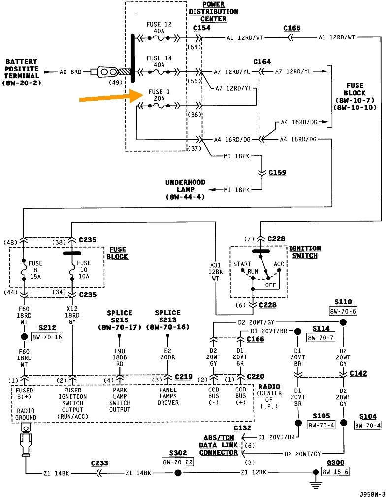

i recently replaced my PCM because it was having stalling problems and very erratic RPM behavior. That fixed the problem but very shortly thereafter the one day the car would not start. i tried again later and it started but i had no accessory power (no power to the radio). So, i replaced the starter switch and key assembly. Still starts fine but also still no power to the radio.

There's an easy fix for the rpm problem if the battery was recently disconnected or run dead. If that is the case, it is also fairly common for fuses to blow for no reason when reconnecting the battery. There's two fuses for the radio. One is in the 12-volt switched circuit coming from the ignition switch. The other is the 12-volt memory circuit that keeps the radio presets and clock alive when the ignition switch is off. On most models that memory circuit is tied into the dome light circuit. After looking at your diagram, I see the radio memory is on the same circuit as the power mirrors, power locks, chime, and remote keyless entry module. Check if those things are working.

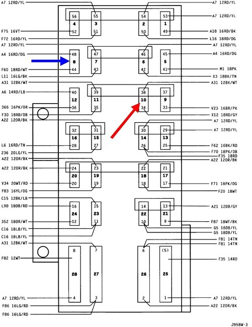

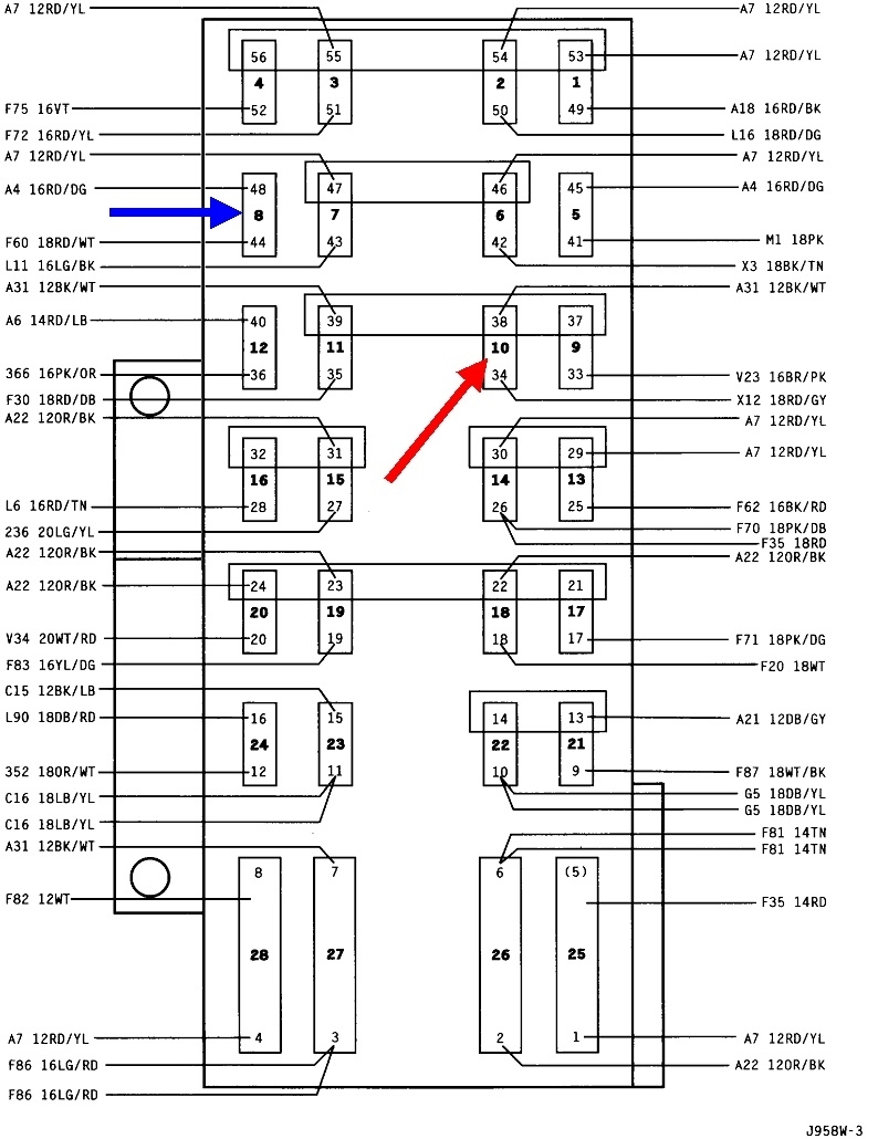

For the radio, start by checking the operation of the power mirrors and locks. If they do not work, suspect a blown fuse. The drawing below shows the interior "Junction Block". That's the inside fuse box. It's listed as "The fuse panel is located on the right side kick panel."
Those fuses have two tiny holes on top for test points. Use a test light or a digital voltmeter to test the two with the arrows. Here's links to some articles if you need more information:
They're using an "auto-ranging" voltmeter in that article. That's an expensive feature you don't need. You can find a perfectly fine meter at Harbor Freight Tools for $7.00. I can help you set it up if necessary. They have a dandy test light too. You can also find those items at Walmart or any hardware store.
The blue 15-amp fuse will have 12 volts on it all the time. For the red 10-amp fuse, the ignition switch must be in the "run" or "acc" position. You should find 12 volts on both test points for each fuse. If you find 0 volts on both test points for one fuse, that circuit is not turned on. Normally that's the ignition switch we forgot to turn on. If you find 12 volts on both test points, that fuse is good. You're looking for a fuse that has 12 volts on one test point and 0 volts on its other one. That indicates it is blown. Of course you can also just pull those two fuses out and visually inspect them.

Your reply was helpful but your "drawing below" was not there so I was not clear what number fuses to check. However, looking at my electrical diagrams it would seem that the fuse for radio power is #10 and it has power on both sides. The power door lock and power mirrors would appear to #8 it has no power either side took it out looks fine. I put a new one in anyway and still no power anywhere. neither of those systems are working. Where do I look next?

Well frog fuzz! This has to be my 'puter's fault. Please allow me to apologize for him.

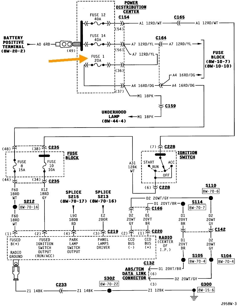

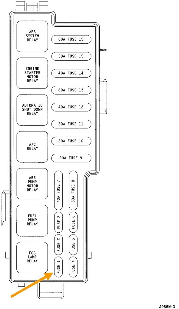

Now that we know which circuit is dead, we can follow that back. The next two diagrams are everything for the base radio system. We only need the first one. That part is the same if you have the Infinity system. Check if the under-hood lamp is working. If it is not, fuse # 1 in the power distribution center, (under-hood fuse box), is the best suspect.
If that fuse is blown and a replacement blows right away, don't panic. I have a trick for finding shorts that prevents wasting more fuses. If the fuse doesn't blow, at least right away, a good suspect is broken or frayed wires between the driver's door hinges. My trick will work for that too. It involves replacing the blown fuse with a light bulb, but it needs to be placed where you can see it while looking for the short. If it comes to that, I have some sad drawings that will help explain the procedure better.

So far that worked. fuse #1 was missing, hopefully it will stay fixed. thanks a lot.

Like someone removed it; possibly while diagnosing some other problem?
