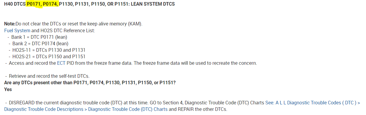

My daughter's van listed above shuts off at any unforeseen time, (driving, slowing down, taking off). I'm trying to start with options that do not require new parts first. I had it shut off three times in five miles. Downhill grade to the left, uphill grade to the right, and slowing to a stop on level. The battery icon blinks before the engine shuts off. It did start while I put it in neutral still moving. Last night she stopped to buy groceries and it shut off. She tried seven times to keep it running, but each time it would run for a short time and then shut off. Replaced cracked vacuum line today. That cleared P0171 and P0174 codes. Shutting off problem started two days ago and continues after vacuum line replaced. EGR valve and coil pack replaced. Possibly low voltage from alternator? Wire harness to close to ignition module?

Based on the codes and your description, it sounds like a fuel pressure issue or there are more vacuum leaks you are missing.
If you haven't already, check fuel pressure. I have a feeling it is going to be low. If you look at that attached pic, it is a portion of the diagnostics. It indicates a lean condition on both banks. So, either we have low fuel pressure, a false reading from the ECT, or there is another vacuum leak.

Because it is a lean mixture, I don't see it as a problem related to the ignition.

Replacing the vacuum line cleared P0171 and P0174 codes and no other leaks found. What I have read about the engine shutting off at unexpected times warrants a different problem all together. Low voltage from alternator.
