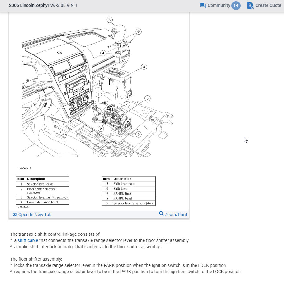

What do I need to do to remove it?
Sep 1, 2020 at 7:06 AM

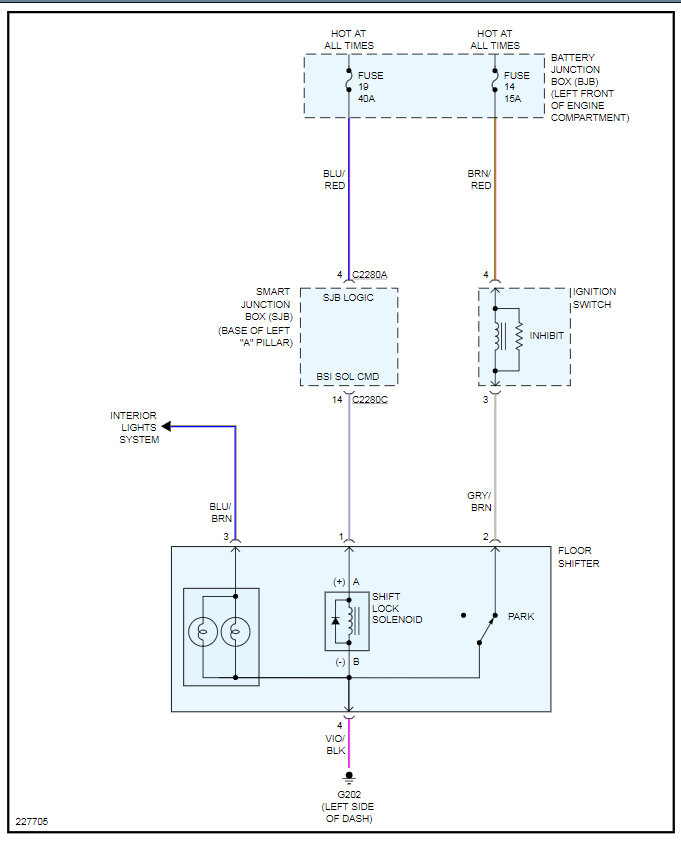

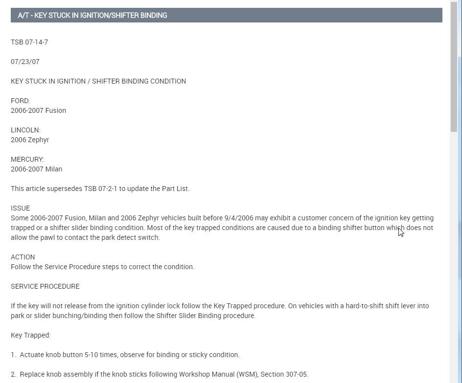

This sounds like an issue in the ignition lock solenoid. That is what keeps the key from being removed if the vehicle is not in park.

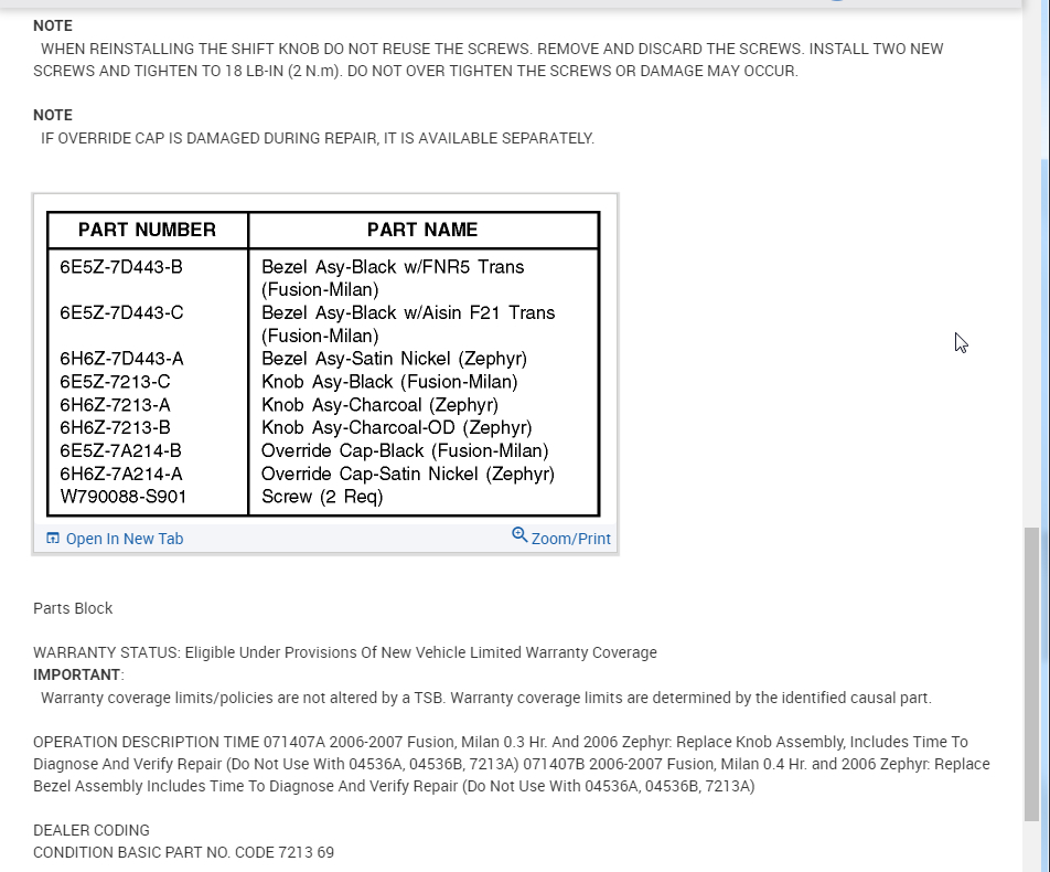

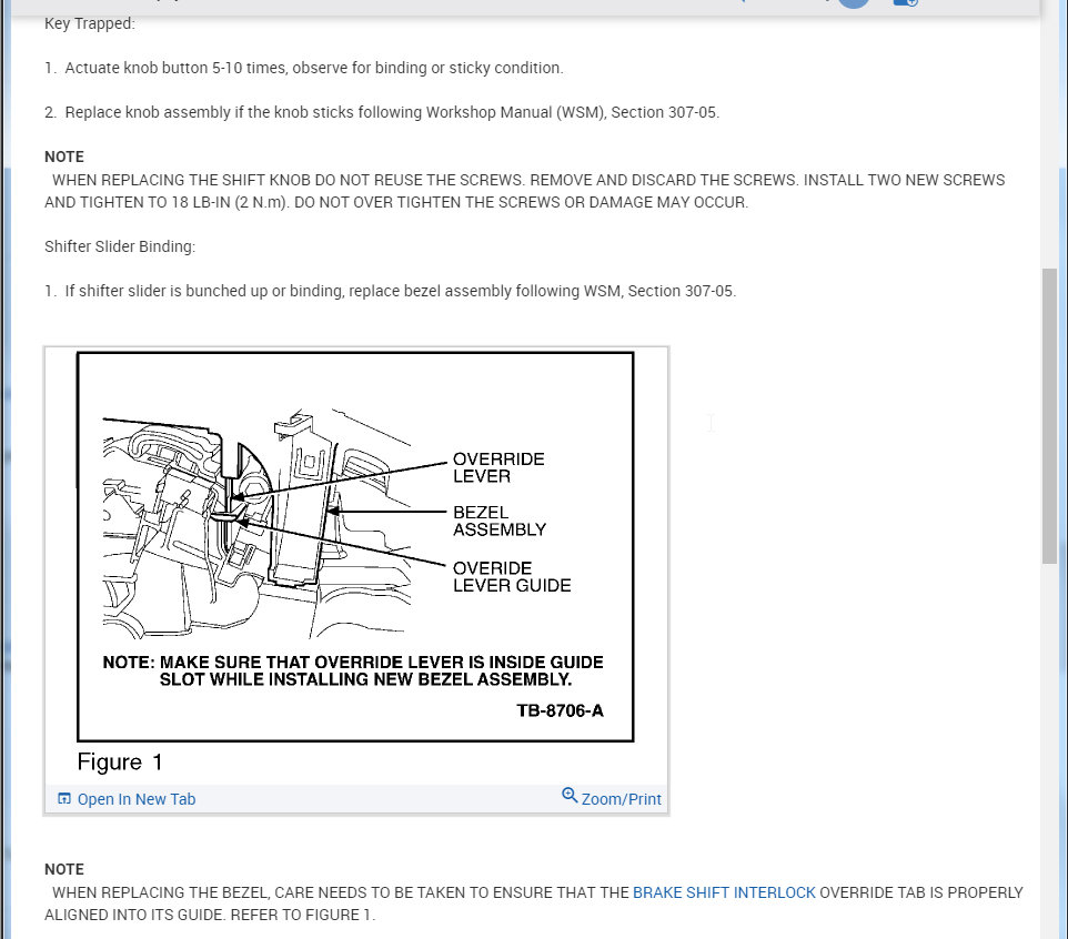

Take a look at this and let us know what questions you have. I included the testing and a TSB for this issue.
Sep 1, 2020 at 5:38 PM
GRAHAM1414
I can't thank you enough. I followed step one of the service procedure and the key released from the cylinder. I will be moving on to the next step and will let you know of my progress.
