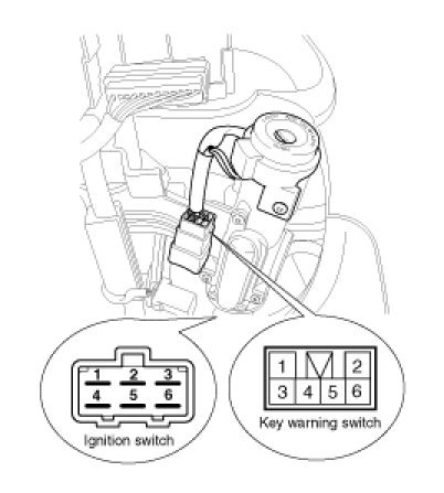

I installed a new ignition lock cylinder/switch and it started my car a few times within five minutes and did not work since on 8/24/18. It is not the starter because it starts from me sticking a knife in the starter relay. What is wrong? Is there something I did not do?

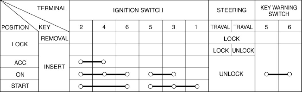

You replaced the key tumbler and not the actual ignition switch. The first thing to check is to make sure the connection at the switch itself is clean, tight, and not damaged.
Here are the directions for checking the switch itself if the connection is good. The first two pictures correlate with this test:
_________________________________
1. Disconnect the ignition switch connector and key warning switch connector from under the steering column.
2. Check for continuity between the terminals.
3. If continuity is not specified, replace the switch.
Let me know what you find.

I bought the hole the thing came with the new switch lock cylinder and switch I changed out the the lock cylinder and switch came with a new set of keys it started fine a few times then like it quit getting a signal had to go back to starting it from the starter relay it's between the switch and relay
Aug 26, 2018 at 3:47 AM
  • 110,244 POSTS
Chances are the new switch has failed. Did you get it from a dealer?
