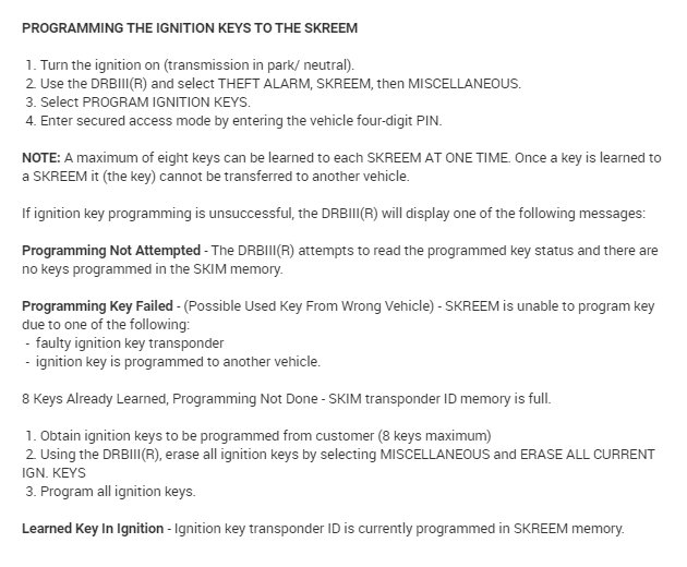

Is the theft light remaining on? When you replaced the ignition switch did you use the same key or get a new one with the kit? Also, what was the part number of the ignition cylinder that you got so that I can look up what was included? Important thing is to know if the theft light stays on and does the engine even crank? Thanks
I am wondering if we have security issue now but we need to start here and then take next steps. Thanks

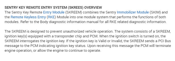

Okay. That is just the cylinder. Some kits include modules as well. If it is a new key, you need to have it programmed to the vehicle or it will not operate.
Unfortunately if you don't have a scan tool then you are going to have to have it towed to someone who does and they will need to program the key. You may be able to ask a dealer or shop to send someone out to the location of the van and have them do it there. However, you may want to find out if they would charge extra because it may be cheaper to tow it.

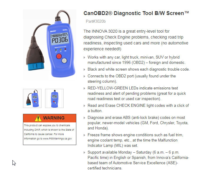

I have a innovation 3020b will that work?
Feb 14, 2020 at 11:50 AM
From what I can tell, it does not have an option to program keys. So unless I am not looking at the correct one, it will not work.
Basically you will know if it works when you plug it in and on the menu you have an option to program keys. Most generic tools like this cannot do it. Sorry.

Please tell us what we are missing. You drilled out the ignition cylinder and replaced it. Then used a new key and from what we can tell it was never programmed. Your theft light is flashing and the van won't start.
Based on the information you provided it looks like the key needs to be programmed and that can only be performed with a scan tool capable of performing that function.
