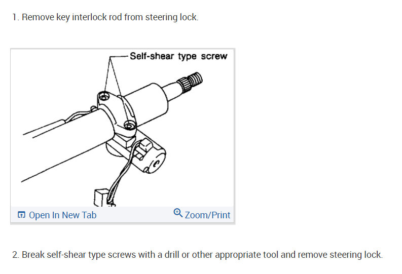

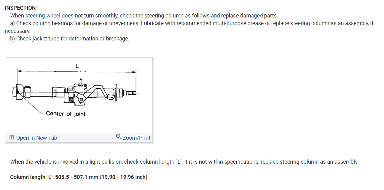

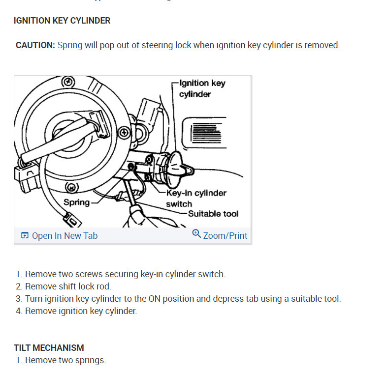

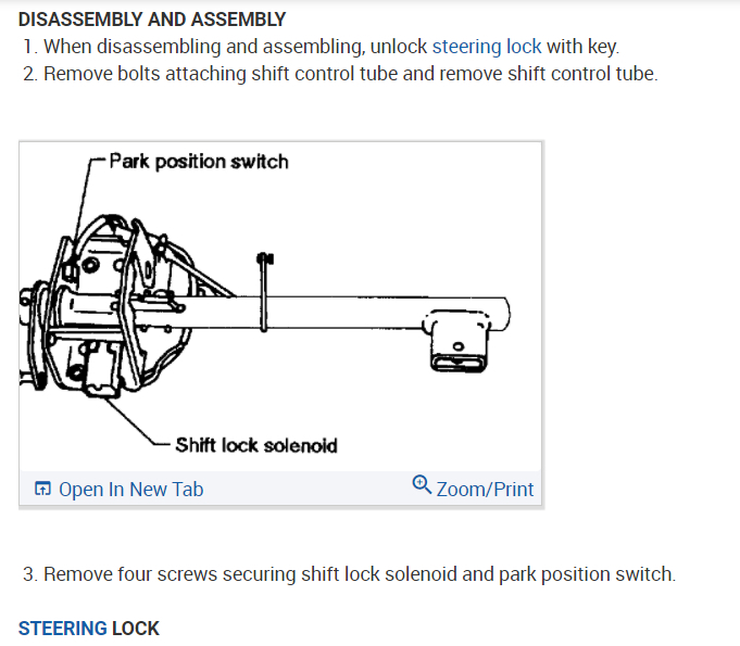

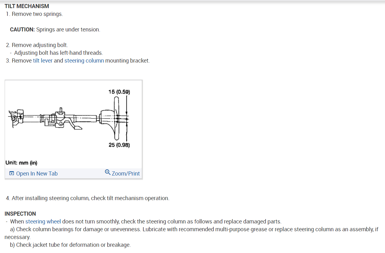

I overslept. I need to move my van out of the driveway right now. I guess because i parked on the main street someone tries to steal my car last night while i was slumbering and now i'm threatened by the company calling a tow truck. I found my ignition in pieces on the floor. The only left attached is. A board with six wires. Black white, black yellow, black green, white red, red ,and blue. is there a way I can hotwire it? I have no.funds until three more days and I got to move my van like now. Any help??
Apr 13, 2021 at 9:26 AM
  • 55,743 POSTS

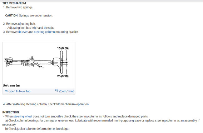

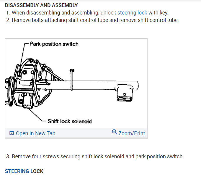

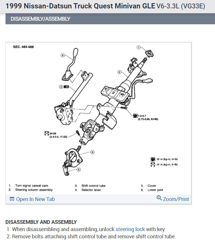

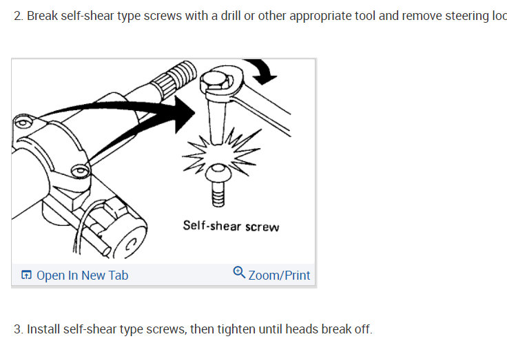

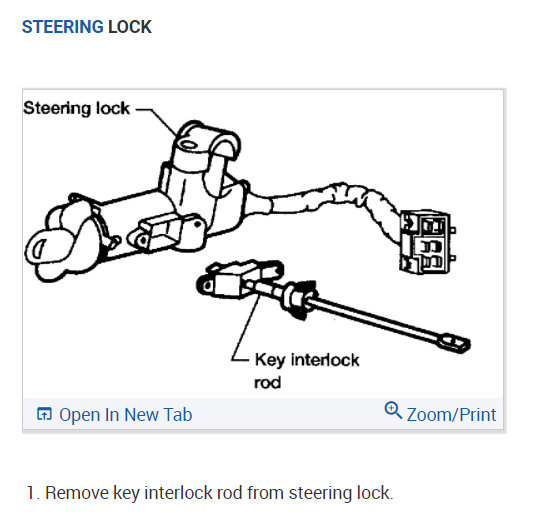

sorry for the late response. here is how to change out the old ignition lock for a new unit. you will need a sharp chisel to grab the edge of the shear bolts to loosen them, tap with a hammer. Check out the diagrams (below). Let us know what happens and please upload pictures or videos of the problem.
