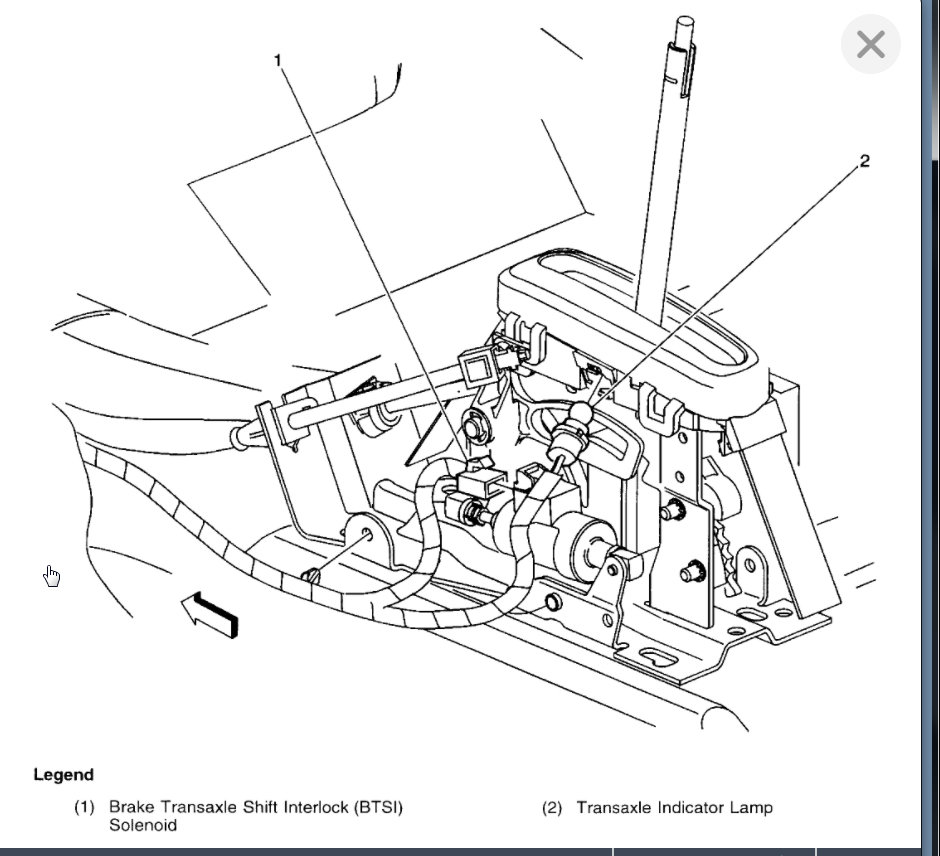

JOHN CASEY2
Didn't help my problem! 2000 Chevrolet Malibu, v/6. key stuck in ignition. won't go back to the off position. will run down the battery. Might be the park lock cable?

Let's get a new post started so that we can help on this specific vehicle. If others try to find the answer to your issue on your vehicle they will not find it under a Kia. I suspect you have an issue with the interlock solenoid pictured below. So let's get a new one started and we can figure this out. Thanks
