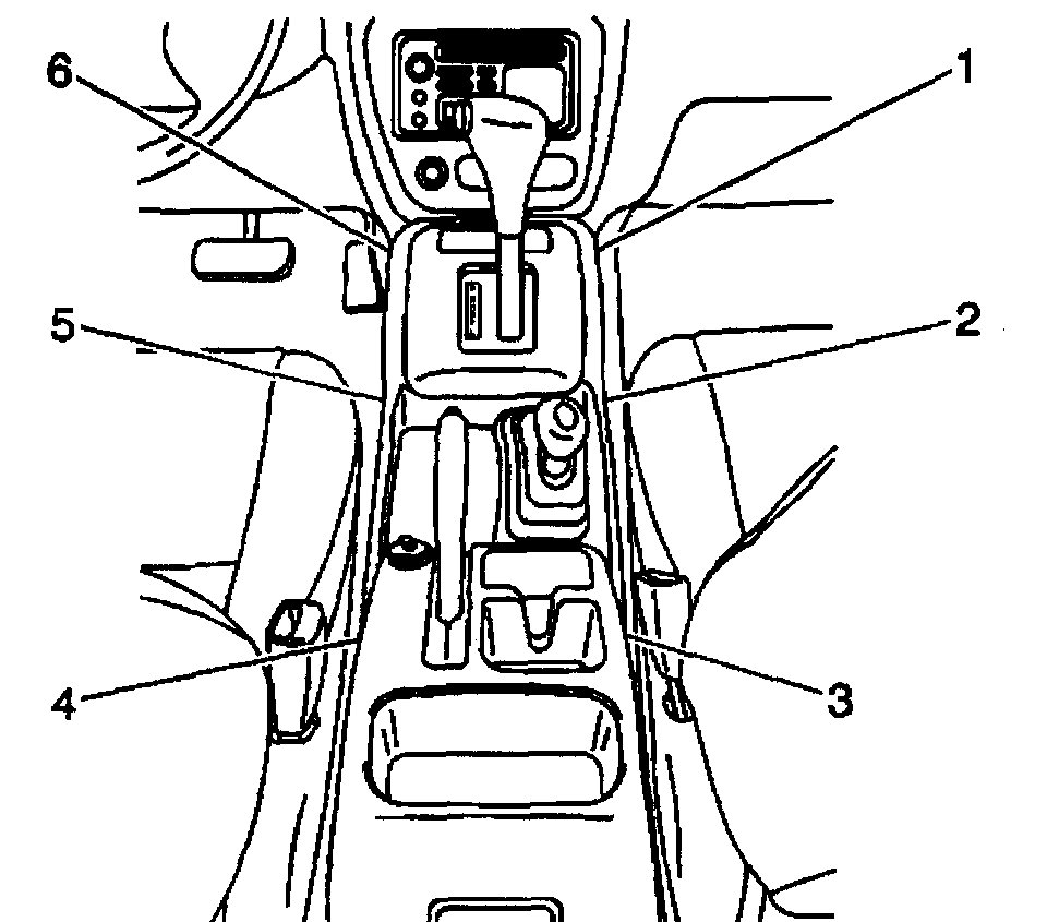

The cable that is attached to a lever on ignition framework that goes to shifting lever does not push lever into position to release key. Maybe cable has come loose from shifting handle in floor console. If so how do I access the cable at shifter in floor console?

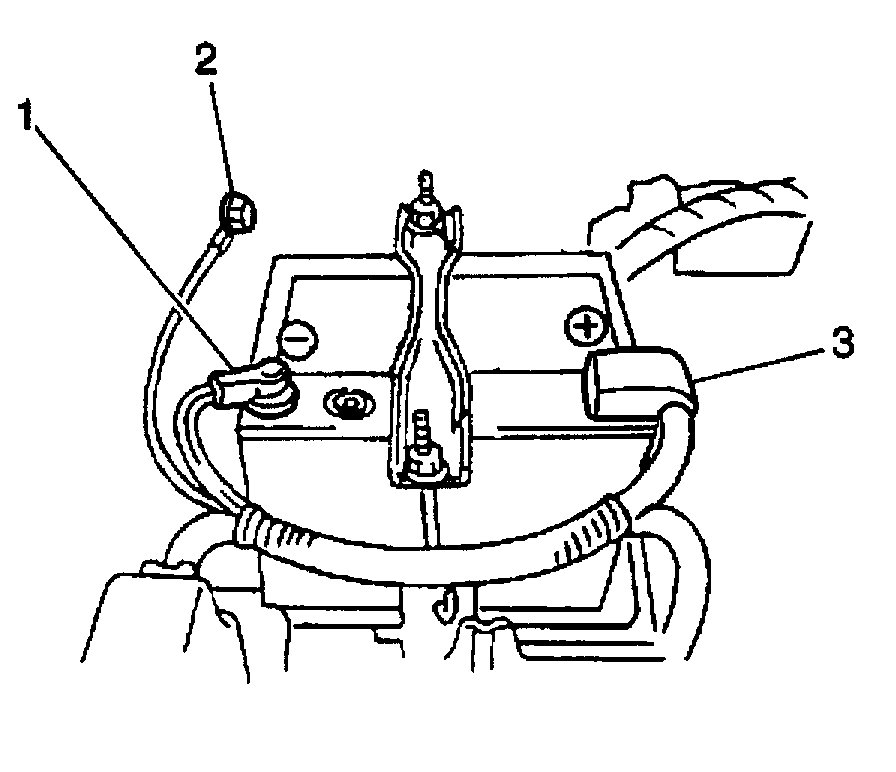

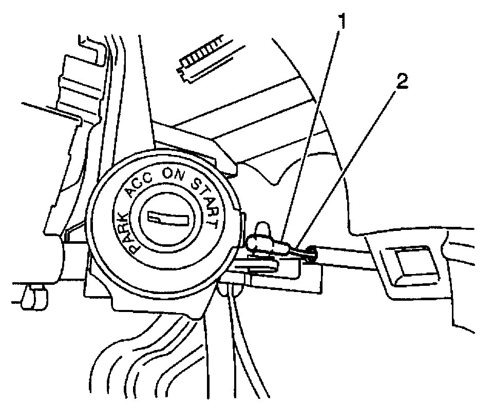

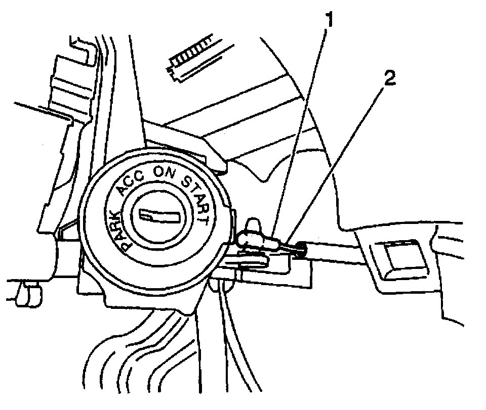

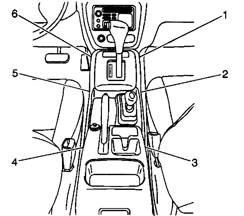

The cable may have broken or need adjusted. Here are the directions for accessing the cable. All attached pictures correlate with these directions.
_____________________________________
BRAKE TRANSMISSION INTERLOCK CABLE REPLACEMENT
Removal Procedure
Caution: Refer to Battery Disconnect Caution in Service Precautions.
1. Disconnect the negative battery cable (1).
2. Remove the following from the floor:
^ The 4 screws (1,6,3,4)
^ The 2 plastic retaining clips (2,5)
^ The console box

4. Remove the bracket retaining screw (2) from the ignition switch.
5. Remove the interlock cable (1) from the ignition switch.
6. Remove the interlock cable nut.
7. Remove the interlock cable at the manual selector.
8. Remove the interlock cable (1) out from under the instrument panel.
9. Remove the interlock cable from under the carpet.
10. Remove the interlock cable from the interlock cable bracket at the manual selector.

4. Install the interlock cable end to the ignition switch (1).
5. Secure the interlock cable end with the bracket retaining screw.
6. Adjust and tighten the screw in order to get the correct tension.

11. Install the console box to the floor.
12. Secure the console box with 2 plastic retaining clips (2,5) and 4 screws (1,6,3,4).
