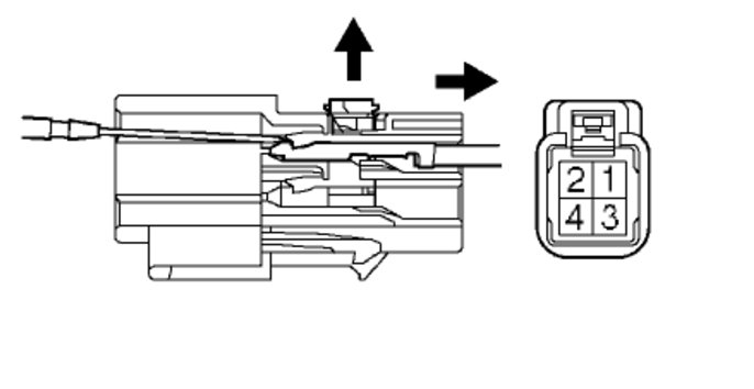

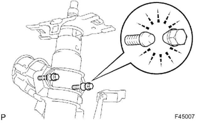

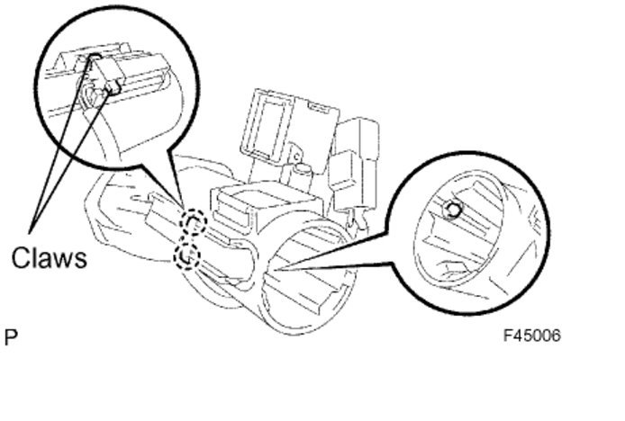

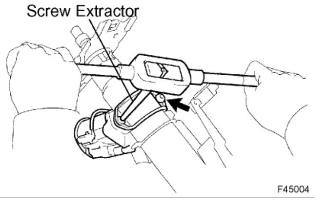

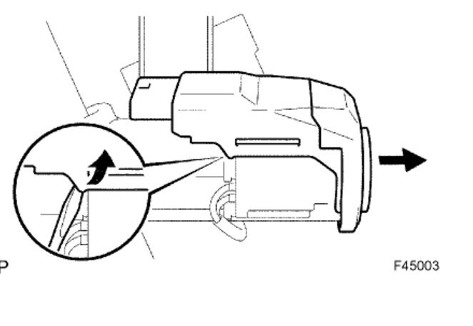

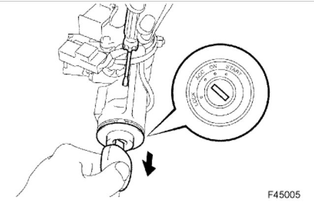

You have an ignition switch and tumbler that needs to be replaced. You can take the lock to a locksmith and they will make the key work once the unit has been removed. Here are some guides to help you get the job done.
