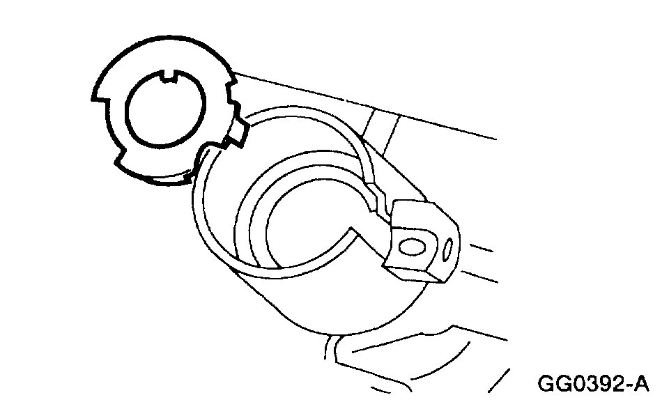

If you have a spare key, try it. I have seen the keys actually wear out and cause this. If it doesn't help and you are still unable to turn the key in the tumbler, the switch will need replaced.
If you find it does need replaced, here are the directions. The attached pictures correlate with the directions.

2. Remove the steering wheel.
Pic 1

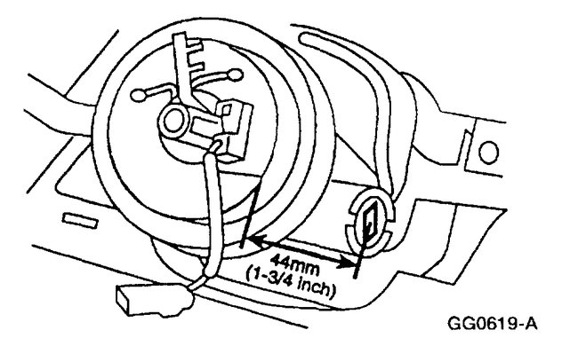

3. Twist off the cap from the ignition switch lock cylinder.
Pic 2

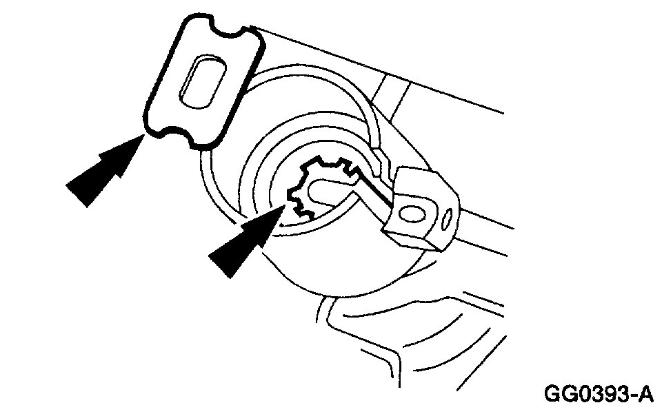

4. Remove the ignition switch lock cylinder.
Use a 1/8-inch diameter drill bit to drill out the lock cylinder retaining pin.
Use a 3/8-inch diameter drill to drill down the middle of the ignition lock key slot until the ignition switch lock cylinder breaks loose.
Remove and discard the ignition switch lock cylinder and drill shavings from the steering column.
Pic 3

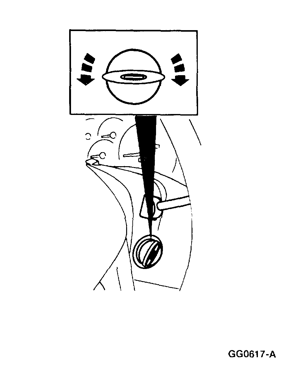

5. Remove the bearing retainer.
Pic 4
6. Remove the bearing and the gear.
Thoroughly clean all drill shavings from the steering column and inspect it for damage.

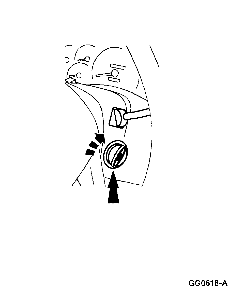

Installation
The side air bag sensors are located at or near the base of the B-pillar.
To deplete the backup power supply energy, disconnect the battery ground cable and wait at least one minute. Be sure to disconnect auxiliary batteries and power supplies (if equipped).
Pic 5
1. NOTE: Use a new ignition switch lock cylinder.
Follow the removal procedure in reverse order.
Verify ignition switch lock cylinder operation.
