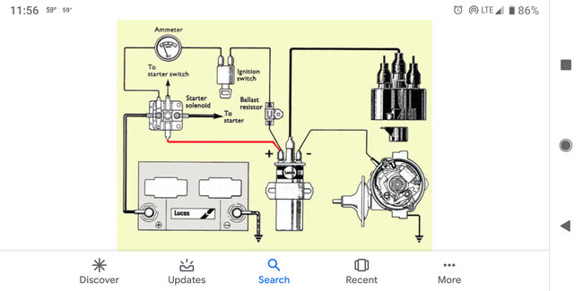

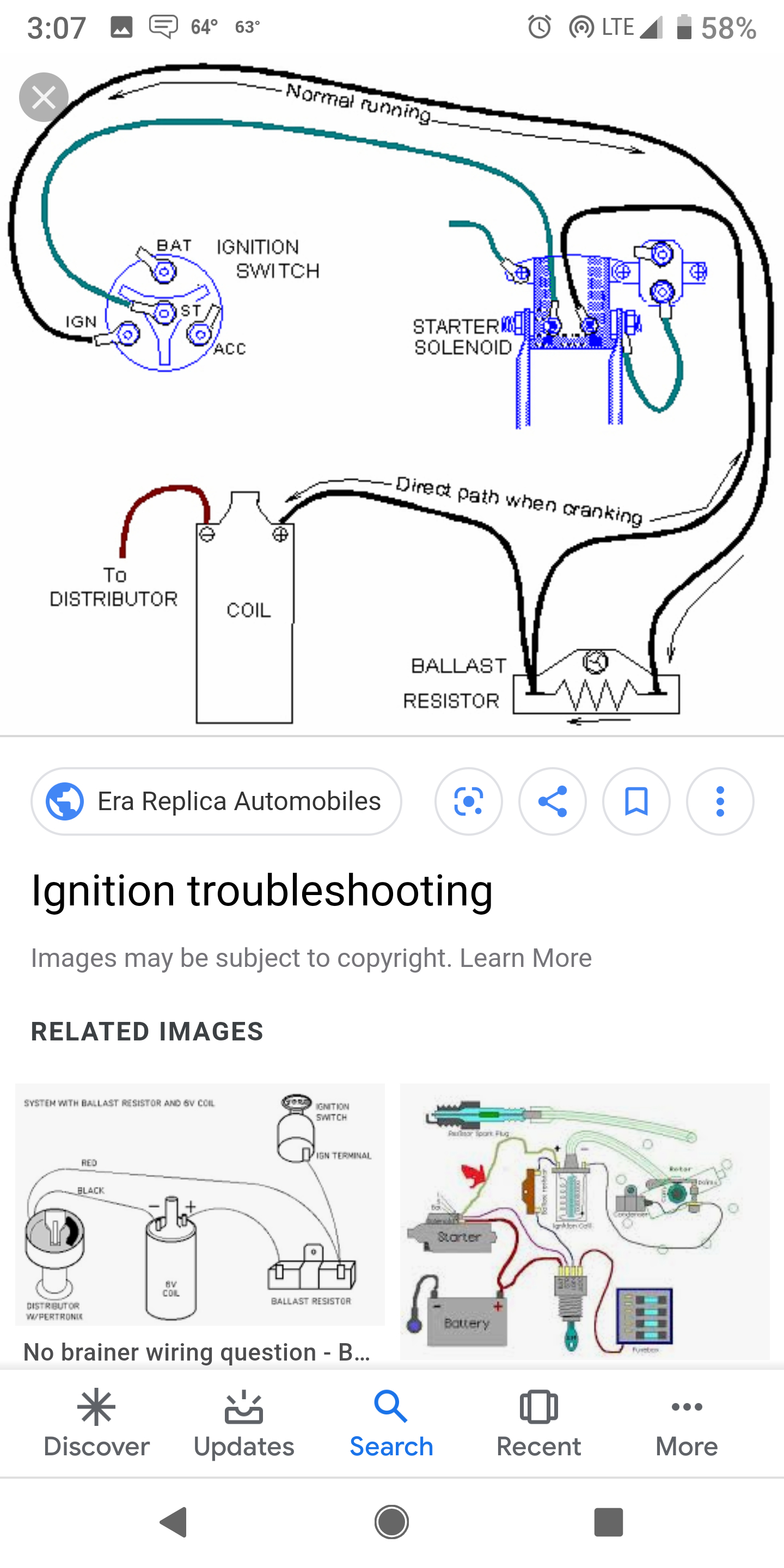

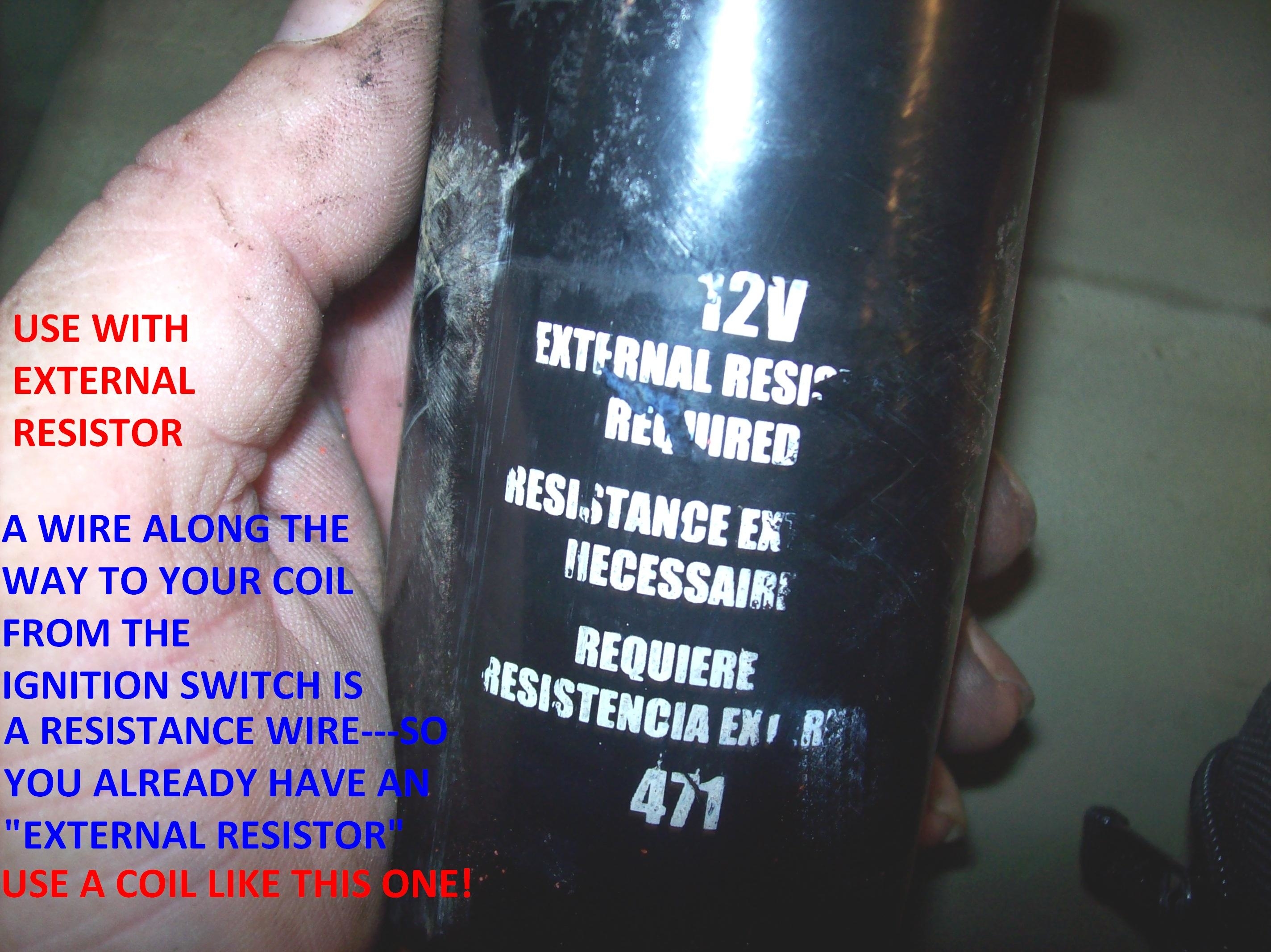

I was hoping to find (CJ medavac) on here. I read a thread that was posted in 2017 about the same issue and I found the information very helpful, but had a question on what is a resistance wire and dose someone sell them or do you just make one? this Is the pic that was drawn in that old thread. Thanks

The way it goes is:
'76-'78 had Prestolite ignition. There was no resistance wire.
'79-'86 had Motorcraft ignition. They had a resistance wire from the factory (unless someone removed it)
Those last few years of the '80s saw the CJs with a computer a few sensors and a special "stepper" carburetor to which all of that stuff was supposed to make things all better.
Usually a nutter bypass and dropping back to a '79 carburetor fixed the problems those yeas had.
Back to a "resistance wire"
If you are upgrading (100%)from below the year 1979 to the Motorcraft System (introduced in 1979 for CJs) You will need "Resistance" so the coil will work properly.
The easiest thing to do is install a ballast resistor where the resistance wire would normally have been. (See 1st pic)
If you do upgrade I suggest you do it all to be like a '79, if you ever need an ignition part, if you have a '77 (like mine) or other years. You simply ask for 1979 ignition parts. This cuts down on confusion!

A coil (for external resistor) (a correct 1979 coil will be right) A connector for it.

And of course a ballast resistor to imitate the non-existent resistance wire that is not present on the pre-79 CJs .

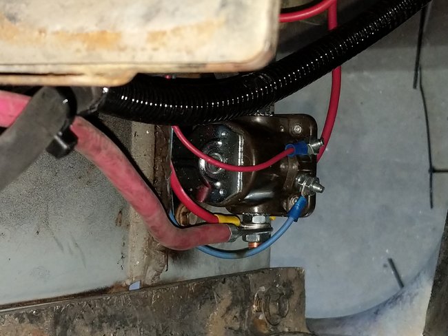

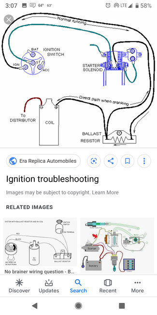

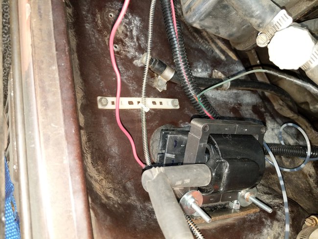

Having wiring confusion on what wire from what location goes to the (ballast resister)the picture you sent me the way I read it is spliced the ballast resistor in to the circled location. But other pictures below show a different wiring set up. The picture you sent is the set up in my Jeep, currently. also the purple writing on your picture says their should be reduced voltage then the key is on, I have 12 v from the starter solenoid to the coil so I would think that is we're you would put the ballast resistor? That is why I had to replace the coil because I had the key on testing dash wires and the coil started melting. I have been reading your other posts to see if you already have answered this question but not sure if I have dug deep enough I will add some pictures of my location of parts to help.

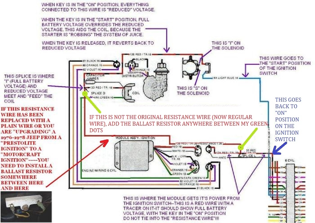

The original resistance wire came off of a wire from the ignition switch.
If it is missing (not ran as shown in my 1979 diagram), You will need a ballast resistor to take it's place.
Trying to explain this simple, look at the splice (sort of "tee" configured) at the positive side of the coil.
One side of the "tee" goes to the coil, another side goes to the "I" terminal of the starter solenoid.
The last leg of the "tee" is the power from originating at the ignition switch. This is the wire that the ballast resistor will hook into. I guess it would be best nearer the coil and away from the congestion further down the line. See my pic below.

Notice in the diagram below (1979 peak of the CJs in my opinion) Every thing was simple, "nuttering" was unheard of, as there was no substandard computer crap added in that year.
So, basically everybody is trying to duplicate '79-'81s ignition systems since they work so well.

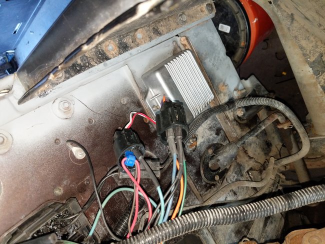

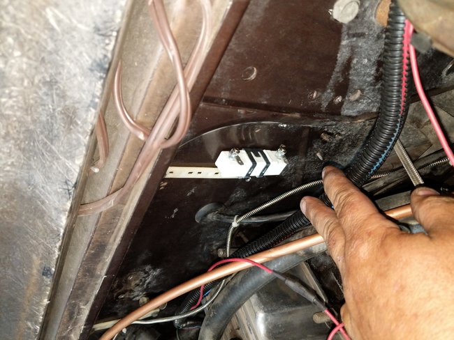

So I was looking at your "picture 3". You did not splice in the mating connector halves to your ignition module, looks like female stake-ons are used in their place. This may work, but they might work loose too!
That above was really no big concern, I was wondering why you had an extra wire on the "4 wire" set, and an extra wire on the "2 wire" set at the module? Notice where the module wires go in my diagram.

The #3 picture is because the OEM ICM needed replaced pre owner hacked into it and the connectors were corroded and cracked.i just haven't figured out how to secure the female connectors just yet. the 5th wire is a ground to the firewall I just put it back like it was didn't know if it was needed or not, the two wire set up same scenario the brown wire from the alternator was tapped into the hot the red loop in there is tap in from the hot out of firewall to ICM then ran to coil positive out to I terminal on starter solenoid.

Maybe this or similar sites would have the correct fittings. (I searched "Duraspark connectors")
https://www.amazon.com/Harness-Connector-Electronic-Ignition-Module/dp/B07CX3XXSV
When I upgraded from Prestolite to Motorcraft in my 1977, I found all of the wire and connectors I needed in a self serve auto salvage yard, looking through different Ford vehicles.
