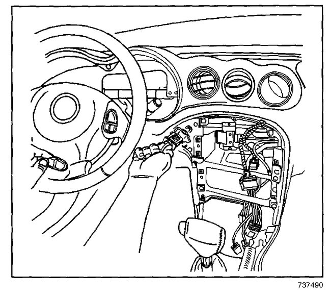

I am unable to turn the key in my ignition. it's fairly new just replaced a couple months ago. I can turn my steering wheel it wont lock. Have tried to fix it from taking the steering wheel apart to wiggling the steering wheel and turning the tires to tapping on the ignition to checking fuses but am still unable to get the key to turn in the ignition. What can be the problem?

If you can't turn it at all, first, try a spare key. If that doesn't work, then the key tumbler needs removed to see if something has broken or the tumbler has just failed.
Here are directions for removal. Please keep in mind, a new unit will need programmed to in order for the anti theft system to recognize it.
_________________________________________
2002 Pontiac Grand AM L4-2.2L VIN F
Ignition Switch Lock Cylinder - Dash Mounted
Vehicle Starting and Charging Sensors and Switches - Starting and Charging Ignition Switch Ignition Switch Lock Cylinder Service and Repair Removal and Replacement Ignition Switch Lock Cylinder - Dash Mounted
IGNITION SWITCH LOCK CYLINDER - DASH MOUNTED
REMOVAL PROCEDURE
IMPORTANT: Perform the BCM theft deterrent relearn procedure whenever you replace the ignition switch lock cylinder. For more information refer to Accessories and Optional Equipment/Antitheft and Alarm Systems/Service and Repair/ See: Antitheft and Alarm Systems > Procedures
pic 1
1. Disconnect negative battery cable.
2. Remove Instrument Panel (IP) accessory trim plate.
3. Insert the key and turn the ignition switch lock cylinder to the ON position.
4. If the cylinder does not rotate or is seized, follow the procedure in the ignition switch replacement.

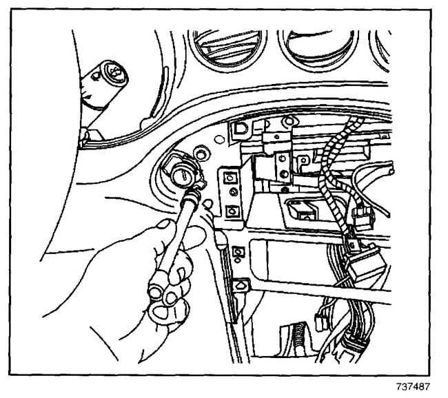

5. Using a small curved tool, depress and hold the retaining tab on the ignition switch lock cylinder.
6. Using the key as an aid, pull to remove the lock cylinder from the switch.
7. Remove the key from the lock cylinder.

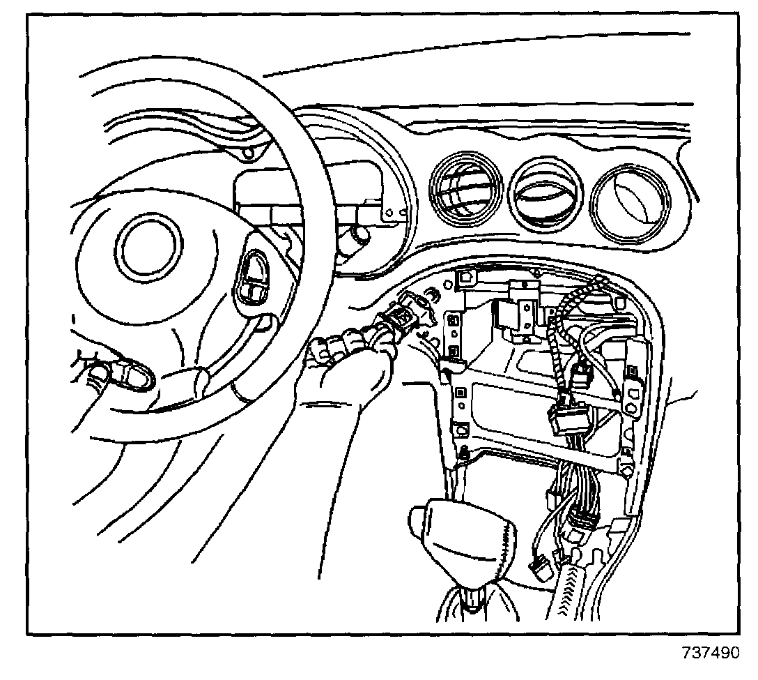

INSTALLATION PROCEDURE
pic 2
1. Code the ignition switch lock cylinder, if necessary. Refer to Key and Lock Cylinder Coding
2. Insert the key and turn the lock cylinder to the ON position.
3. Align the lock cylinder to the ignition switch, then press the cylinder into place.
4. Turn the key to the OFF position and remove the key.
5. Install the IP accessory trim plate.
6. Connect the negative battery cable.
7. If a new lock cylinder was installed, perform the BCM theft deterrent relearn procedure. Accessories and Optional Equipment/Antitheft and Alarm Systems/Service and Repair/ See: Antitheft and Alarm Systems > Procedures

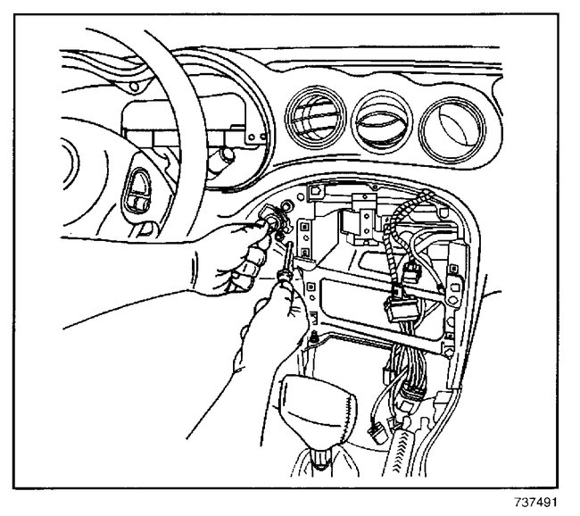

Since your lock is stuck and can't be turned, you may need to follow these directions.
Ignition Switch - Dash Mounted
Vehicle Starting and Charging Sensors and Switches - Starting and Charging Ignition Switch Service and Repair Removal and Replacement Ignition Switch - Dash Mounted
IGNITION SWITCH - DASH MOUNTED
IGNITION SWITCH REPLACEMENT
REMOVAL PROCEDURE
pic 3

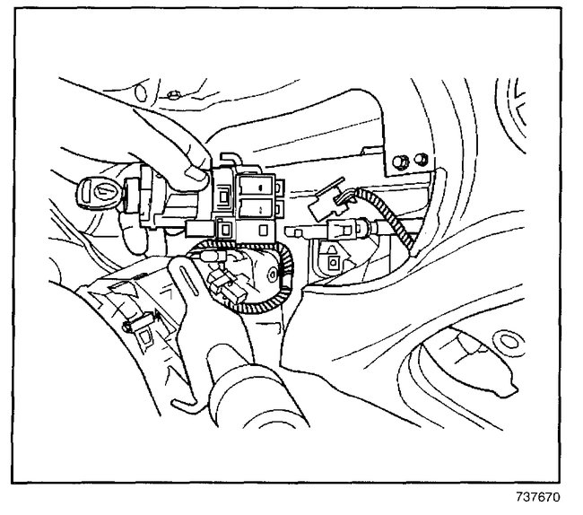

1. Disconnect the negative battery cable.
2. Remove the instrument panel (I/P) accessory trim plate.
3. Remove the I/P cluster.
4. Remove the bolts from ignition switch.

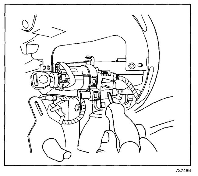

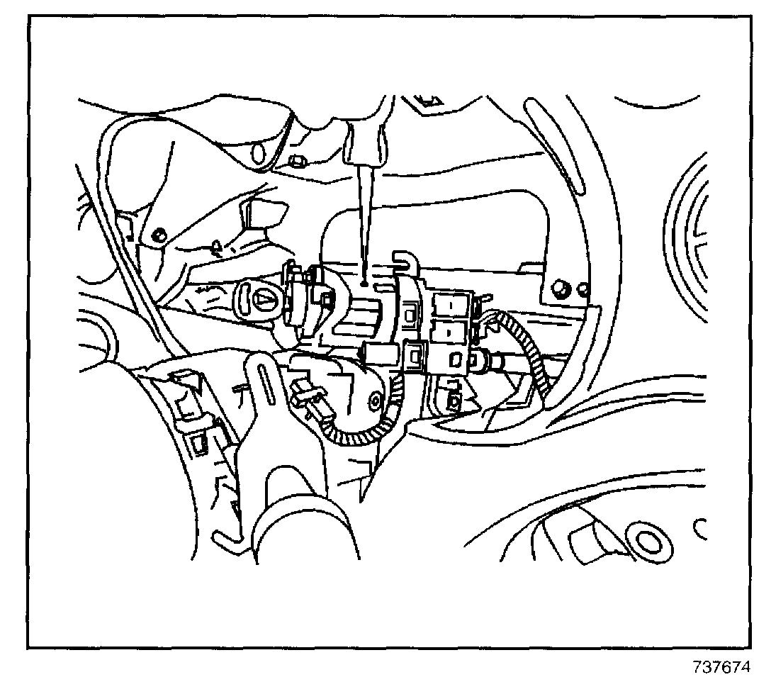

pic 4
5. Reposition the ignition switch for ease of removal.
6. Insert the key and turn the ignition switch lock cylinder to the ON position.
pic 5

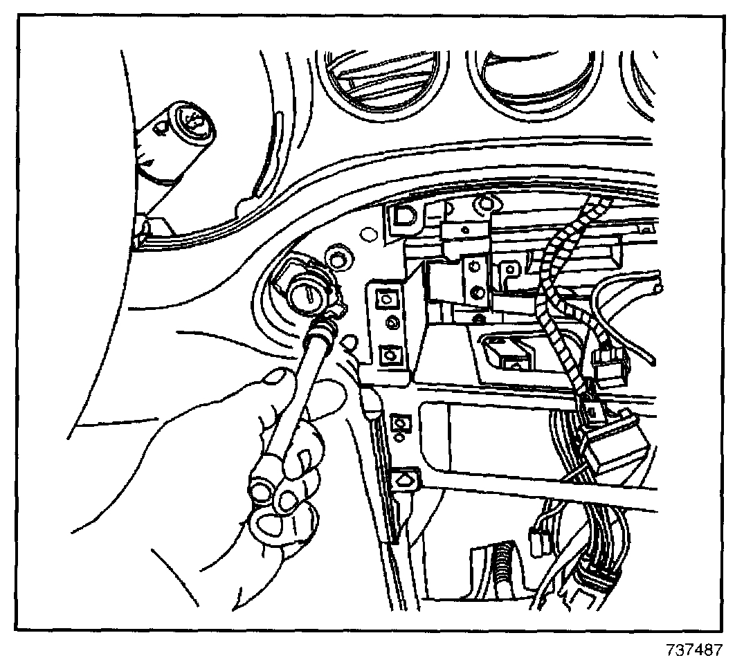

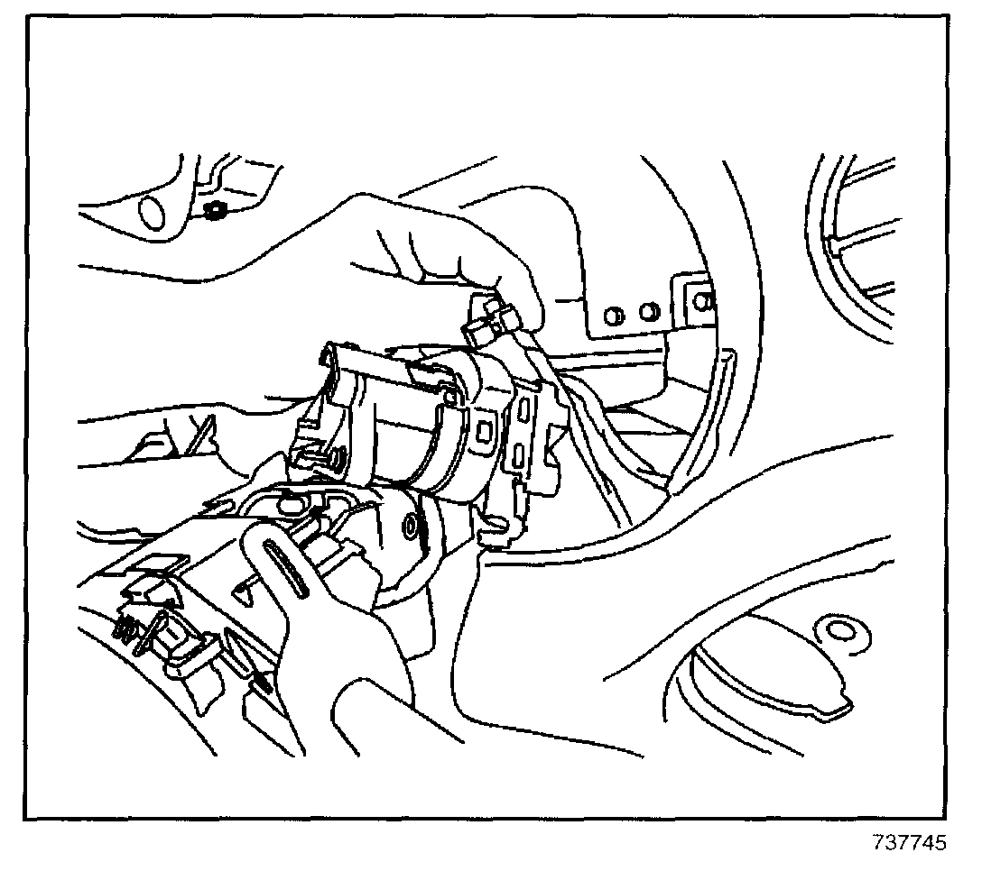

7. If the lock cylinder does not rotate or is seized, perform the following procedure:
7.1. Protect the immediate work area with suitable material such as clean shop towels or a clean fender cover.

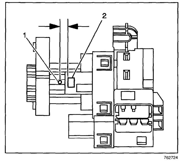

7.2. Locate the surface for the ignition switch lock cylinder release button (2) on the plastic ignition switch housing and center punch a location (1) on the rib 9.5 mm (3/8 in) rearward, toward the key entry end, from the cylinder release button.
7.3. Carefully drill a pilot hole through the plastic housing with an 1/8-inch drill bit.
7.4. Carefully drill a larger hole at the pilot location, and slightly into the ignition switch lock cylinder surface to break the release button retaining spring using a 9/32-inch drill bit.
7.5. Remove portions of the broken spring from the hole using a small suitable tool.
7.6. Grasp the ignition switch lock cylinder and remove the cylinder from the switch housing.
7.7. Remove any plastic flashing from the drilling operation, and using compressed air blow out the ignition switch assembly.
7.8. Follow the procedures when cylinder coding is required. Refer to key and Lock Cylinder Coding

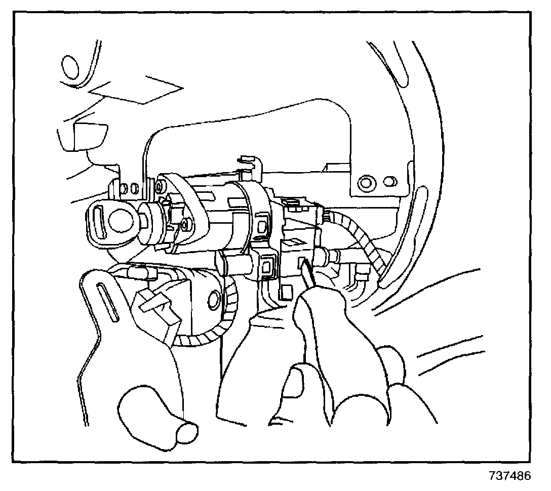

pic 6
8. Depress the transaxle park/lock cable retainer to release, then pull to remove the park/lock cable from the ignition switch.
9. Remove the ignition switch lock cylinder from the ignition switch, by depressing the retaining tab and pulling the cylinder out with the key.
