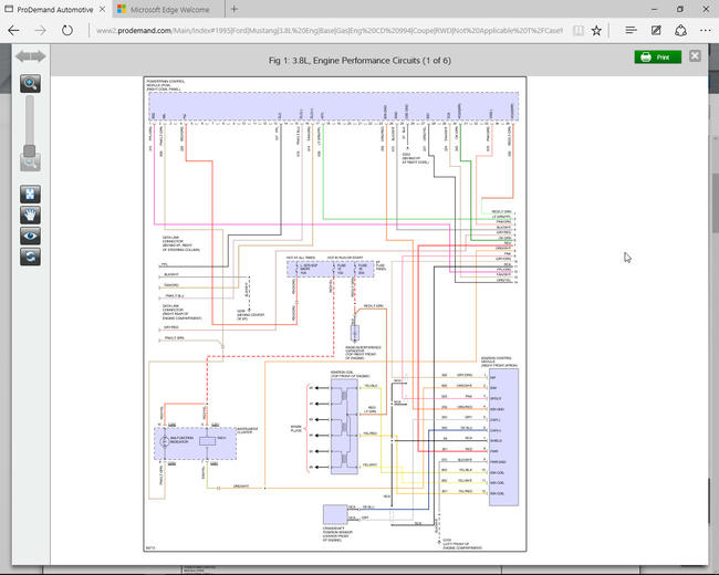

I need help i put some new intake gaskets on 1995 ford mugstang and when i completed the job the car will not startup. I have work on cars for a long time i have not had this problem. So i started checking for gas yes i got gas i check crank sensor 0.5 i got that i check for spark no spark. I check the wires to the coil and this one has 3 wires to it a black ,red, and a blue one. The blue is lighting up i the number 10 pin wire on the icm edison no fire to pink number 10 icm. When i turn the key on the black wire gets hot blow the ecm fuse. I was told to follow the wire to the battery & ignition but some wire running along side the bumpers what to do please help.

Sounds like you pinched the wires when you did the head gasket. Find and fix the short.

I did that i was thinking the same but under the hood there are no pinched wires i will like to know how to find why the blue on coil is not getting fire.

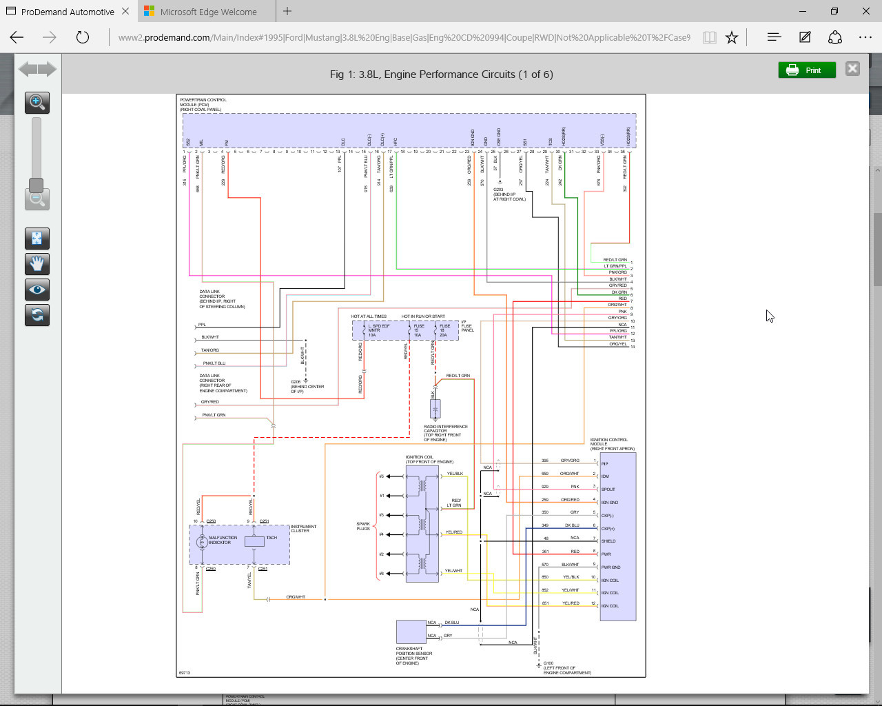

Here is the wiring diagram for that circuit.
