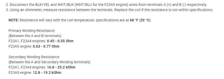

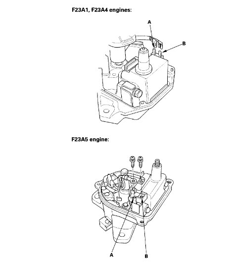

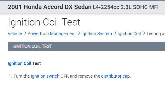

What is the code you are getting? Also, if you have replaced the distributor and coil, there must be a wiring issue to the distributor assembly. When you replaced the distributor three times, was the coil included?
Let me know the code. Also, I attached diagnostics below specific to checking the ignition coil. Take a look through them and let me know if you are comfortable performing them. Also, if you have the code, I can check to see if there is anything specific that should be checked.

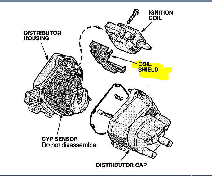

I realize the distributor was changed. Could you check to make sure the coil shield is properly in place? Also, did the new distributors include a new CYP sensor?
Let me know. Also, let me know if that is the only code you get.
See pic below.
