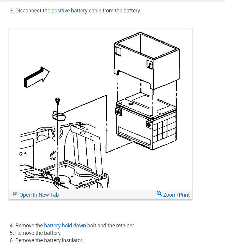

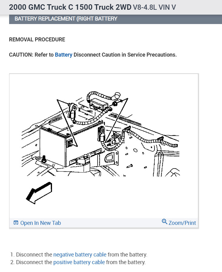

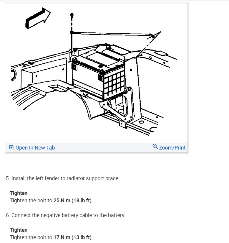

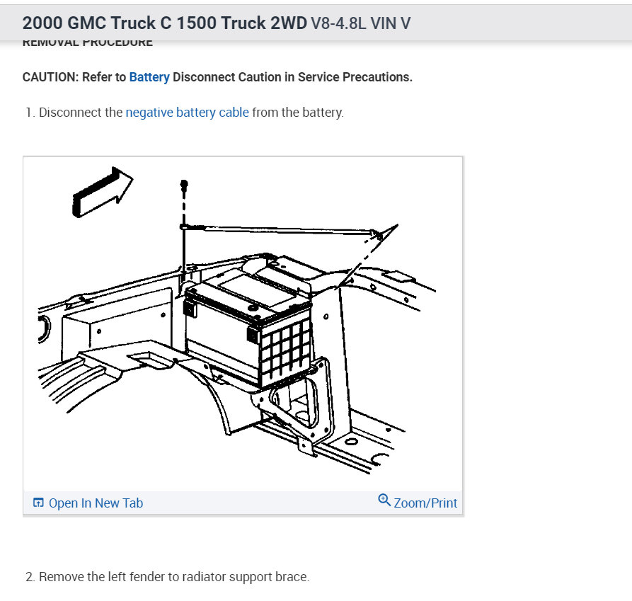

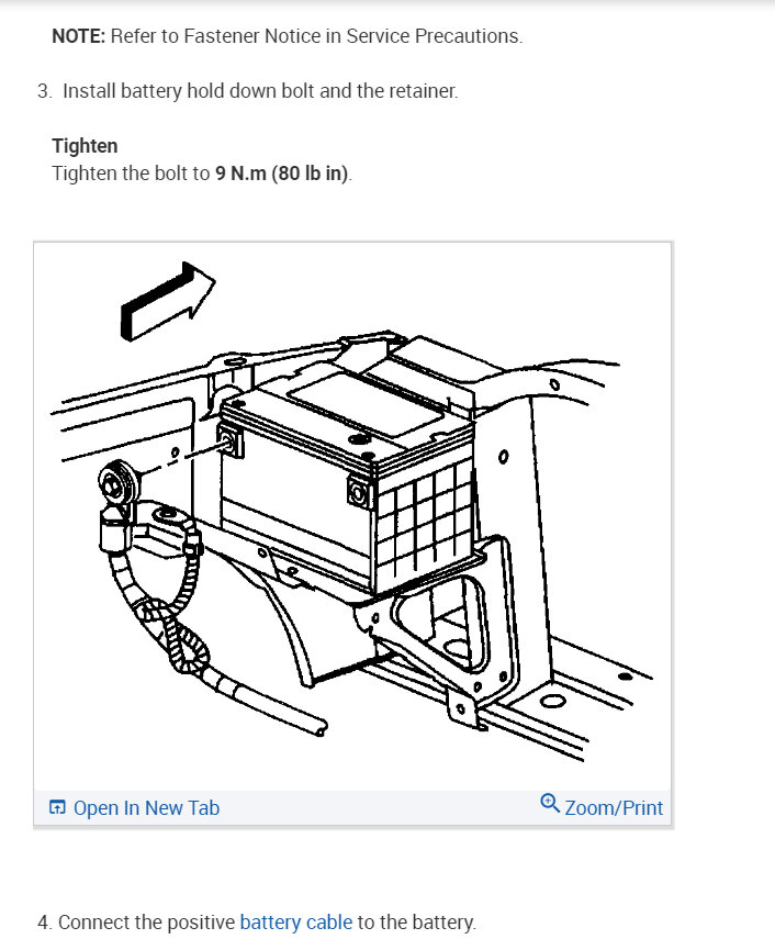

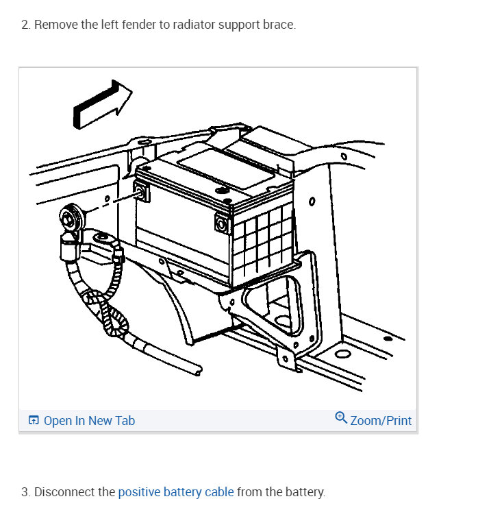

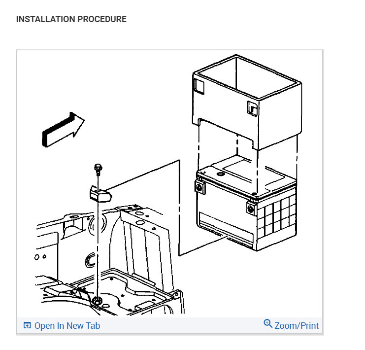

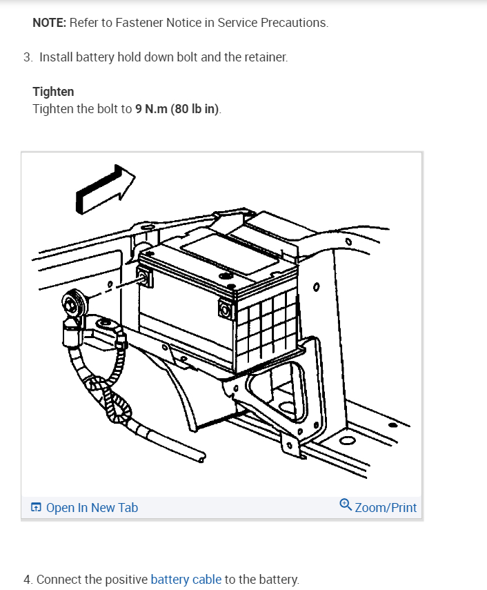

This can happen when the battery voltage is too low.
Here is a guide to help you test the battery without equipment:
If so, the battery fails, this guide can help walk you through the repair with instructions below for your truck:
https://www.2carpros.com/articles/how-to-replace-a-car-battery
