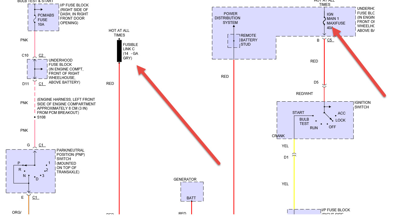

I have no warning lights or ignition when I turn my key. I have checked all relays, fuses, and I have power. I also have a remote starter, which I read can cause issues. But I do not know what to look for.

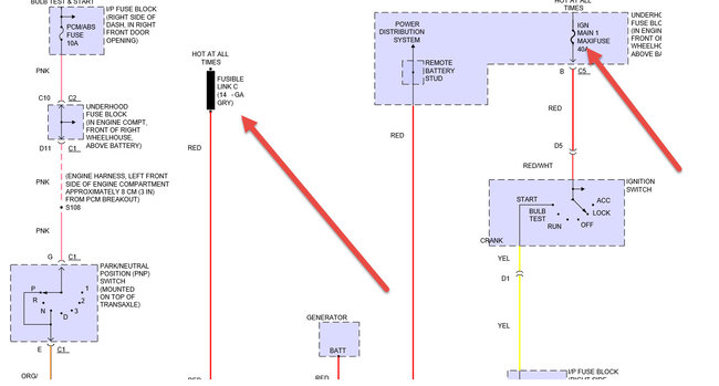

check items in picture. the fusible link is connected to starter. check both sides for power they are available at auto parts.
